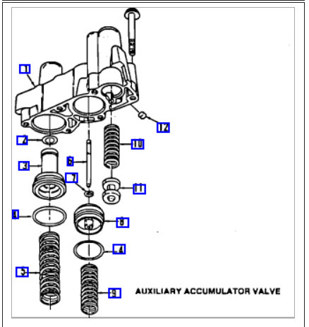

This happens when the accumulator tension spring breaks not slowing the shift plunger down. Here is what the book says, if you want to see what it looks like there is a image below. SENSORS & SWITCHES The PCM/TCM controls upshifts and downshifts based on coolant temperature, transmission temperature, system voltage, throttle position, transmission oil pressure switches, and transmission output and input speed sensors. I would check for any fault codes stored it may be an electrical fault. Shift Solenoids "A" & "B" Transmission is shifted up or down by 2 electric solenoids. Both solenoids are located on valve body. See Fig. 1. Ignition power is supplied to each solenoid by the transmission fuse. Solenoid "A" controls hydraulic pressure to 1-2 and 3-4 shift valves. Solenoid "B" controls hydraulic pressure to 2-3 shift valve. Force Motor Force motor solenoid has a spool valve and operates pressure regulator valve. See Fig. 1. The computer sends a frequency signal to the force motor to regulate hydraulic line pressure. The frequency signal (duty cycle) is measured with a dwell meter or lab scope. When the duty cycle is zero, line pressure is at maximum, and force motor draws zero amp. When the duty cycle is 40%, line pressure is at minimum, and force motor draws 1.1 amps at 4-5 volts. TCC Solenoid This solenoid is used to control TCC apply valve. The computer sends a frequency signal to the TCC solenoid to gradually apply or release the TCC. See Fig. 1. Fig. 1: Locating Transmission Solenoids, Sensors & Switches
