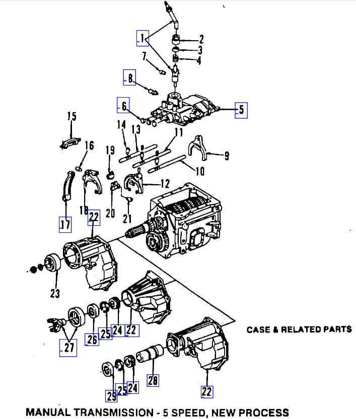

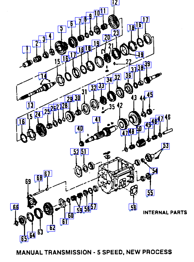

A countershaft bearing can cause this issue which is not used in some gears, here is an exploded view of the transmission so you can see what I am talking about. Check out the images (below). Let us know what you find.
