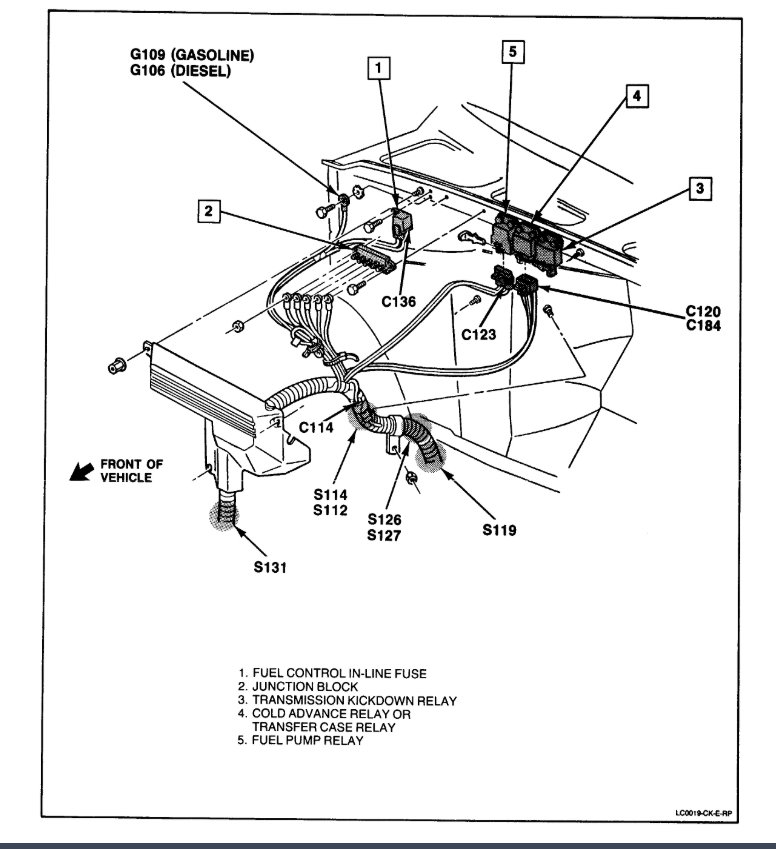

A"new fuel pump" was supposedly put in a few months ago.Truck died and not getting any gas to the throttle body.Checked the fuel pump fuse under the hood and it was good but when I checked to see if it was recieving any current it wasn't.I jumped the fuse from the battery but still no gas.I cannot hear the relay kicking in either.Question is does power go to the fuse first or the relay first?The relay does have power going in but I can't seem to find the power going out.Also where does the power come from to the fuse?
Apr 2, 2008 at 2:55 PM
RASMATAZ
  • 75,992 POSTS
Power to the fuse comes from the relay and while engine is running with the correct oil pressure it comes from the oil pressure switch. Here is a wiring diagram and the relay test guide and location below. https://www.2carpros.com/articles/how-to-check-an-electrical-relay-and-wiring-control-circuit
https://www.2carpros.com/forum/automotive_pictures/12900_oil_sending_unit_and_fuel_pump_circuit_41.gif
Check out the diagrams (Below). Please let us know what happens.

I do not have 12 v going to fuel pump. I changed the fuel pump relay and checked fuse under hood. Where does it go from there
Aug 27, 2019 at 1:10 PM (Merged)
RASMATAZ
  • 75,992 POSTS
Check the inline fuse 20amp
JERRYK66
where is the fuse at?
