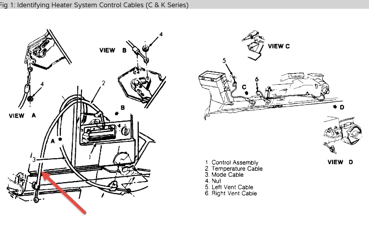

My heat is only blowing cold, does not matter the setting. I replaced the thermostat (works), I flushed the heater core, topped fluid and removed any air in the system. I pulled the actuator which does work off and manually moved the arms for the vents and still it just blows cold. So the heater core in feed and out are both hot, thermostat works, actuator is working and the fluid is topped with no air leaks, but still no heat. What do I do next?
Nov 22, 2017 at 6:51 PM (Merged)
HMAC300
  • 48,601 POSTS
check for a broken heater cable which controls the heat. it can be broken or the lever is broken/door etc. See picture.

I just did thermostat and heater core and i am getting luke warm heat what could be going on here? Blend door is opening and closing as it should i checked that when i did heater core. I cant figire out what to check or do next.
Nov 12, 2018 at 4:35 PM (Merged)
HMAC300
  • 48,601 POSTS
see if both heater hoses are hot they may not be. if they are both hot check for a broken cable for temp also check for a water valve on engine, been a long time for me I forgot if they have them. then have radiator cap pressure checked it may be part of cause not letting engine build up pressure.
