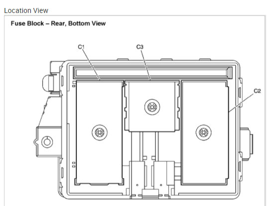

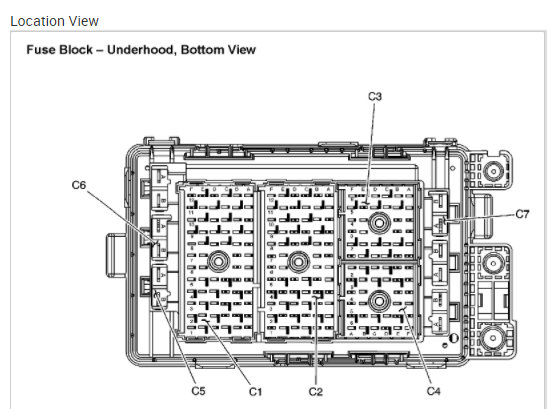

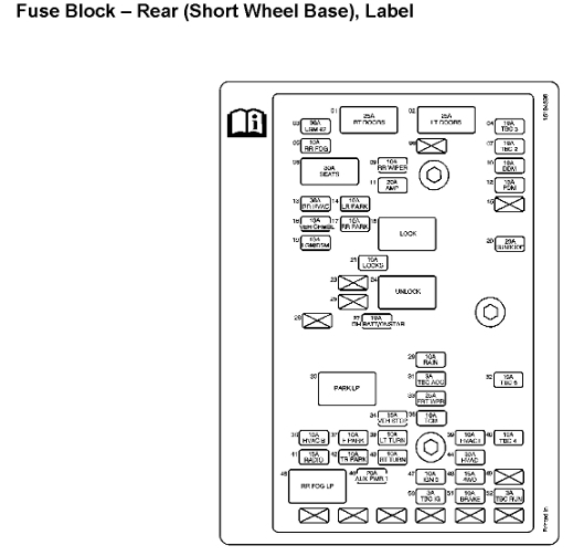

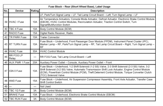

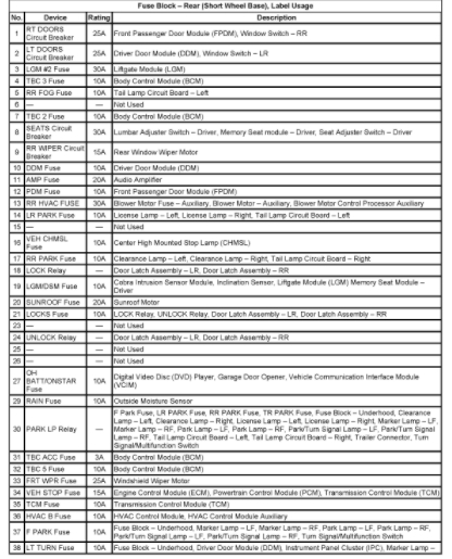

Can you tell me where the fuses are and what they go too?
2005 CHEVROLET TRAILBLAZER
PJJ676
My wipers will not cut off. I have check the fuses.
Mar 14, 2010 at 5:18 PM
DANNY L
  • 5,648 POSTS
Hello, I'm Danny.

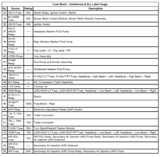

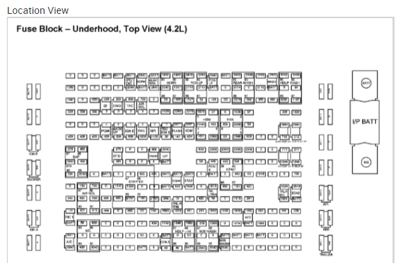

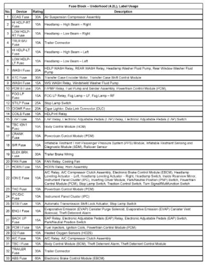

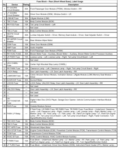

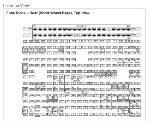

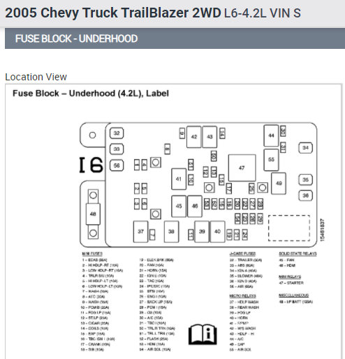

Here is the information you requested. Here are a few tutorials for you to view on how to test and change fuses:
https://www.2carpros.com/articles/how-a-car-fuse-works
I've attached diagrams below of the fuse locations on your vehicle. Hope this helps and thanks for using 2CarPros.
