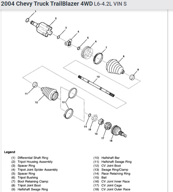

how do you replace the half shaft on this type of vehicle?

Here is a helpful article for cv axle (halfshaft) replacement:
https://www.2carpros.com/articles/replace-cv-axle
Refer to this replacement video:
https://youtu.be/RFXsXMRBRhg
Let me know if you have any questions.
