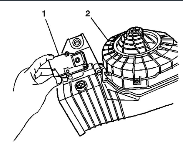

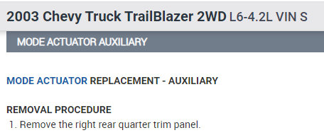

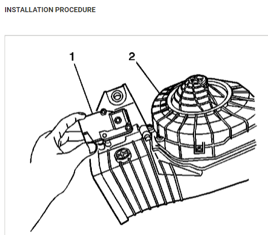

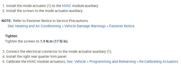

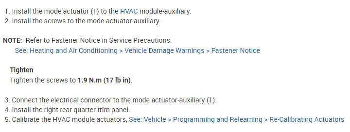

Here is the information you requested. It sounds like you might have a defective or failing auxiliary mode actuator. That is a small electric motor that opens and closes a flap to direct air through certain air ducts. Here is a tutorial showing how to replace a blend door actuator which is similar:

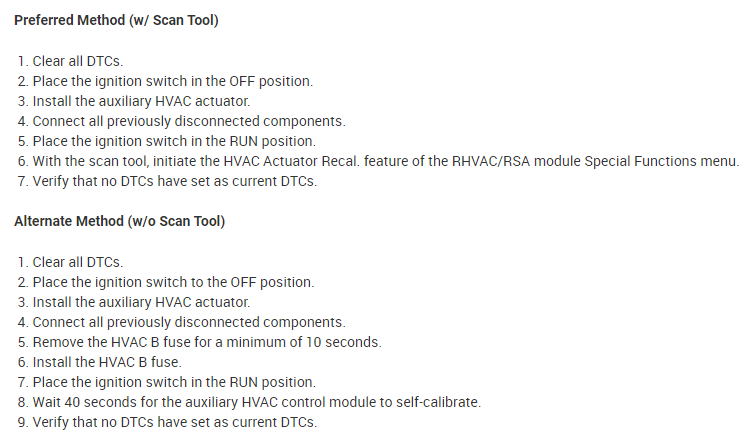

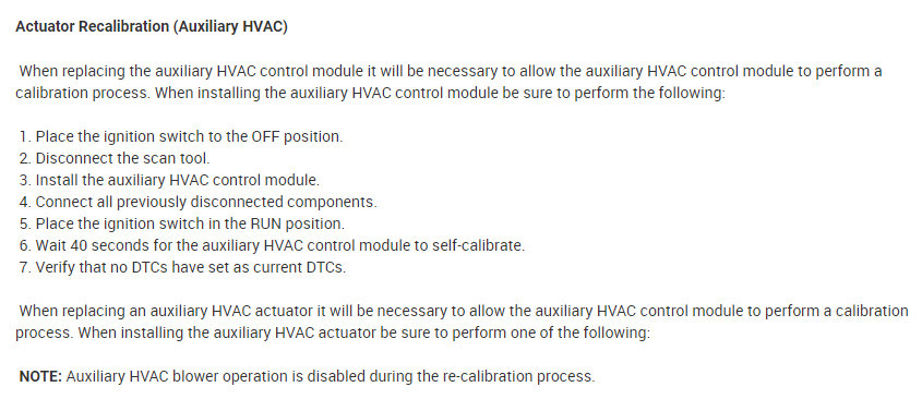

I've attached picture steps below on how to replace the auxiliary mode actuator on your Trailblazer. You will need to calibrate the actuator after completing the repair and I've included those steps below as well. Hope this helps and thanks for using 2CarPros.

Thanks so much for responding. I'm not sure if this is the problem or not. The noise on his Trailblazer is coming from all the way in the back on the right side of the cargo area. So kind of inside the right fender, maybe a foot before the tailgate. So since this info you sent is for a Silverado, maybe it's the same thing but in a different place? Maybe that's what you're saying. I'm not sure. Can you tell me if that's what you mean?

As you can see from the first picture the picture steps I sent are for a 2003 Trailblazer and not a Silverado. It is for the rear right HVAC unit auxiliary mode actuator in the right side cargo area. Those are the correct steps. Hope this helps and thanks again for using 2CarPros.

No need to apologize! We're here to help! Just to clarify the actuator tutorial is just to give you a basic idea of how to replace a similar actuator in the HVAC system. That might be related to a Silverado. The picture steps I attached were for your specific vehicle. Let us know if you have any further questions on this issue and we'll go from there. Hope this helps and thanks again for using 2CarPros.
