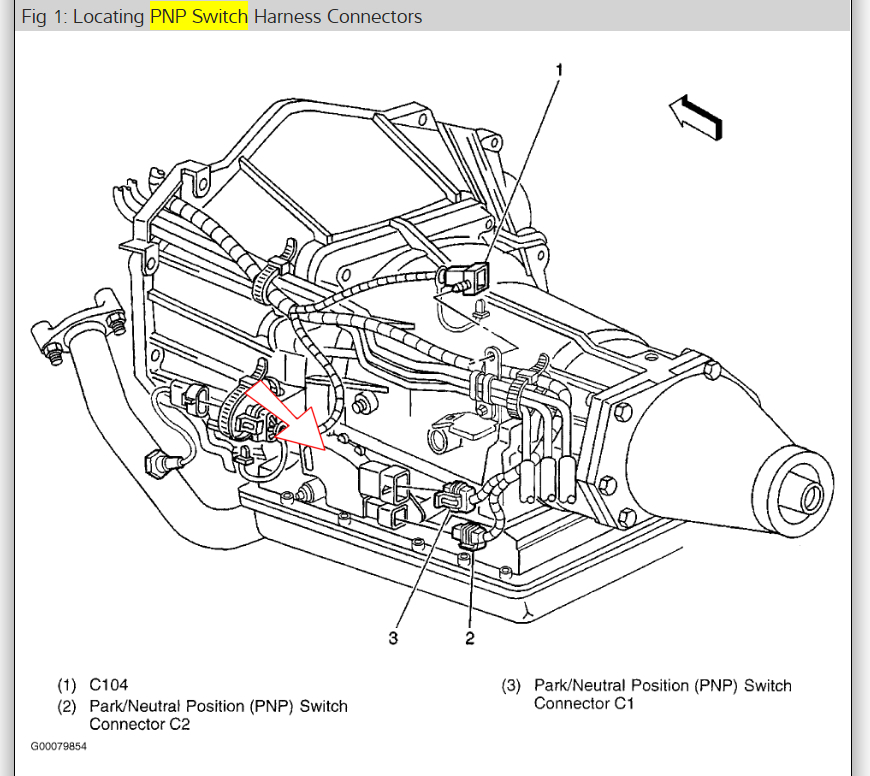

just need to know location of switch
Feb 23, 2010 at 8:39 AM
BLUELIGHTNIN6
CERTIFIED EXPERT
16,542 POSTS

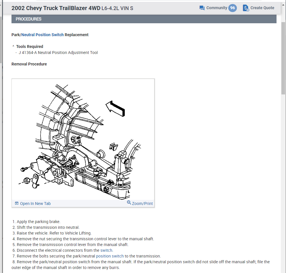

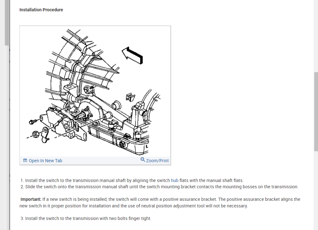

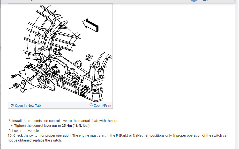

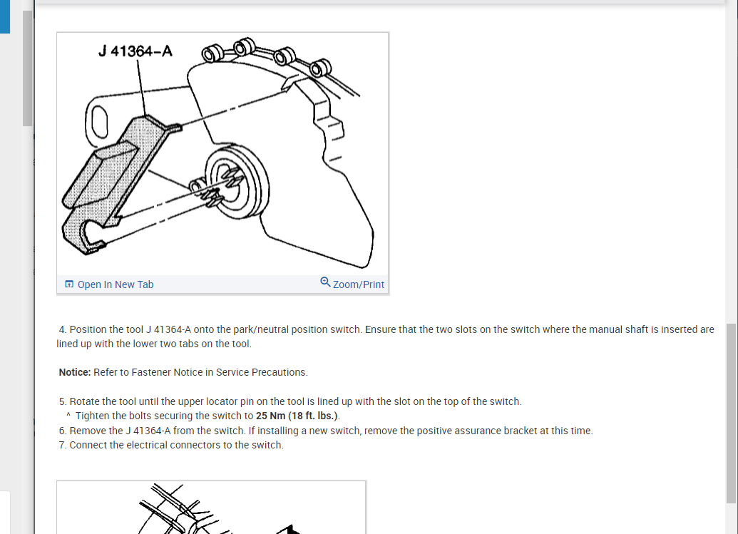

Park / Neutral Position (PNP) switch is located on the lower left side of the transmission. Check out the diagrams (Below). Please let us know if you need anything else to get the problem fixed.
