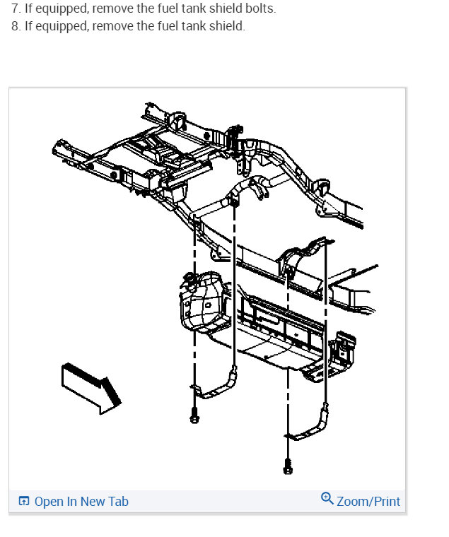

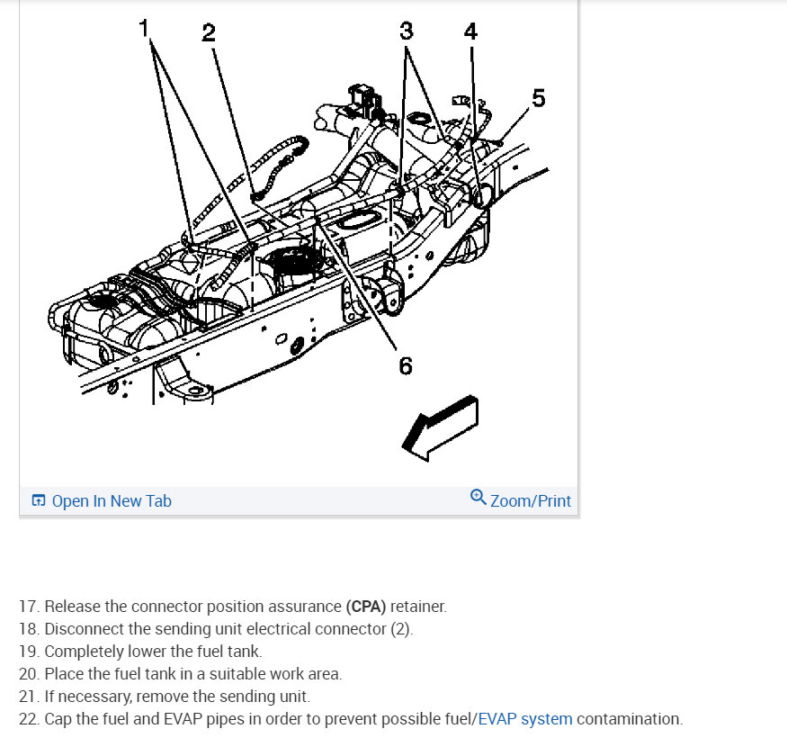

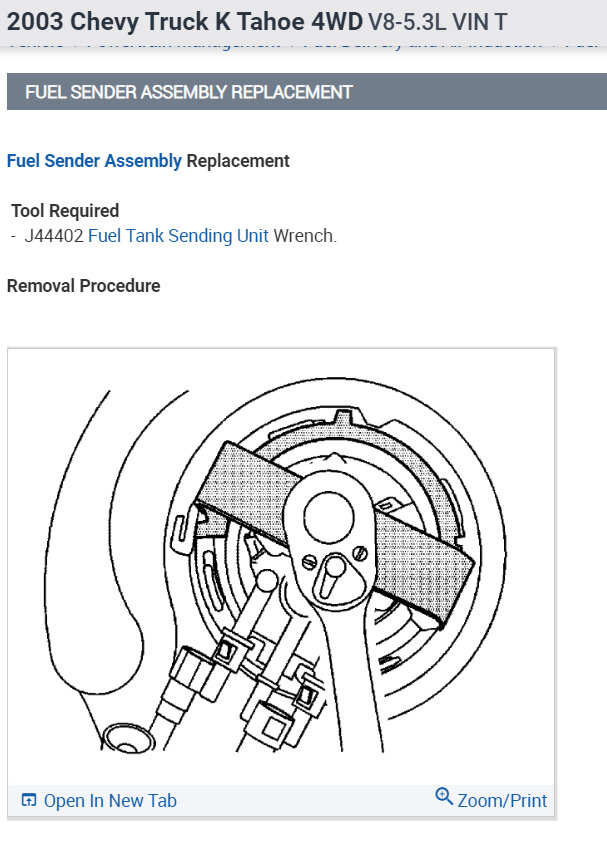

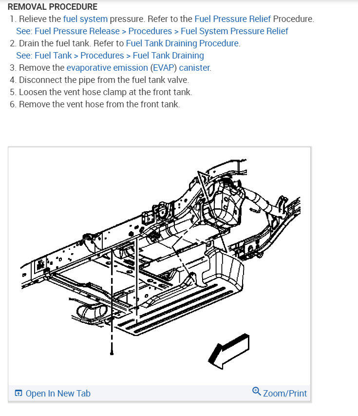

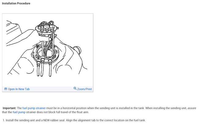

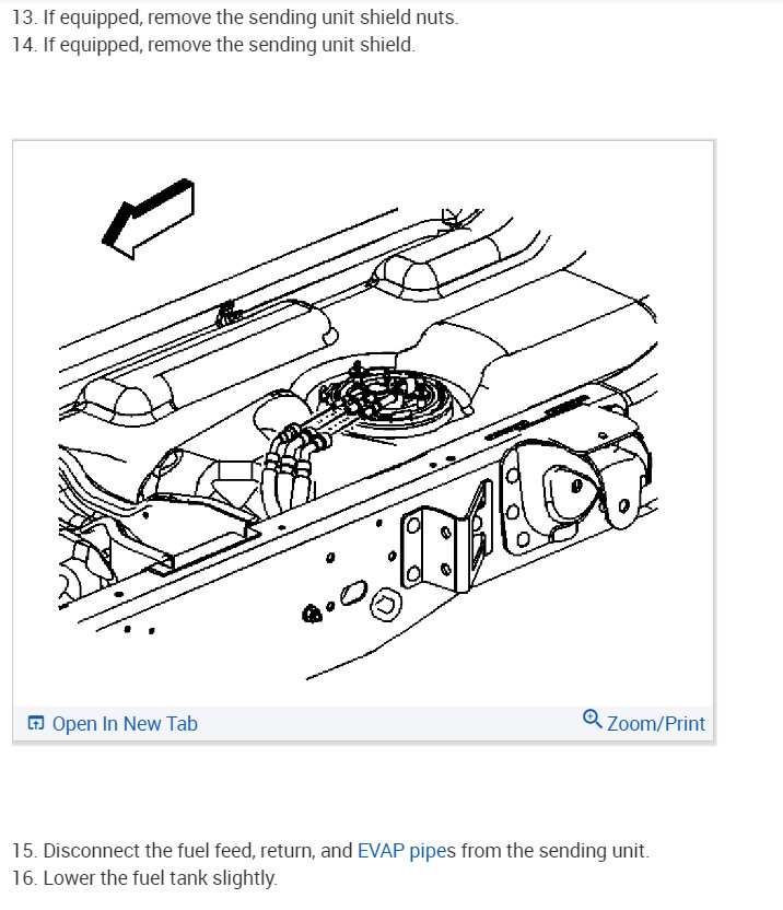

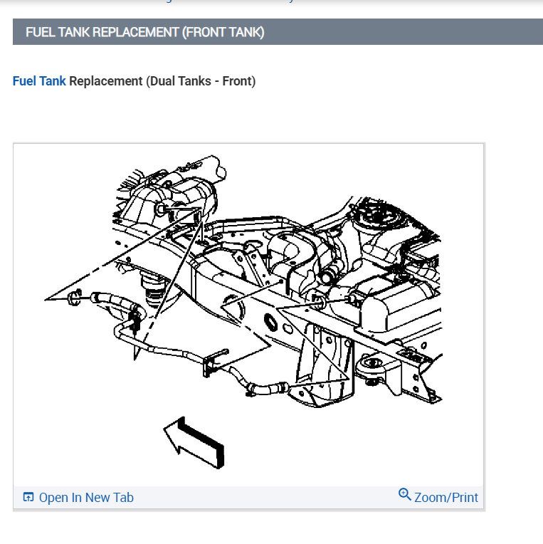

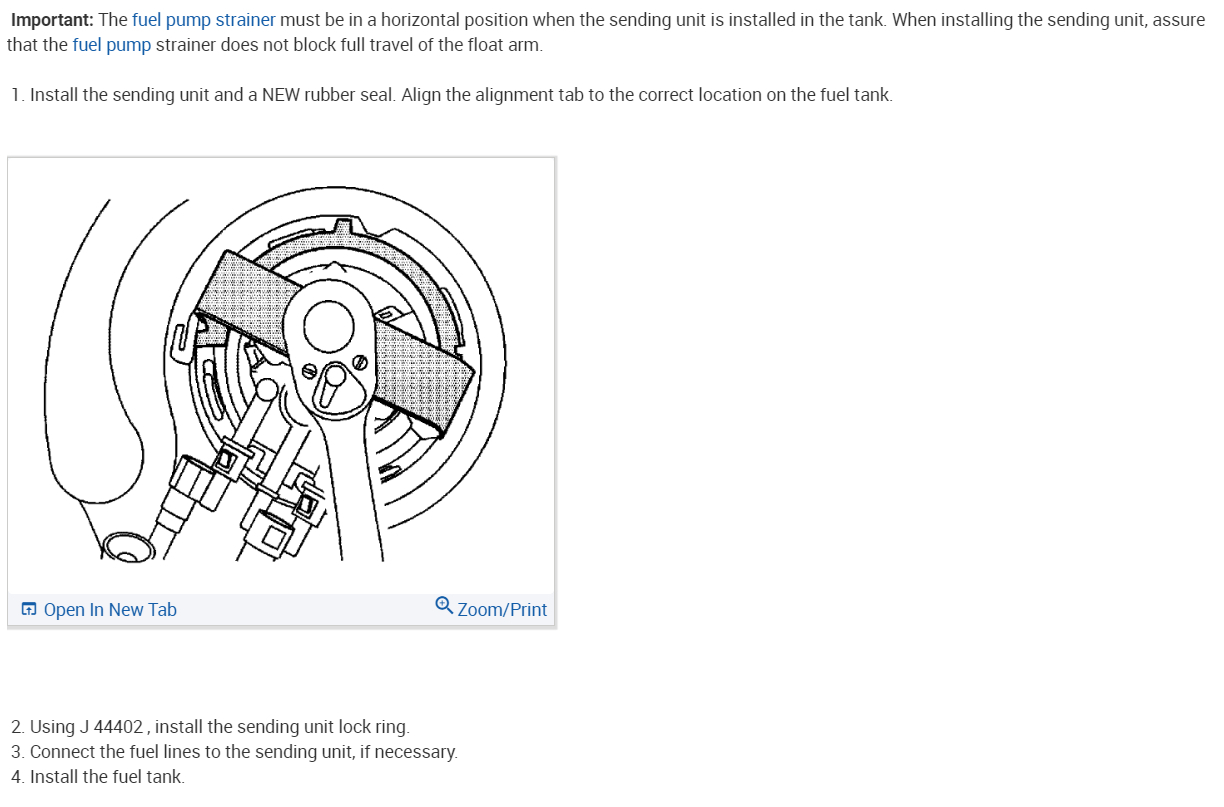

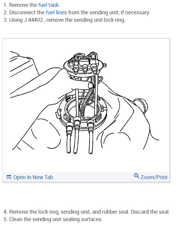

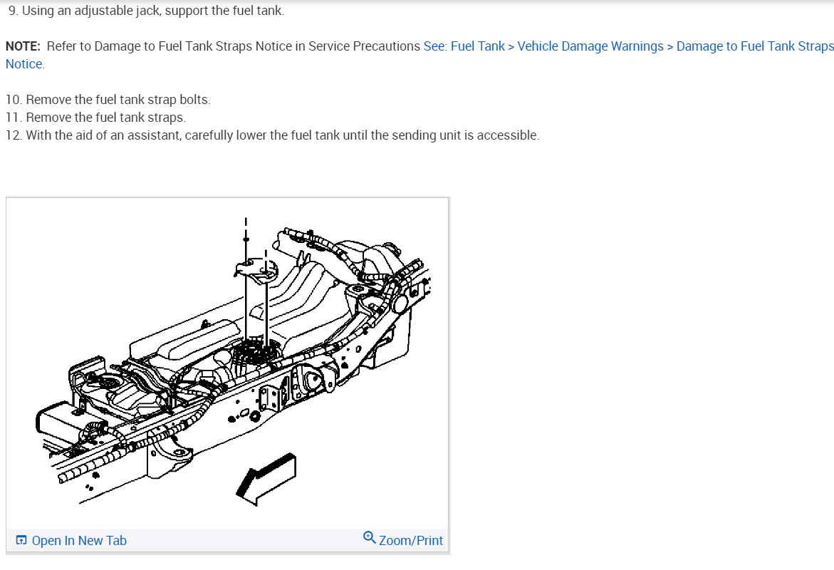

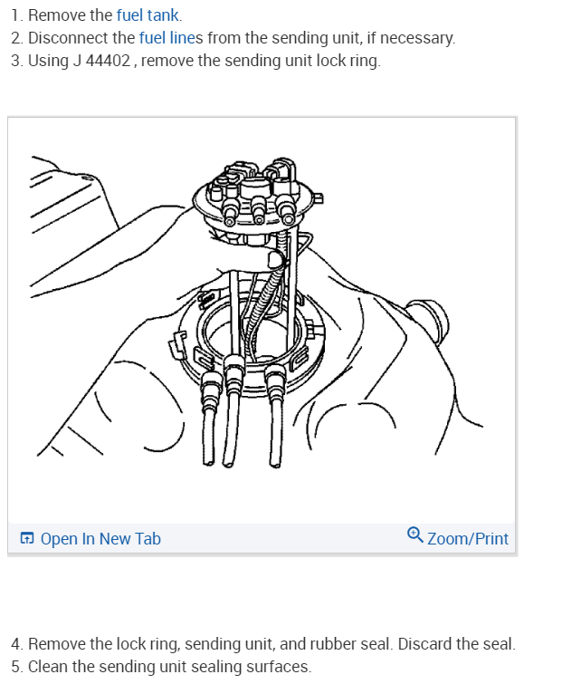

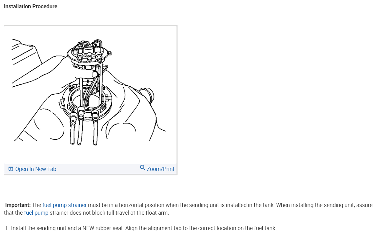

Around 66 psi this guide can help you with the test, you can get a fuel pressure gauge a the auto parts store by renting it for free or cheap.
Here is how to change out the fuel pump if the pressure turns out low. Check out the images (below). Please let us know what happens.
