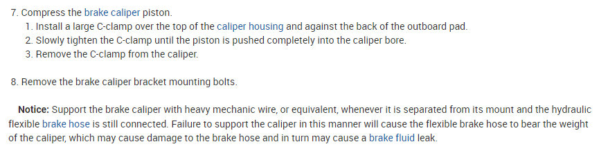

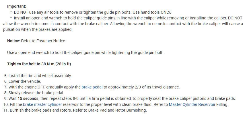

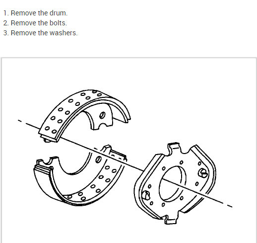

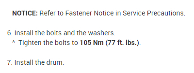

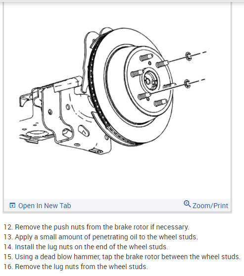

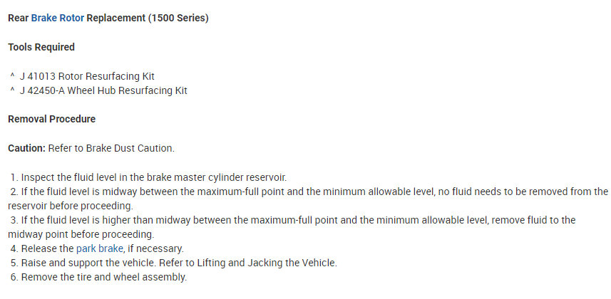

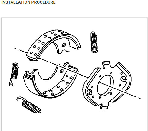

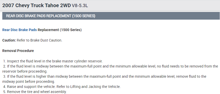

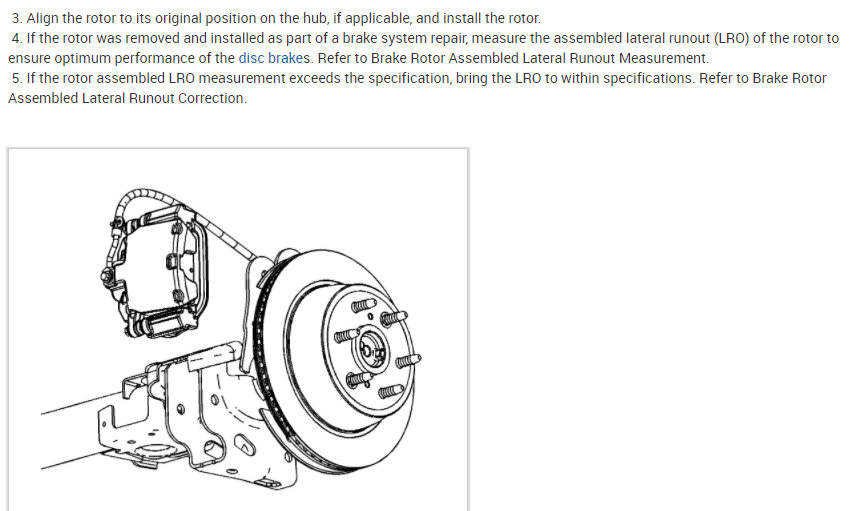

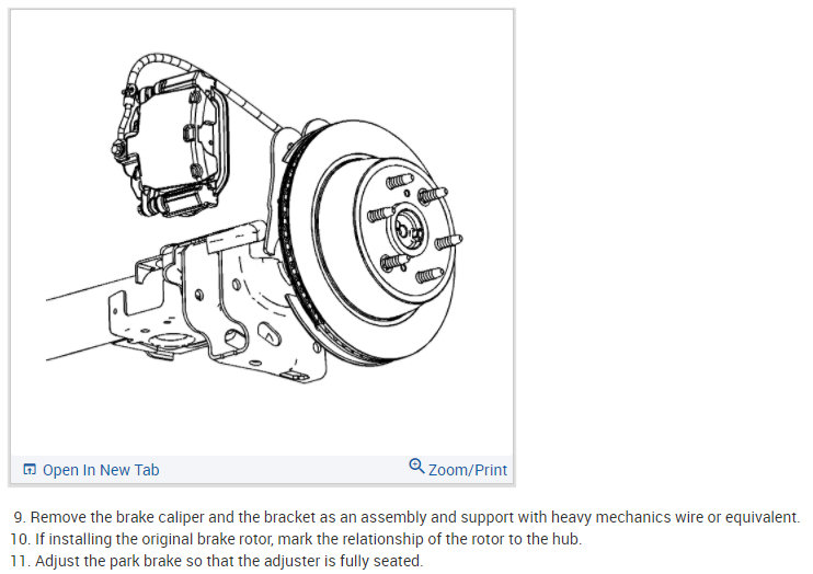

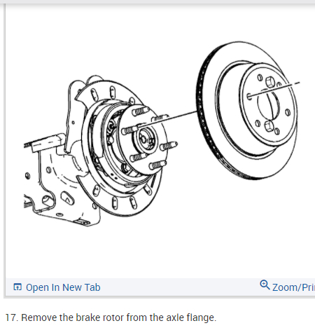

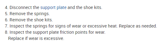

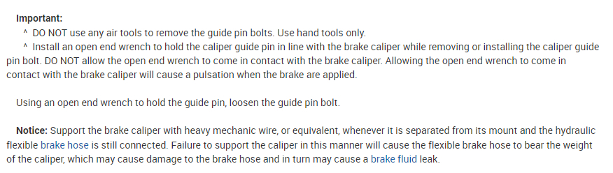

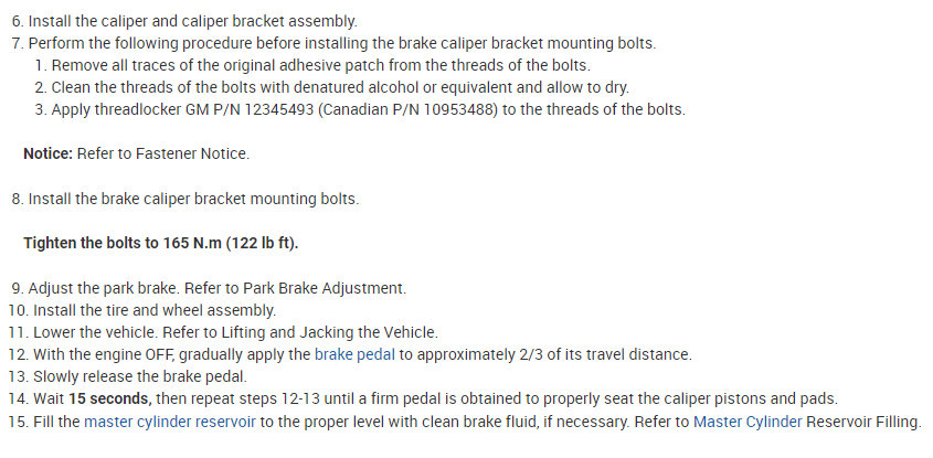

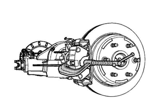

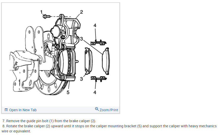

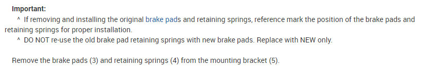

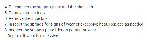

I am just wondering if you can give me the info on how to do the rear brakes? Thank you in advance.
Aug 24, 2009 at 8:39 PM
DANNY L
CERTIFIED EXPERT
5,648 POSTS

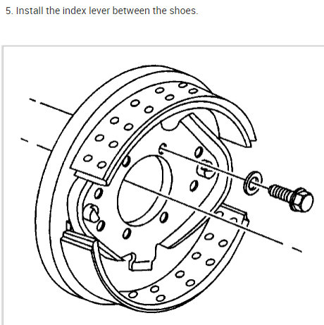

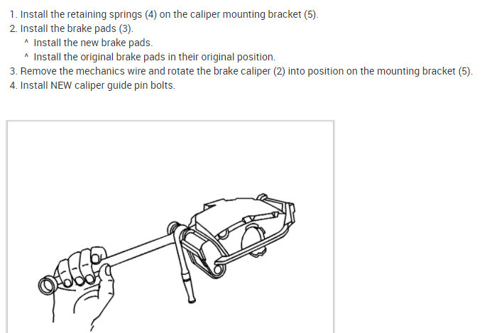

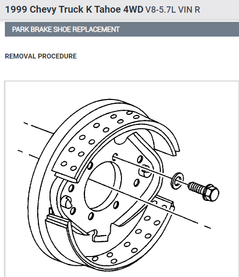

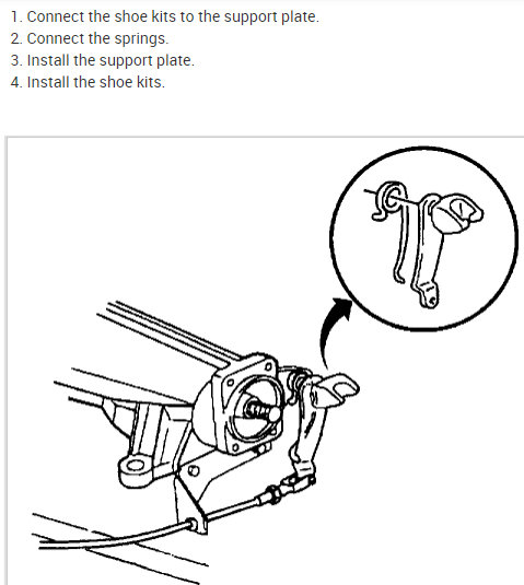

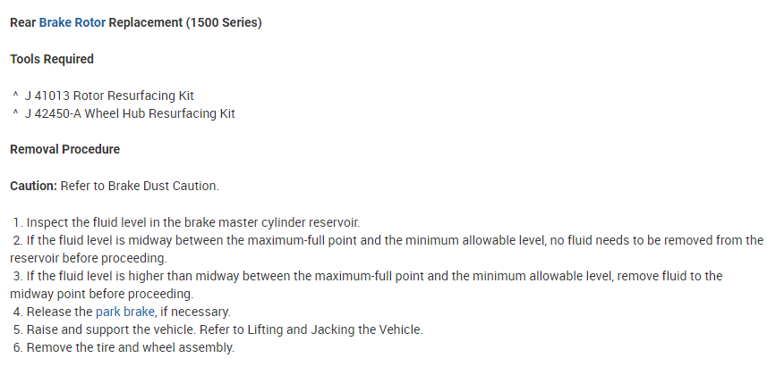

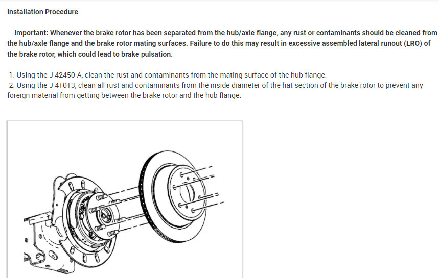

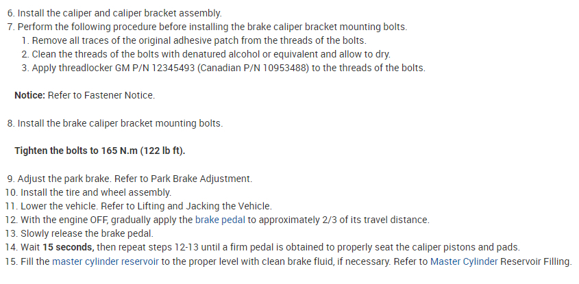

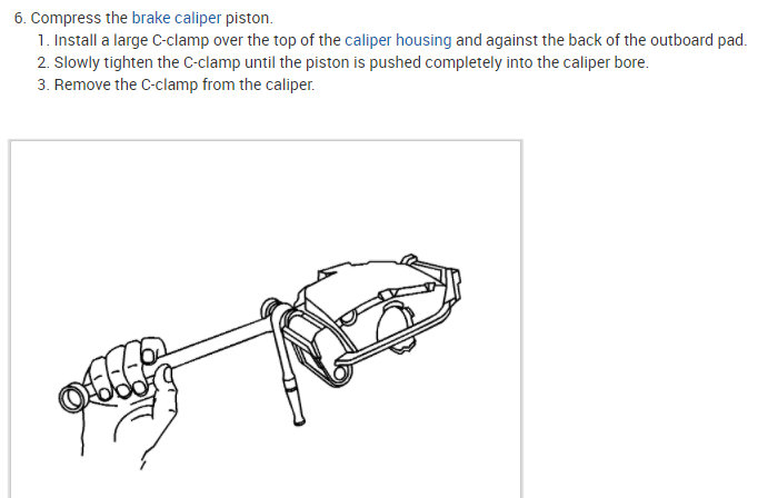

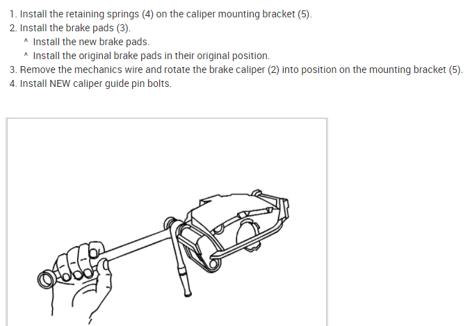

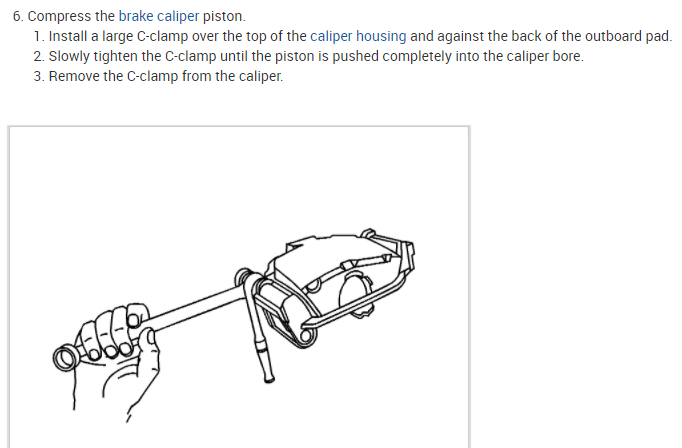

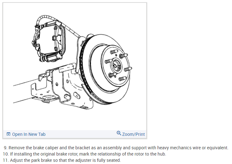

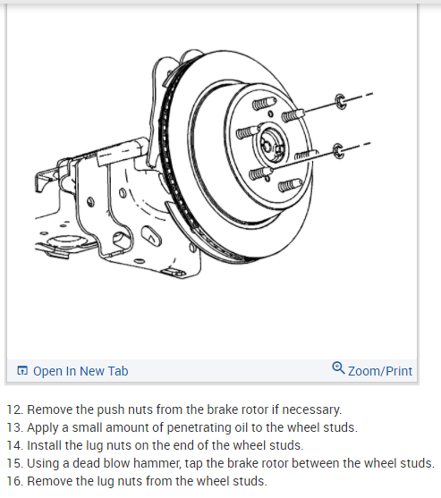

Here is the information you requested. Here is a tutorial on how to remove and replace rear brake pads and rotors: Here is a YouTube video from our site on how to compress the rear caliper piston when performing a rear brake job:
