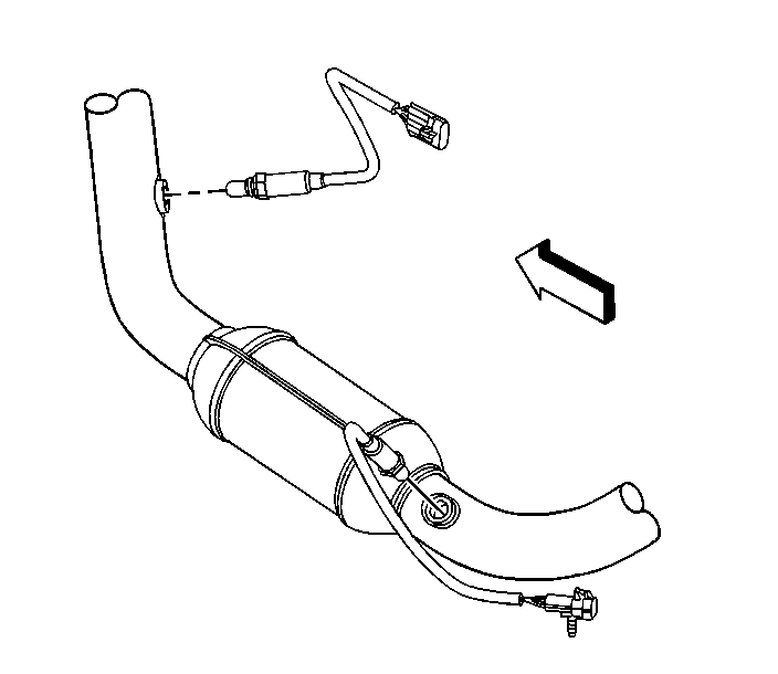

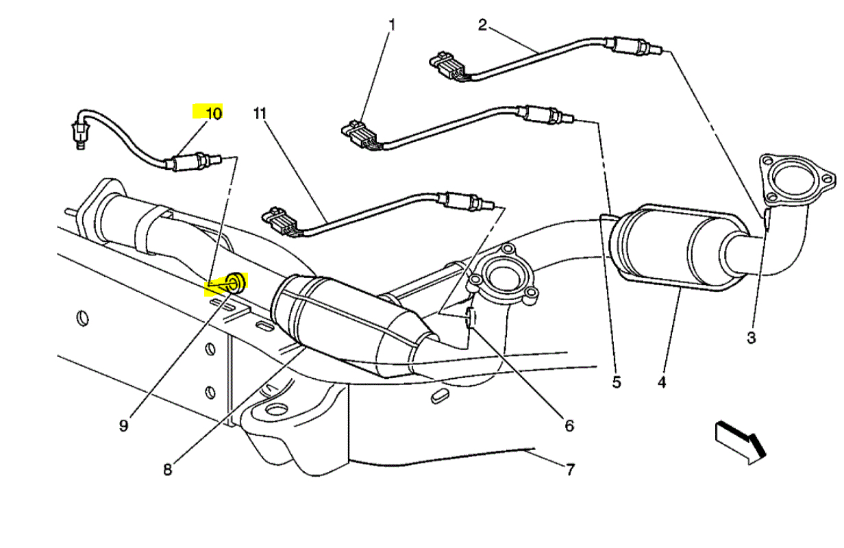

The down stream sensor is after the catalytic converter. If you look at the attached pic, I highlighted where it goes. If you look at the picture, bank 1 sensor 1 goes where number 3 is pointing and pic 6 shows bank 2 sensor 1.
Here are the directions for replacement. The remaining pics below correlate with the directions.

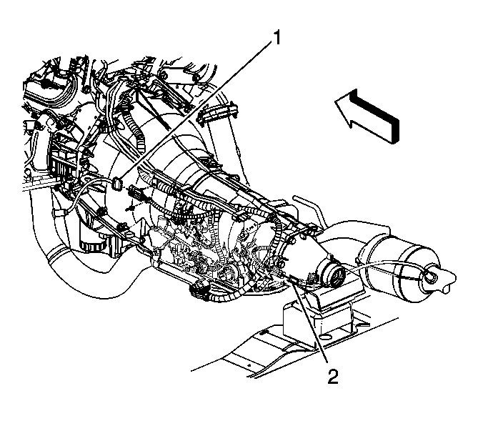

pic 2
1. Raise and suitably support the vehicle. Refer to Vehicle Lifting.
2. If equipped, disconnect the fuel composition sensor electrical connector.
3. Disconnect the connector position assurance (CPA) retainer.
NOTE: Refer to Heated Oxygen and Oxygen Sensor Notice in Service Precautions.
4. If equipped with a fuel composition sensor, remove the heated oxygen sensor (HO2S) electrical connector from the fuel line clip.
5. If equipped with a 4.8L or 5.3L engine, disconnect the HO2S electrical connector (2).

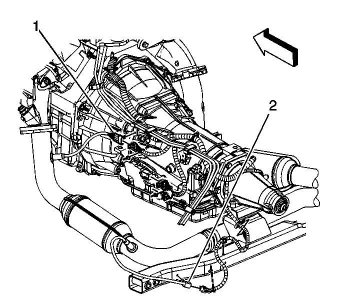

pic 4
7. Remove the HO2S.
