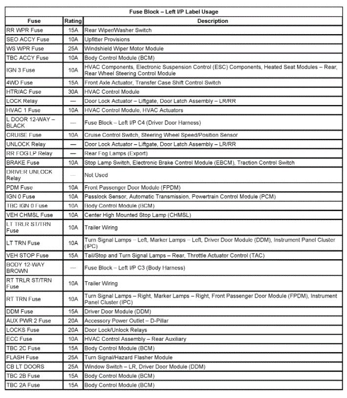

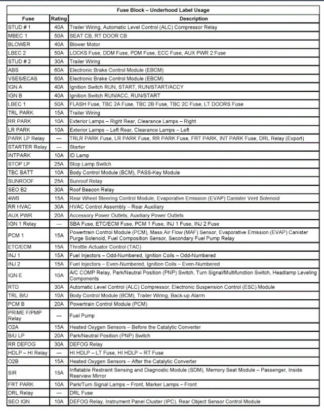

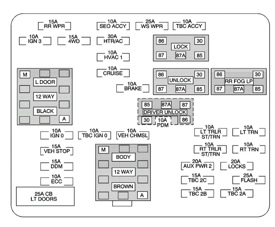

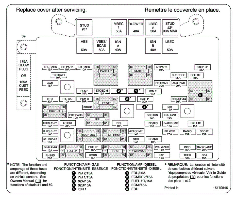

If you look below, I attached the fuse information requested. The first fuse box listed is under the hood. The second is in the vehicle. The legends follow the fuse box pictures.
When you check a fuse, not only should the fuse be checked, but also power to and from the fuse should be checked.
I hope this helps. Let me know if you have other questions.
See pics below.
