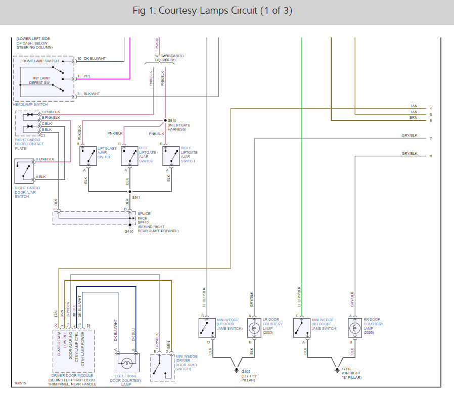

The interior dome lights and door lights do not come on when the doors open. The rear dome light does not come on when I open the rear door hatch. When I use the dimmer switch I cannot turn lights on. Dashboard cluster lights work. I can manually turn on the dome lights at the switch by the light. I checked the fuses at the dome lights and they are fine (obviously since I can manually turn the light at the dome light location
Oct 1, 2010 at 11:31 PM
GMTECH
  • 537 POSTS

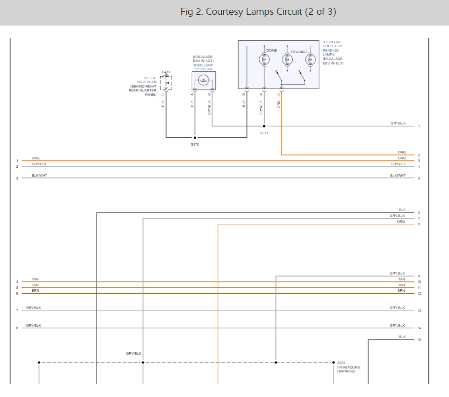

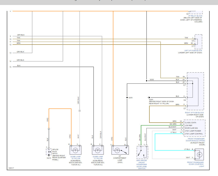

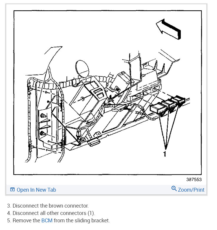

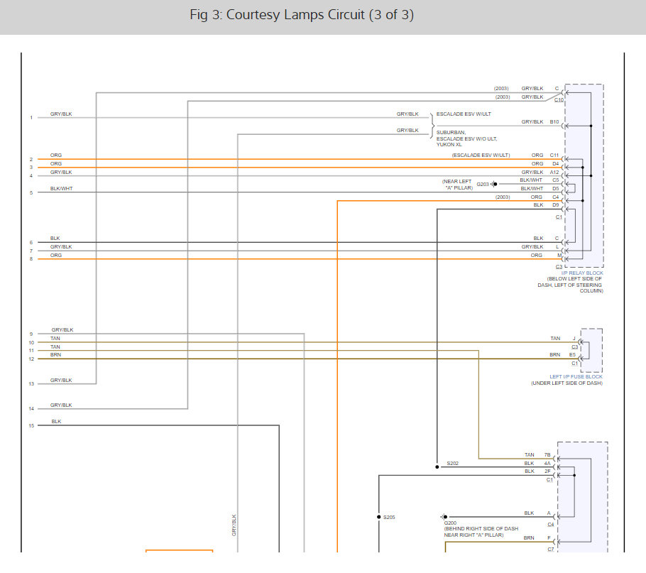

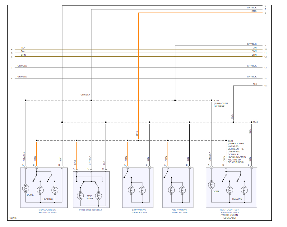

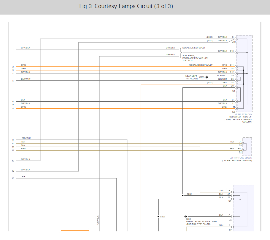

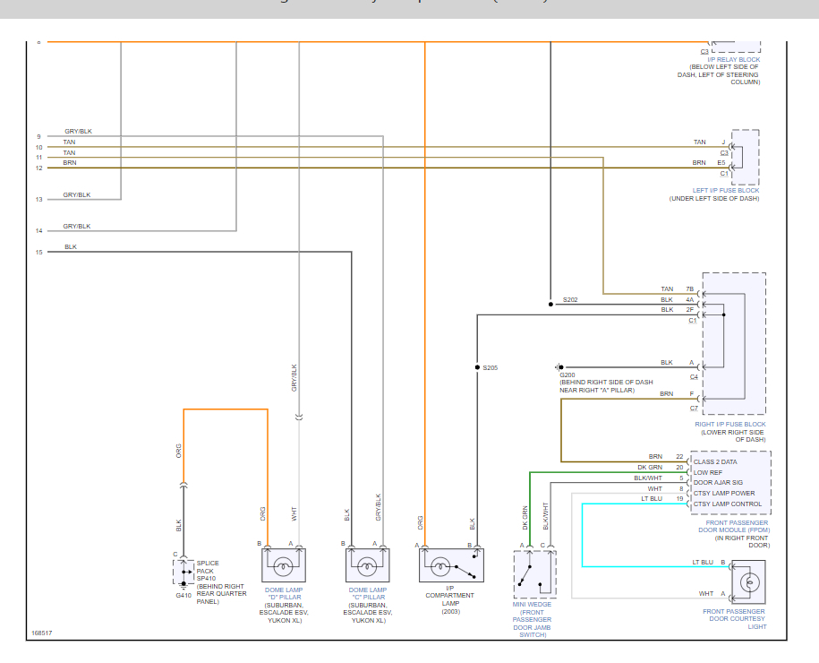

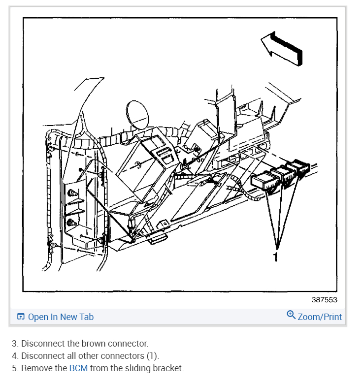

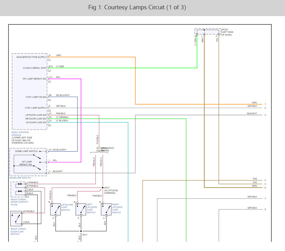

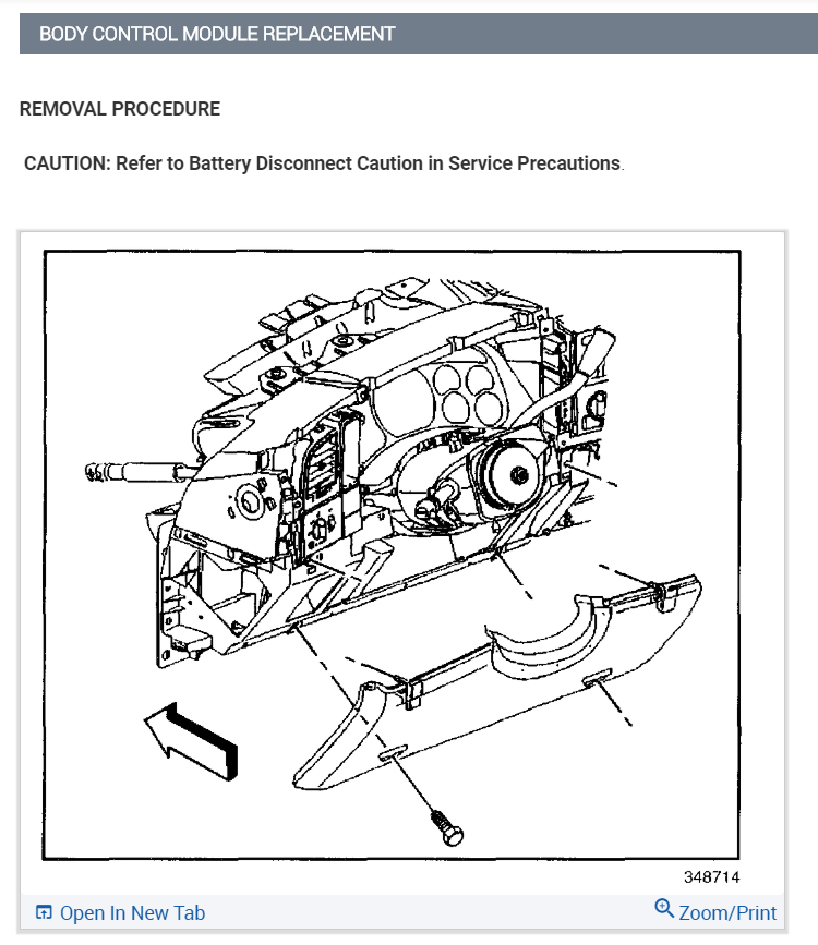

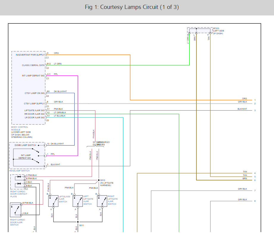

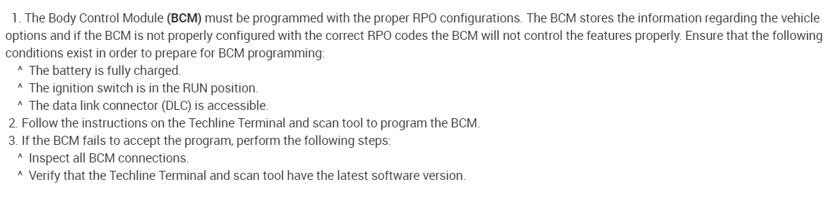

This might sound stupid but do you have the dome light override switch pressed in. If not perhaps the switch is defective. here are the interior light wiring diagrams so you can see how the system works. Youc an see the BCM controls the light so I have included the BCM replacement instructions as well. Check out the diagrams (Below). Please let us know what you find.
