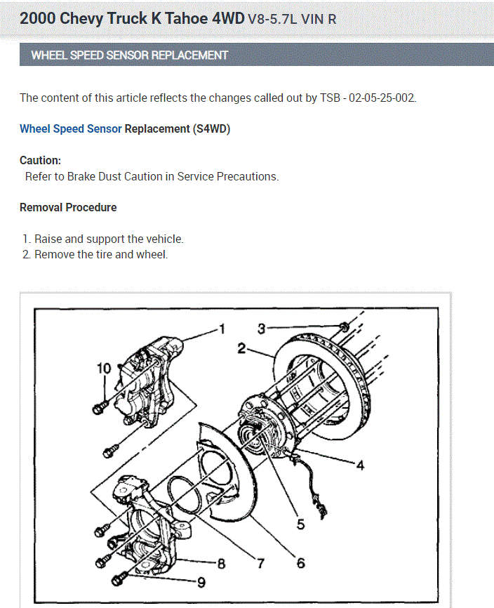

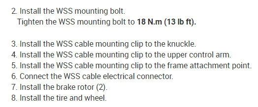

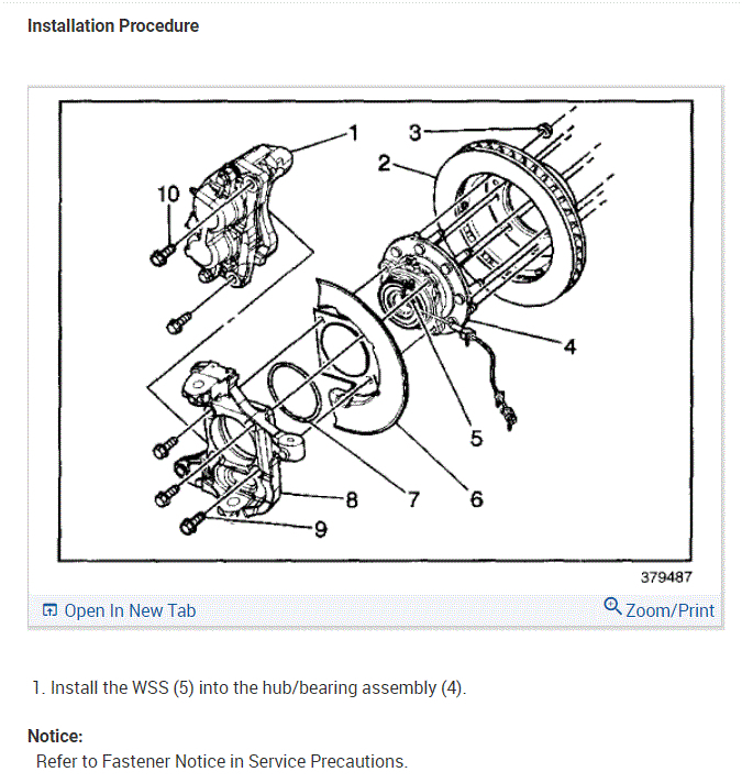

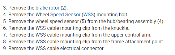

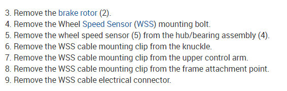

If you look at the attachments below, they provide the directions specific to your vehicle.
I hope this helps. Let me know if you have other questions.
See pics below.
