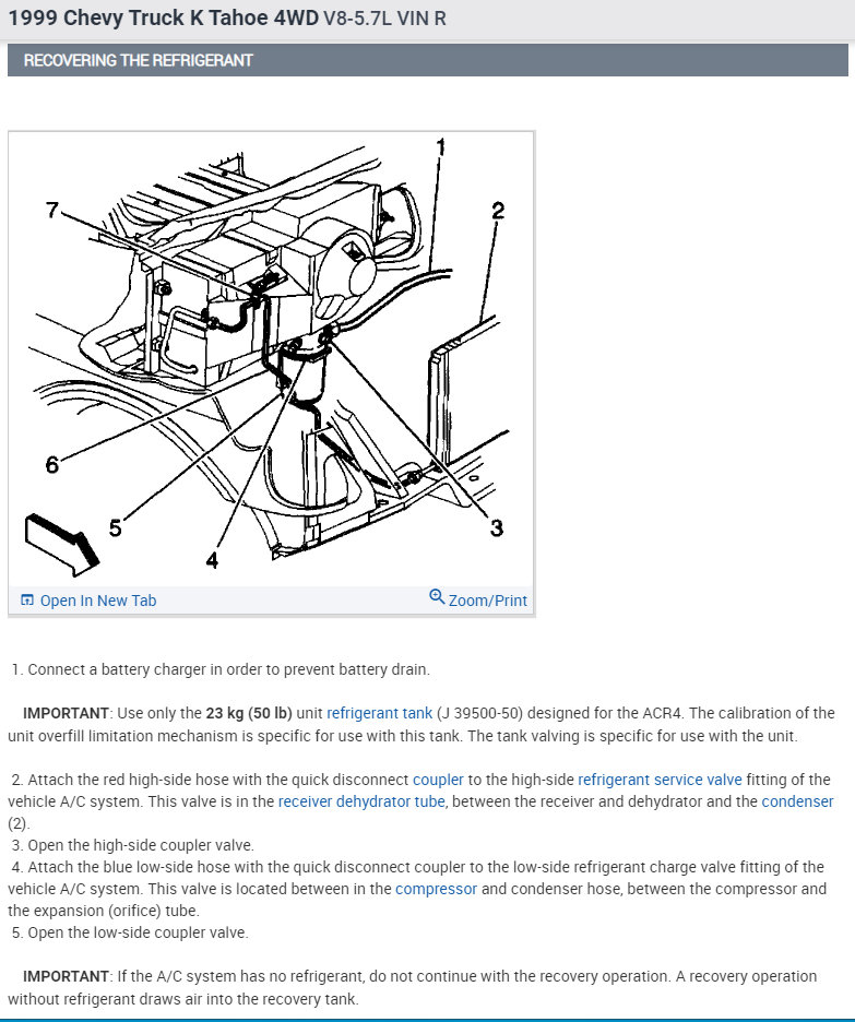

The shradder valve should have an O-ring that keeps it sealed. The O-ring can be replaced with a correct type and size O-ring. Keep in mind that there are specific type of O-rings for A/C lines and that is what needs to be used.

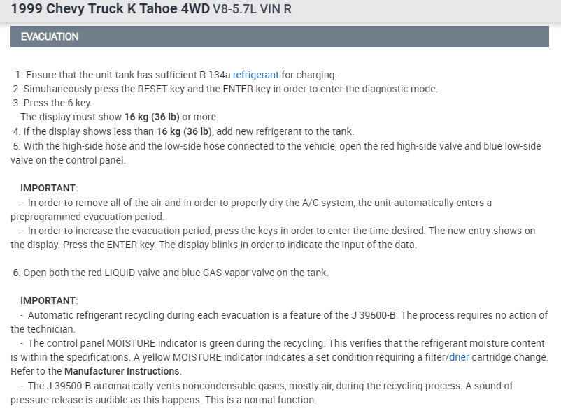

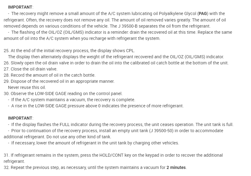

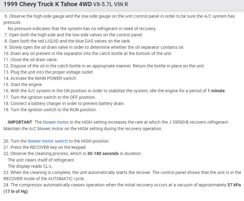

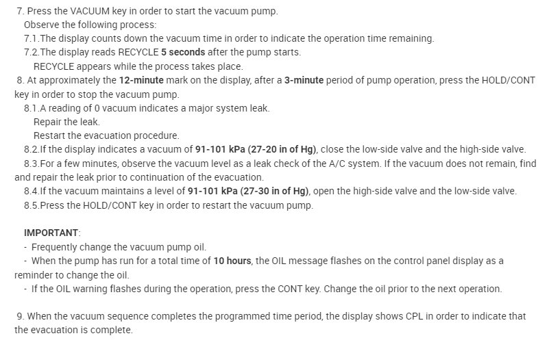

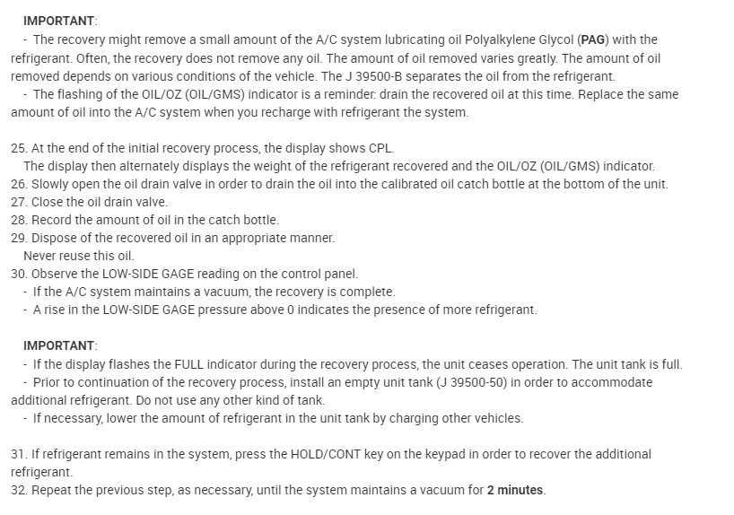

Before changing the O-ring you will have to evacuate the A/C system.
Here is a video of how to discharge the AC system properly:
