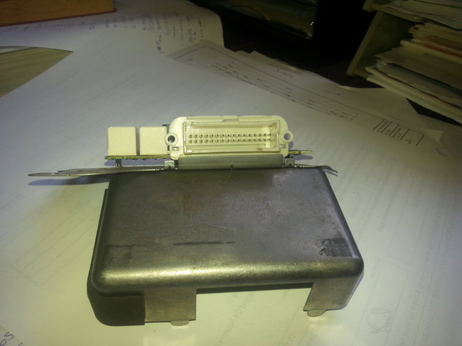

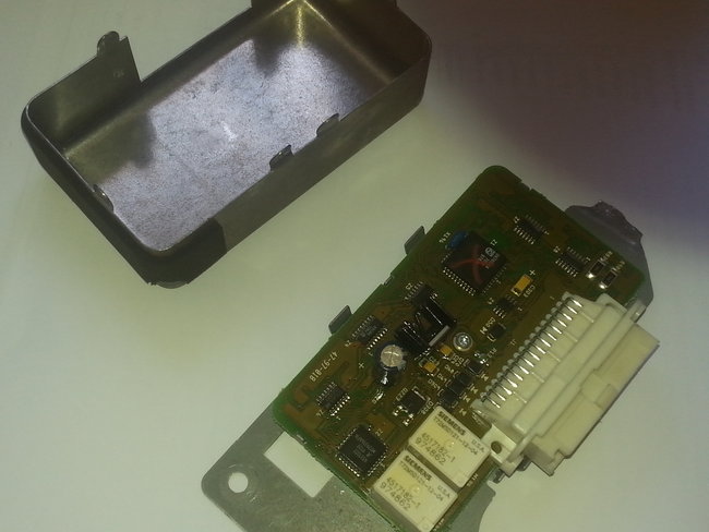

The module is located inside the vehicle under the dashuper left hand corner. It usually clicks three or four times and a lot of things happen when I start the car the next time, but not always. They are : Car will not stay running on till it warms up ,the indicator lights for the four wheel drive doesn’t come on exp. 2w,4x4auto,4x4 high,4x4 low but it dose change to the faction I push, It will drain the battery once in while (I have a new battery), and some times it will turn on the interior lights, the seat heaters don’t work. If it dose not click it seems as though every thing works.

I need you to check it is the actual module that is clicking.. also does the module have a part # on it ? there are numerous relays located under the left side of the dash .. please check it is not one of these clicking !!

This is the actual module that is clicking The # is 15009564. And it is superseded to12577421. Do You know of any bulletins on this module ?

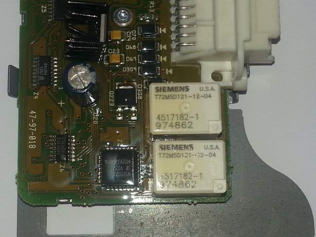

We have a 1998' 'Holden' badged Chevy suburban that we are unable to electronically get into 4wd. Like you Gavin, no stored trouble codes; lights for 2hi/4hi/4lo push button select light up after turning key on , (to show lights function), before remaining in steady 2 hi. We have ruled out other problems as front axle actuator; motor encoder, and wiring to it, as it shows good voltage. We also took our vehicle to a professional yard that only works on Chevies, who used both a 'Tech 2' and another even more expensive scan tool, commenting that his machines couldn't read our system, to get a true diagnosis, only stating that when 4wd hi and lo were activated, he could only get a signal to the TCCM. (no further info). When we try to activate 4wd, we appear to get a clicking sound, coming from inside the TCCM likely we think, one of the two small relays there. We have also tried to check voltages on the harness wiring from pushbuttons 4wd select, going into TCCM and these appear good, visually and getting voltage. We have prev had issues with the finicky wiring in push button select, with 4hi/4lo lamps not turning on,(but they have been easily fixed, lamp wise) but do remain unsure whether something as simple as a dud 4wd select unit could still be the cause for all our problems; or just the TCCM even though there is an absence of fault code e.g. like a DTC 4. Like Gavin above, can the absence of a TCCM fault code still not rule out a bad TCCM? We opened this unit up as well, and saw no evidence of anything being burnt out; or corrosion etc. The pins going into the TCCM looked also very clean and shiny. Rather than spend $500 getting a replacement, is there another way of checking the TCCM for issues? I have some pics of the TCCM eg relays. Have noted on other forums the general confusion others have in determining where there 4wd relay is located. So even if no one can help me, perhaps my small contribution might offer someone something.
