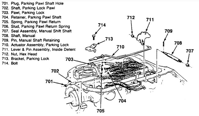

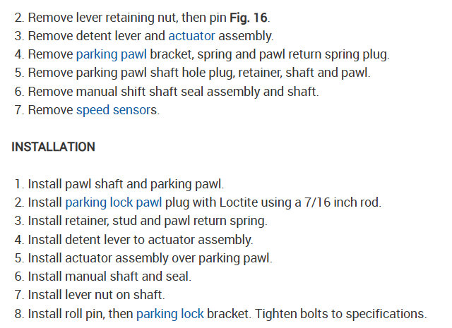

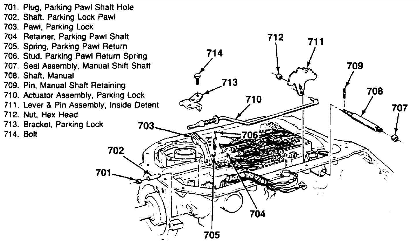

Yep, there is something wrong inside the transmission if it went into park before. Here is how the parking pawl should looks and work. Check out the images (below). Please let us know what happens.
