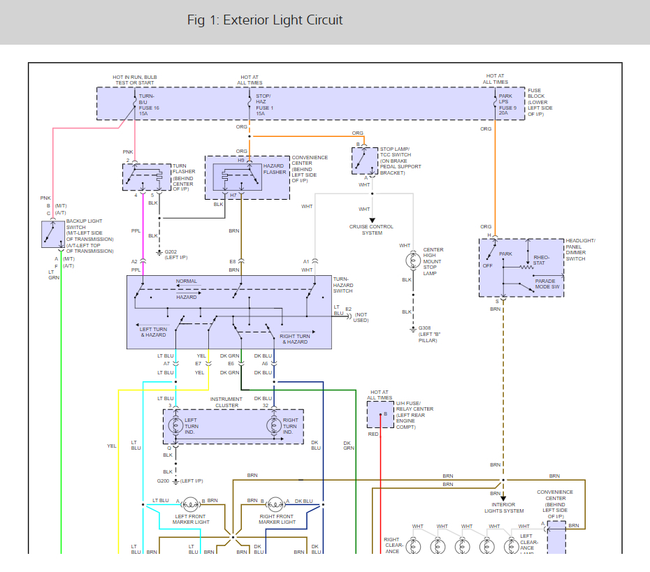

There is a stop lamp switch relay that sounds like it has gone out, but to be sure lets run a test using this guide.

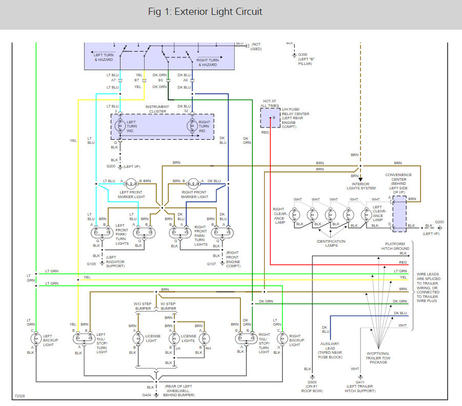

So down under the dash at the top of the brake pedal is a brake light switch. Did this get replaced? See if the orange wire it hot. If so, check to see if the white wire has power to it once the brake pedal is pressed in. Or to be easier just run a jumper wire from the orange to the white and see if the lights come on.
If all is good and you have power coming to the back lights when the brakes are pressed in, it should be a ground problem or connector issue under the rear bumper area.
Do you still have blinkers and all that?
Is the third brake light working or not?
Do you have tail lights but no brake lights?
I had a heck of a time with mine. Come to find out my white wire was broken about ten inches past where it comes out of the brake switch just above the steering column (shaft). That was a pain getting to so it could be fixed.

It is strange both sides are out at same time but are you certain one was not working before the other? I worked in a shop were we worked on a lot of these trucks. The problems I have seen are the circuit board that the bulbs plug into are very common. Easy to check pull apart rear tail light assemblies and check circuit board for rust or breaks in circuitry. Could also a wiring harness that goes to the brake light switch it is a pain to get to. The harness is up under dash by pedal follow wires from switch and the harness rubs against steering column brace. Good luck if it is that because it is a pain to repair.

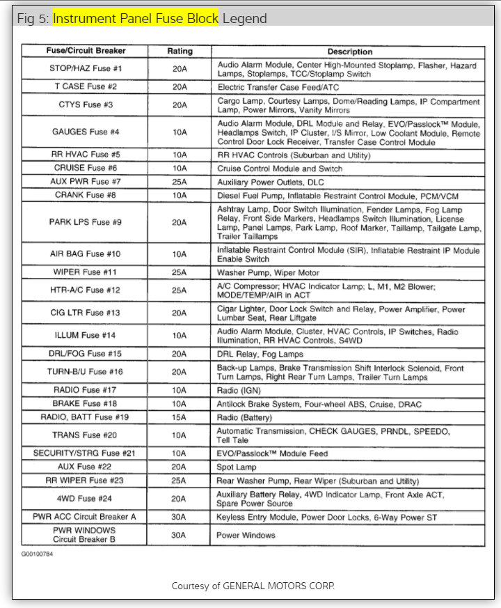

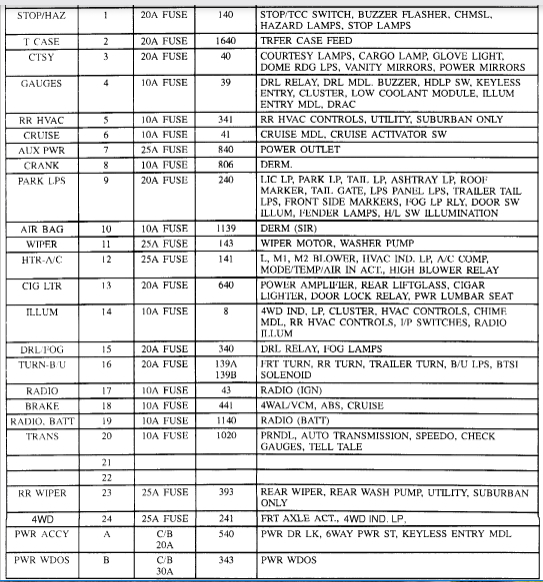

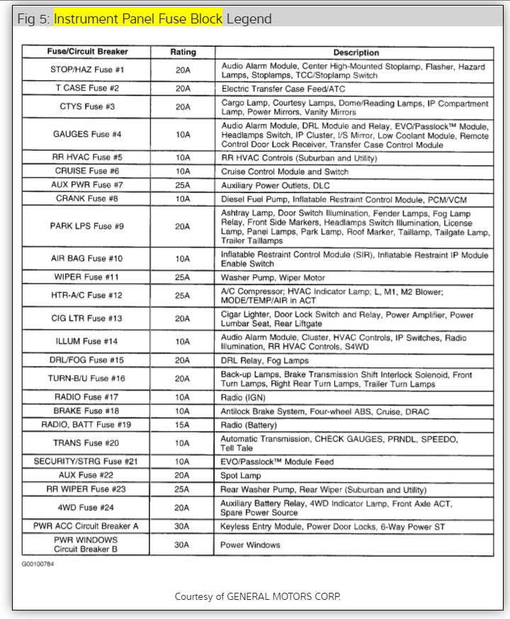

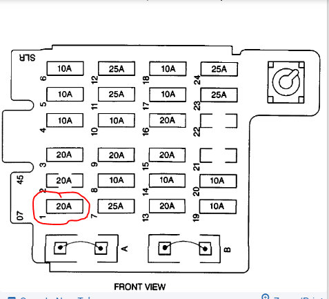

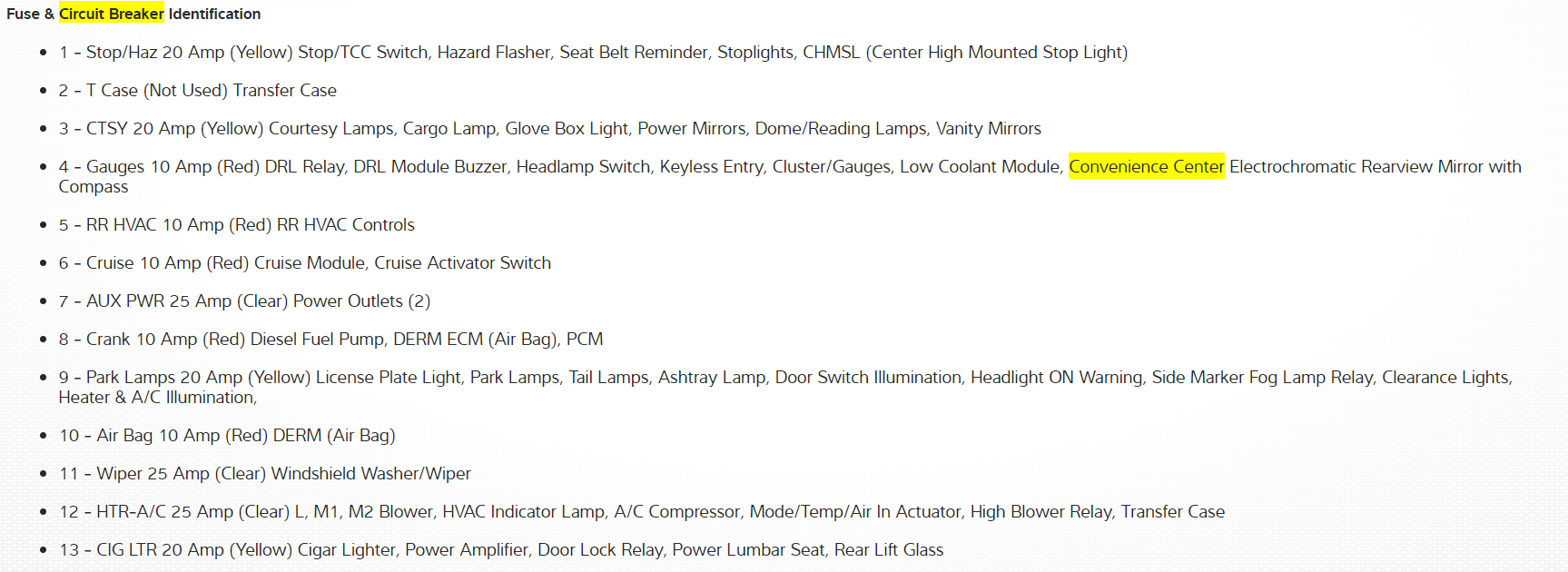

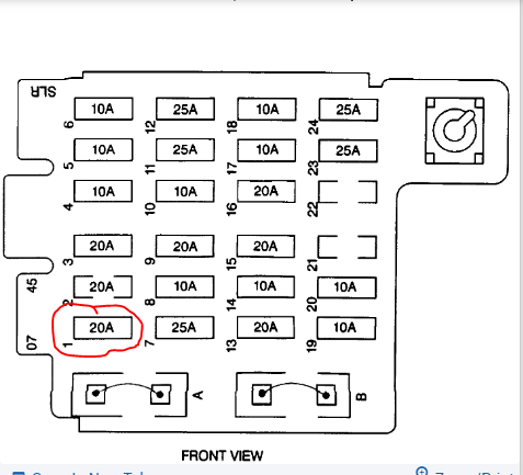

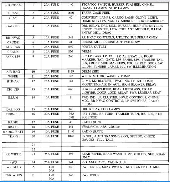

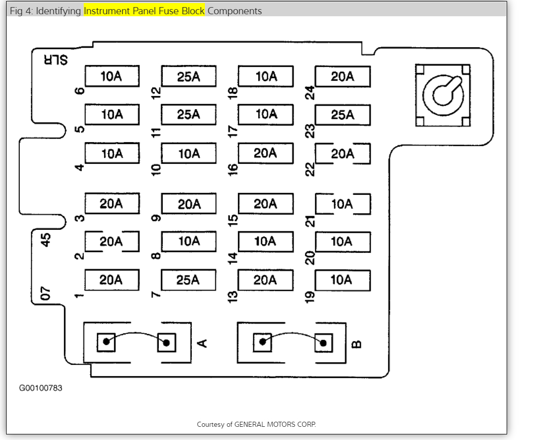

There are multiple fuses, but only one also affects the hazard light circuit. Thank you for including that observation. Check fuse number one in the inside fuse box. It is a 15-amp. It should have twelve volts on both of its test points all the time. If you find that, check for twelve volts on the orange wire at the brake light switch. Tell me what you find, then I will figure out where to go next.

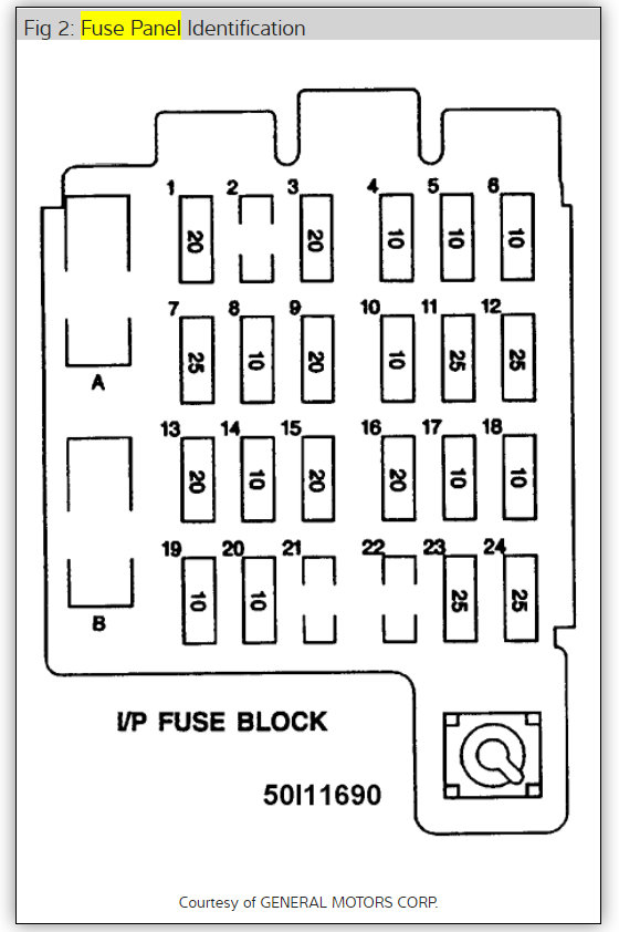

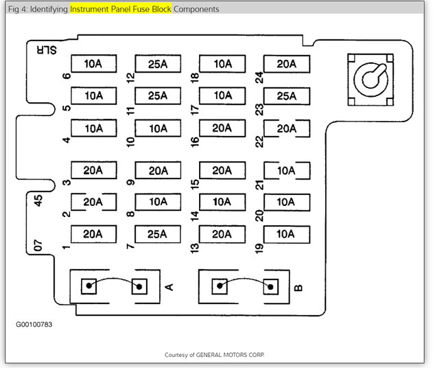

First thing you should do is check the stop/hazard fuse in location #1 in the fuse box on left side of dash. Here is a tutorial showing how to check:
https://www.2carpros.com/articles/how-a-car-fuse-works
If fuse checks out good it would then likely be the brake light switch. I've attached pictures below.Hope this helps and thanks for using 2CarPros.

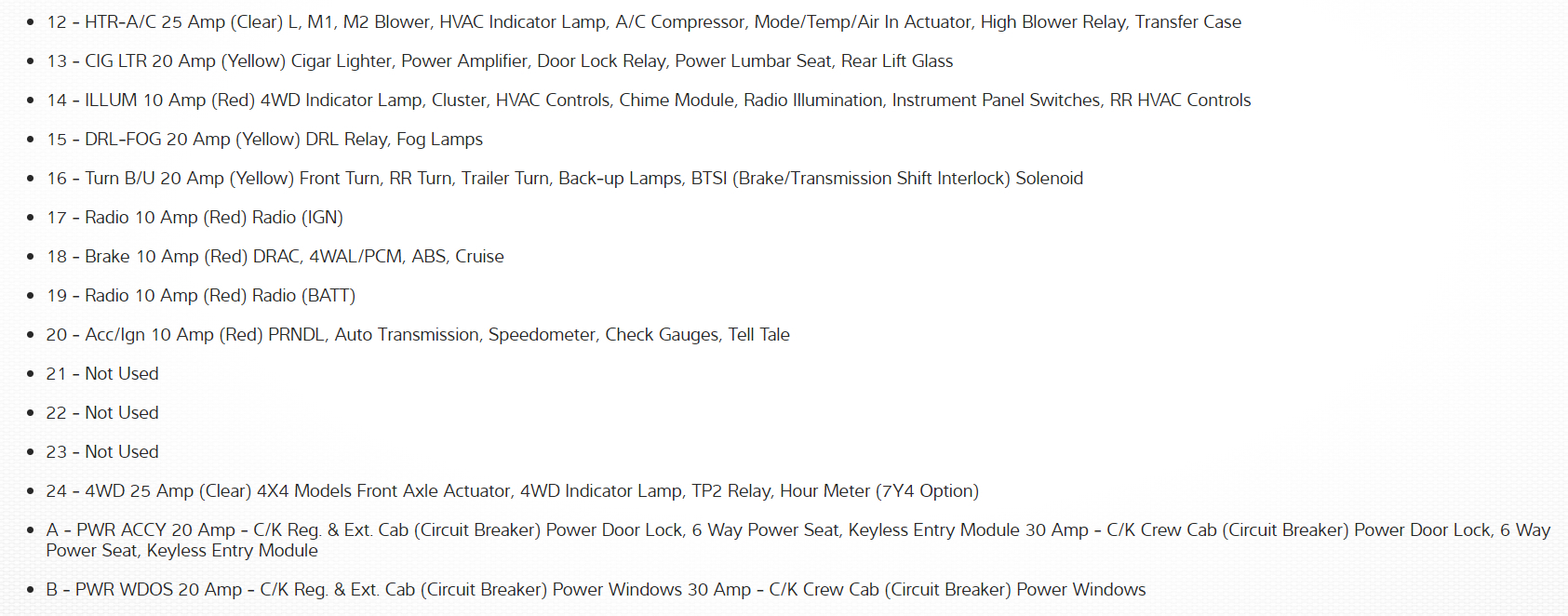

My brake lights will not work but my cyclops will work. I have checked all the fuses and the only one that I have a problem with #19, #20 fuse
I have replaced both bulbs and all the fuses and still does not work. When I put a fuse into 19, 20 it pops the fuse. 19 says Radio Batt and 20 is PRNDL which I don't know what that means. please help
Dec 23, 2020 at 1:35 PM (Merged)
it means there is a short in the system somewhere and you need to have it checked for the failure and repaired.
start there, it may control your brake lights.

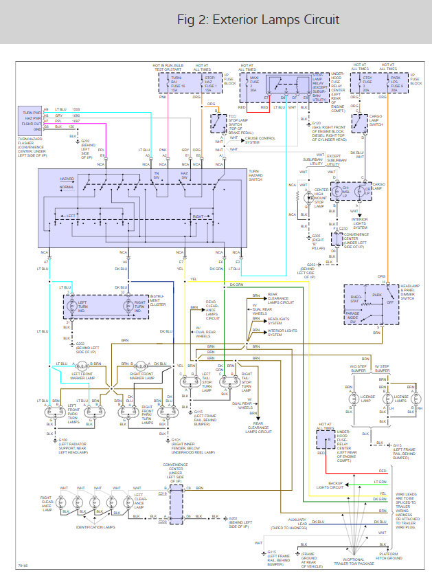

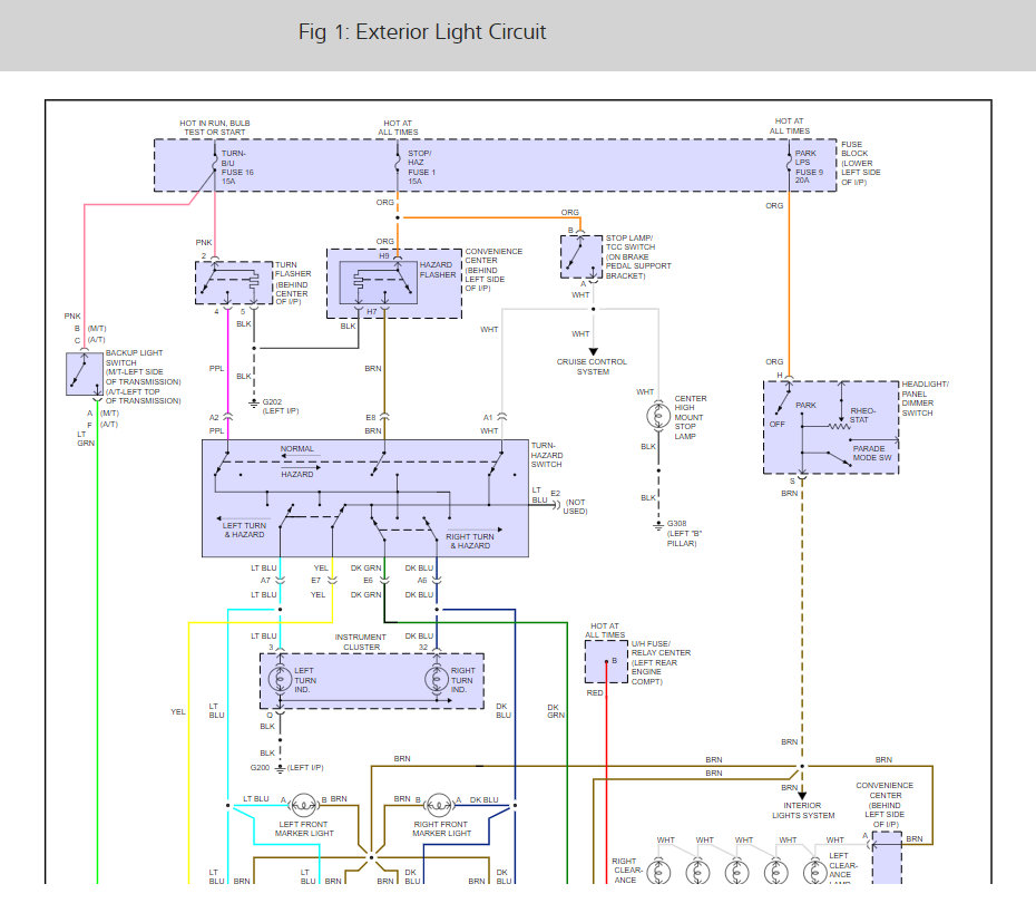

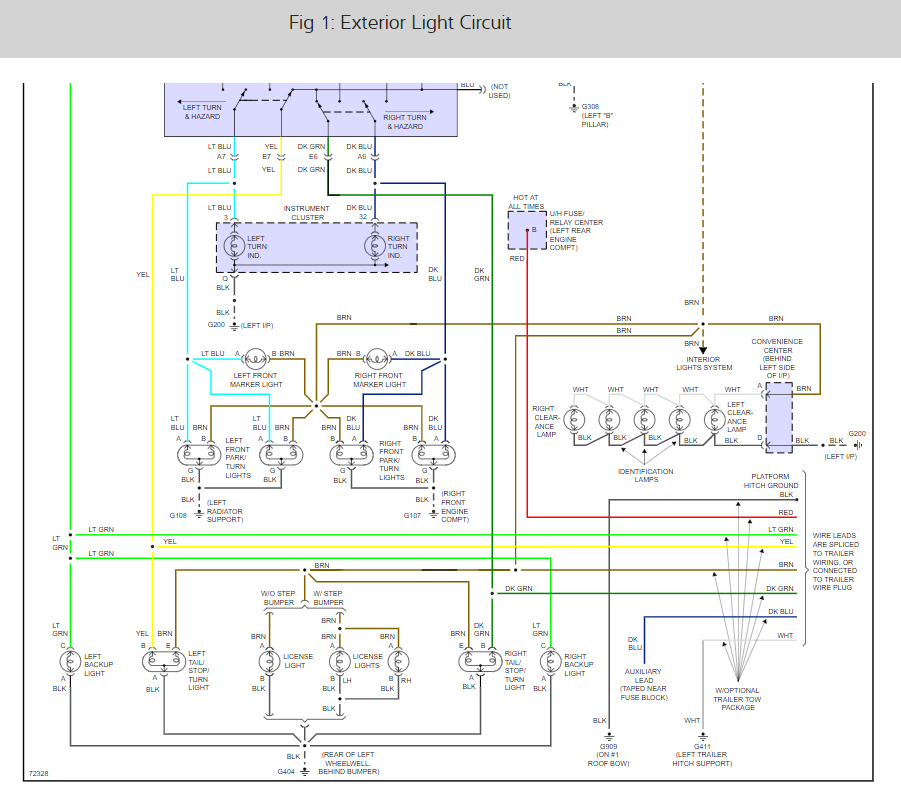

There is a stop/hazard fuse that needs to be checked for power. Here is the brake light wiring diagrams so you can see how the system works and a guide to help you see how to test for power with the fuse location as well:
