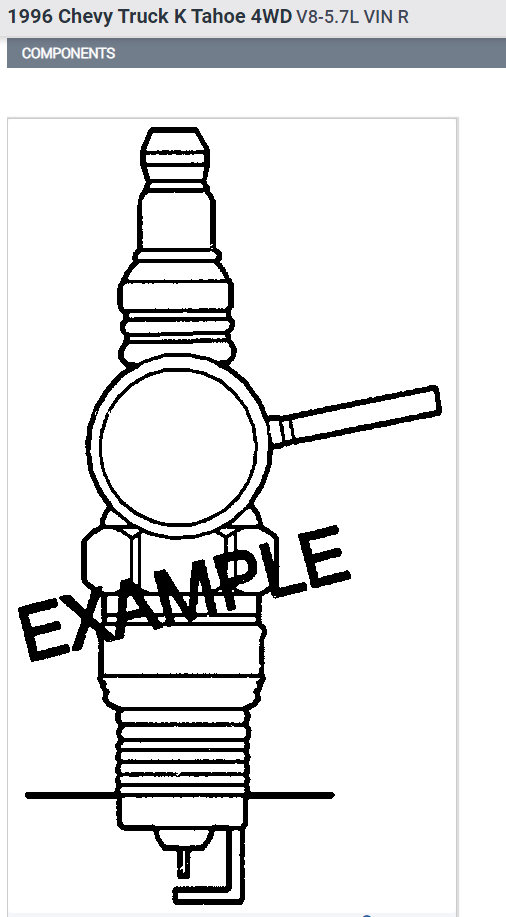

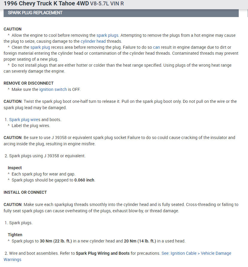

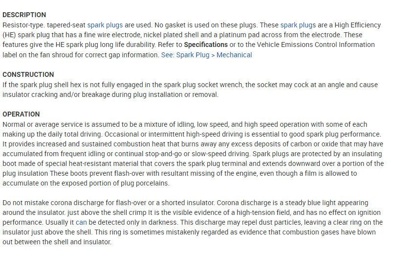

Check the spark plugs for wear and gap. Spark plugs should be gapped to 0.060 inch.
If you have excessive carbon build up on the plugs they can misfire. Also if the plugs has not been changed in a while it is a good idea to change them.
https://www.2carpros.com/articles/how-to-change-spark-plugs
