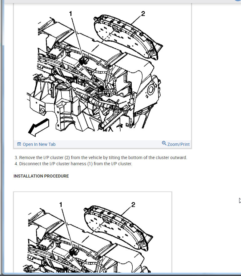

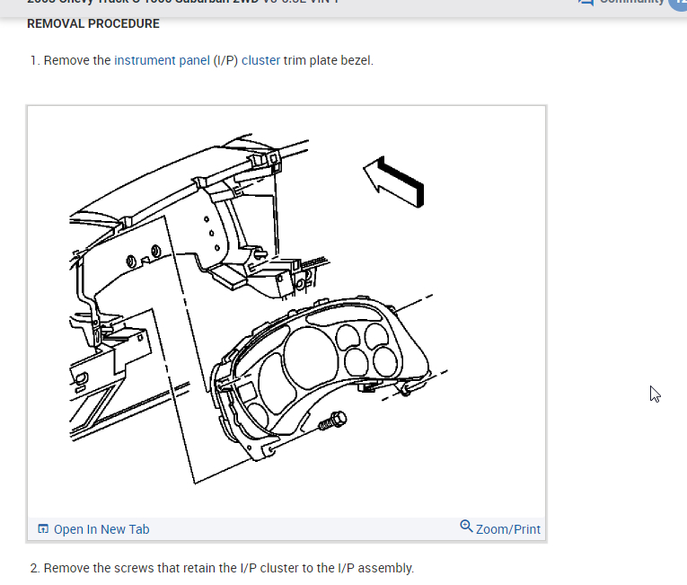

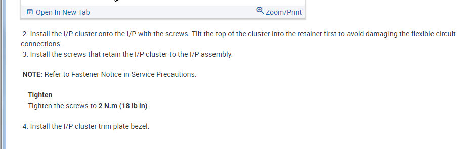

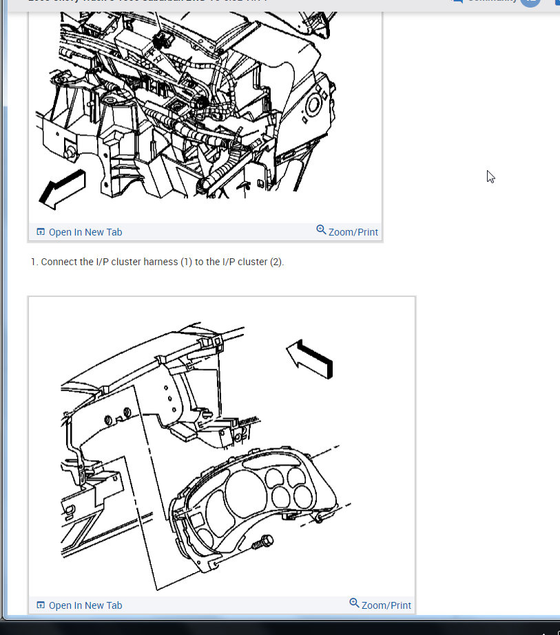

The cluster appears to need to be replaced.

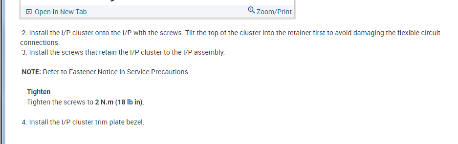

This is not a large repair so it is not that bad. I included a video on how to replace the cluster so that it will make the repair easier for you.
https://youtu.be/_HEC44xENxw
Run through this and let us know if you have questions.
Also, I attached the info from the manual that will help get this replaced. Thanks

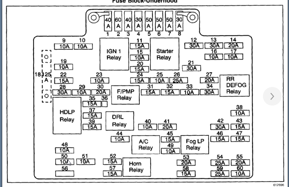

A bare wire somewhere shorted out and blew a fuse. In the engine compartment there is a large fuse box.Remove the cover and check the 50 amp fuses on the top row,one of them has blown. Find and fix the bare wire or this will happen again.

Are we talking about the chevy suburban 2002 or the pickup truck. refuring to the 02 suburban,you have blown a fuse somewhere.Did you check all of the 50 amp fuses? by taking them out and looking to see if the contact was burnt? In the engine compartment on the drivers side there is a large black box like component with writing on the top that says Electrical center. Remove that cover and you will see about 45 or 50 fuses. On the top row there is 8 fuses1-60 amp 3-50 amp 2-40 amp and 2-30 amp,One of those fuses has blown most likely the 50 amp one.You have to check these fuses by removing them one at a time and looking at them.If these fuses are good then the short is still active and keeping one of the relays open.look for the short at the wires below the emergancy brake,going up thru the dashboard Do you know when this problem started did you step on the emergancy brake real hard and it started the problem Try to remember how it started did you install any new components,look for the short there.Let me know how you make out

i double check the fuses in the engine compartment and i found that a 50 amp fuse was blown. and i found the wire that blew the fuse under the dash thanks alot

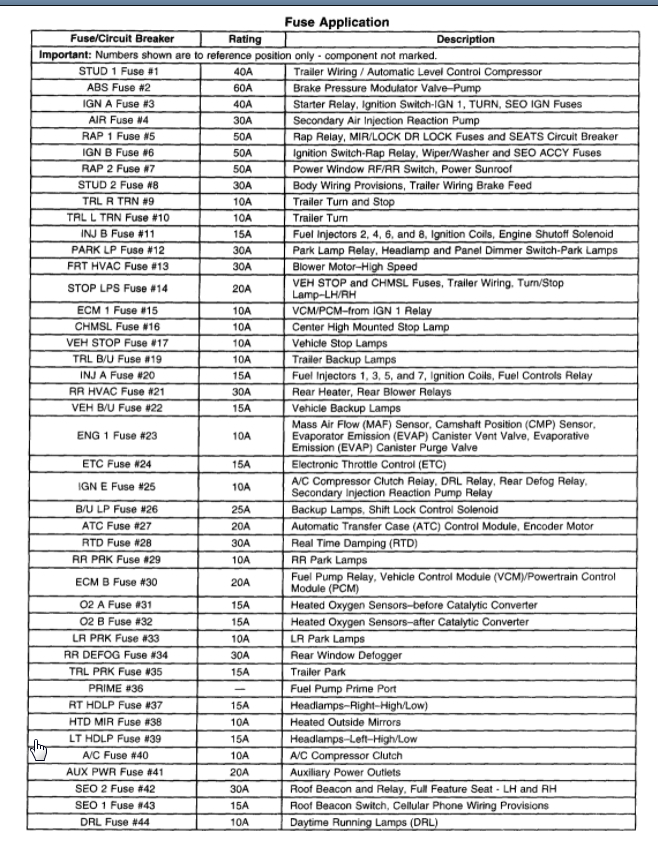

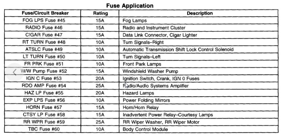

Please see the info below of the fuse block. This will help others with which fuse was the possible cause.
Please let us know if there is anything we can help with in the future. Thanks
