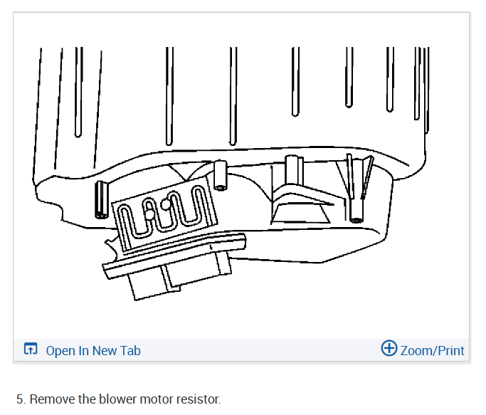

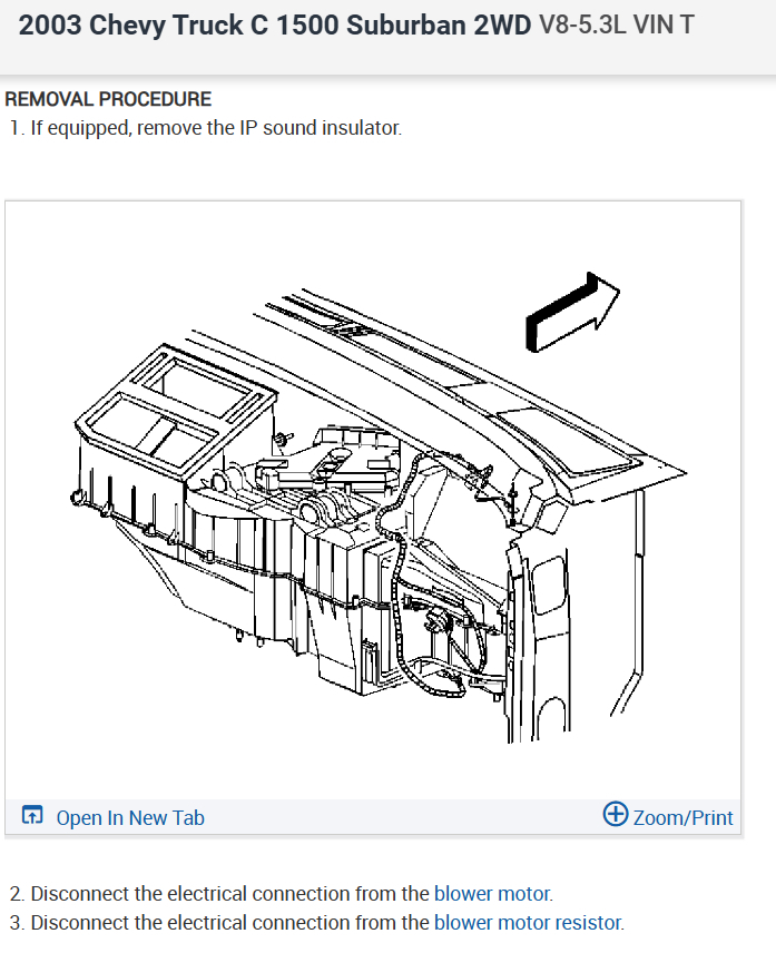

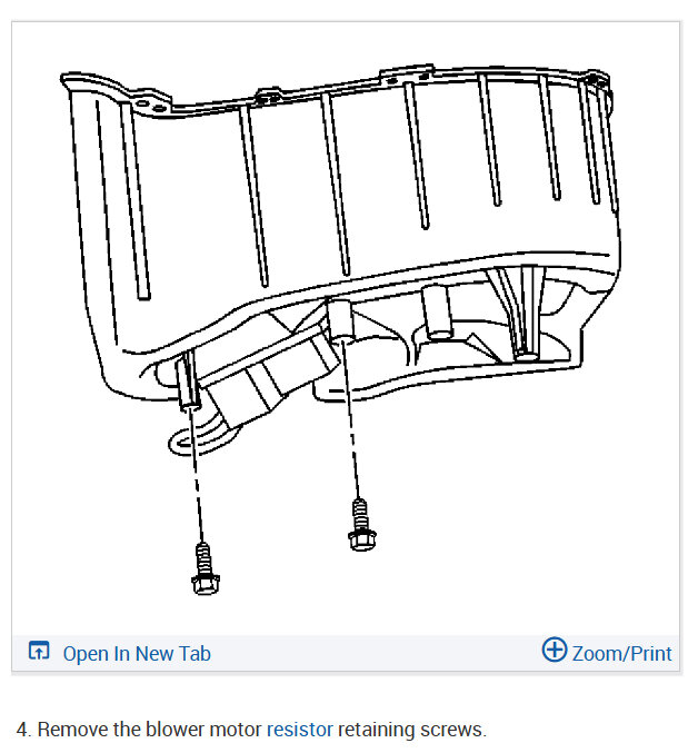

The blower fan on my 2003 suburban only works on high speed. I suspect the blower motor resistor to be the problem. Where is it located and is it easily replaced?
