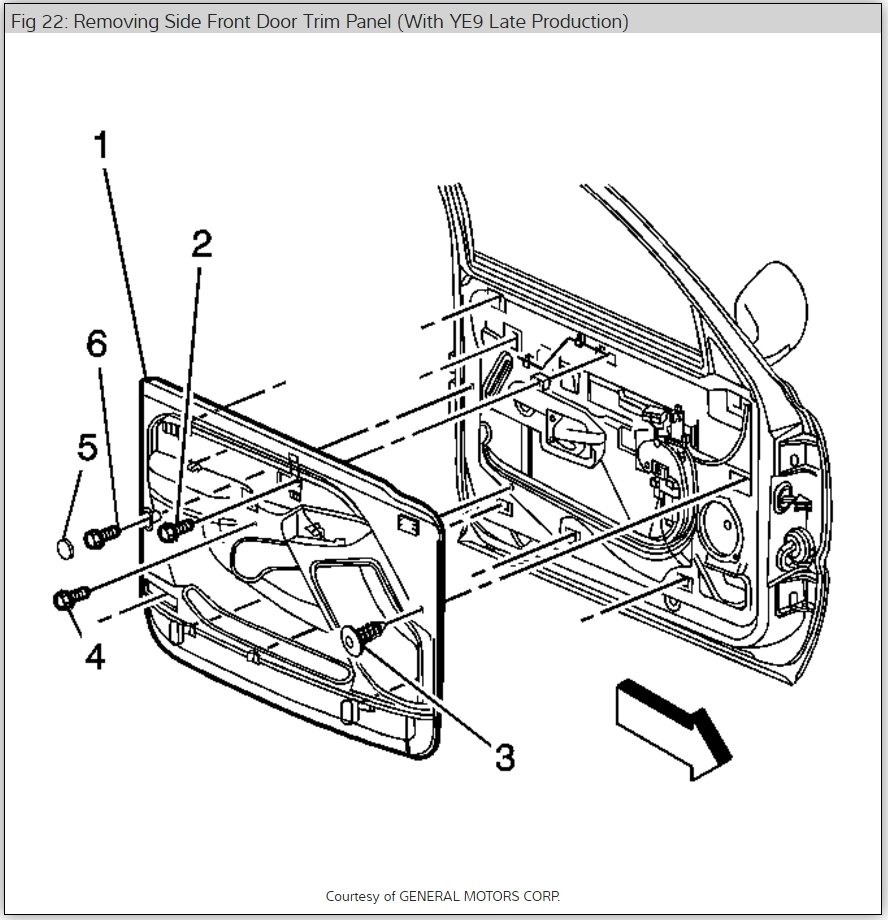

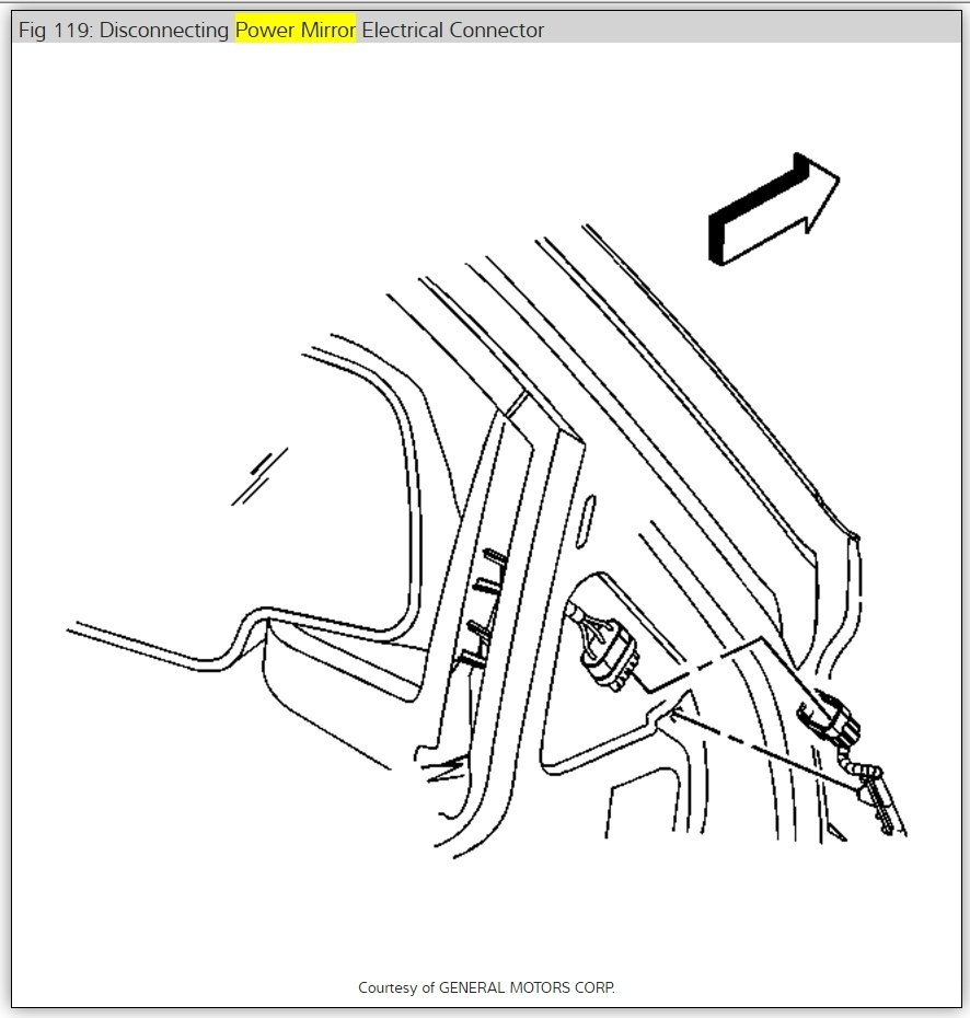

You must start by removing the door panel which we have a guide for below, Then undo the wiring connector and while holding the mirror with one hand undo the mounting bolts.
https://www.2carpros.com/articles/door-panel-removal

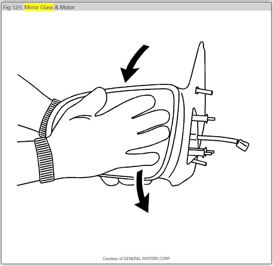

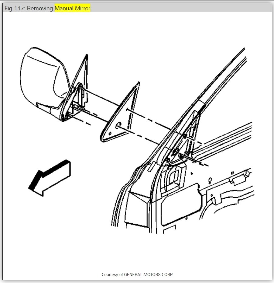

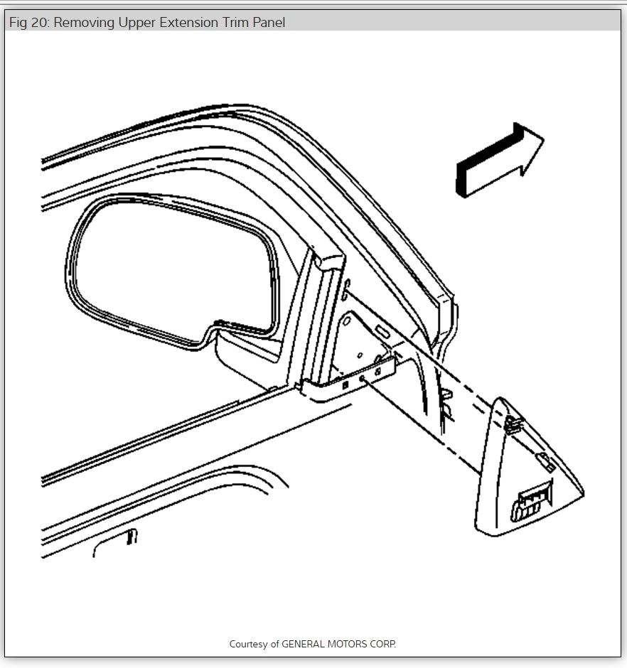

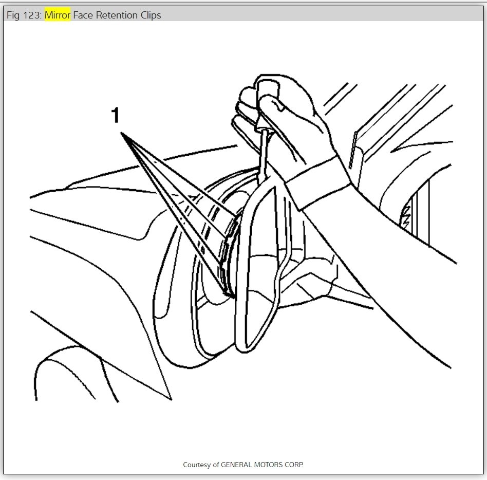

Here are some diagrams to help with the job.
