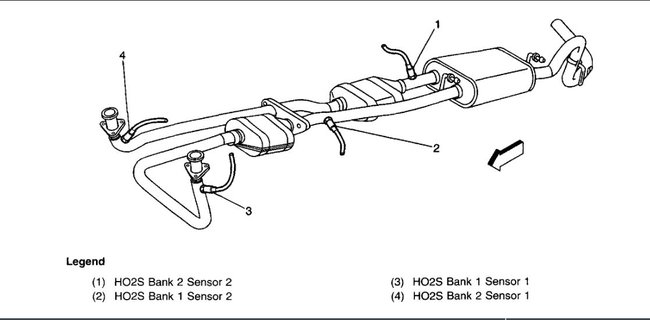

If after replacement of sensors and the problem recurrs, the next thing to do would be to check the wirings. Here are the diagnostic procedures.
