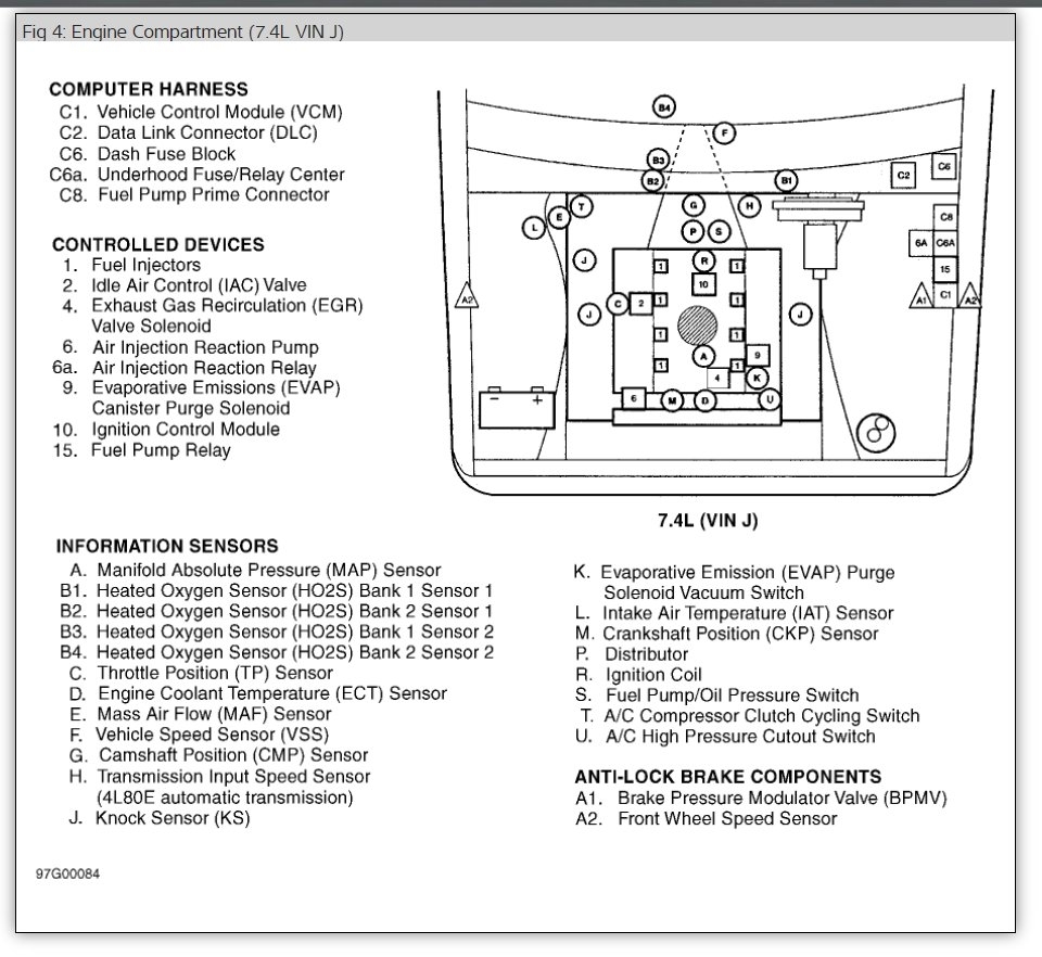

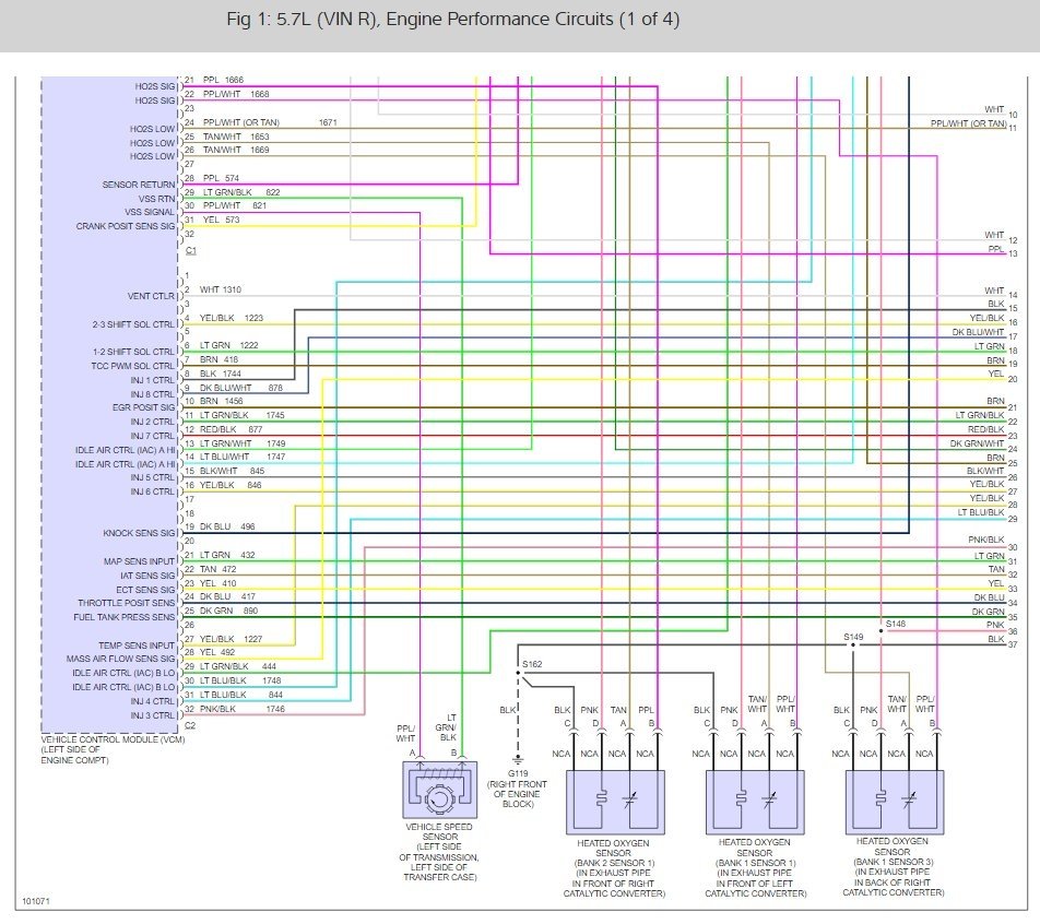

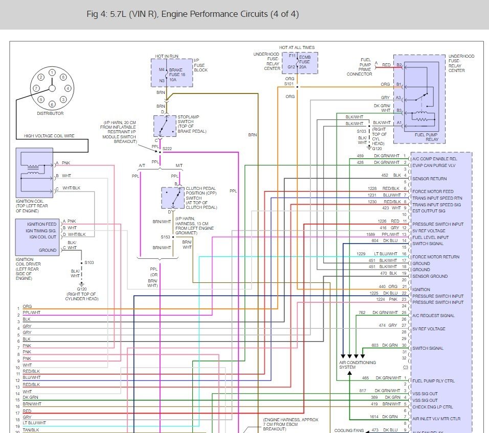

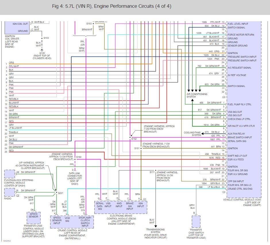

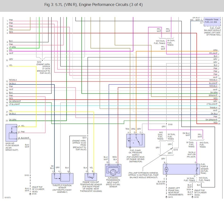

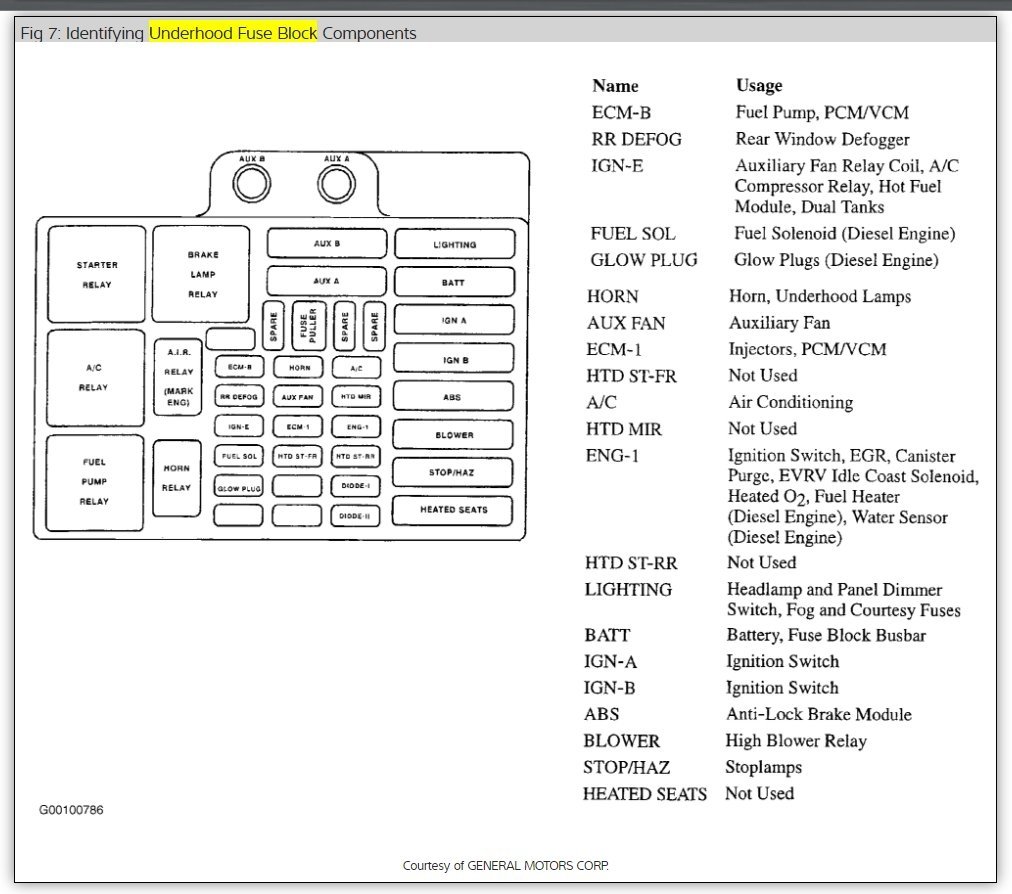

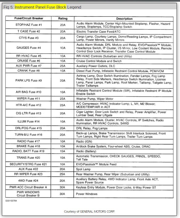

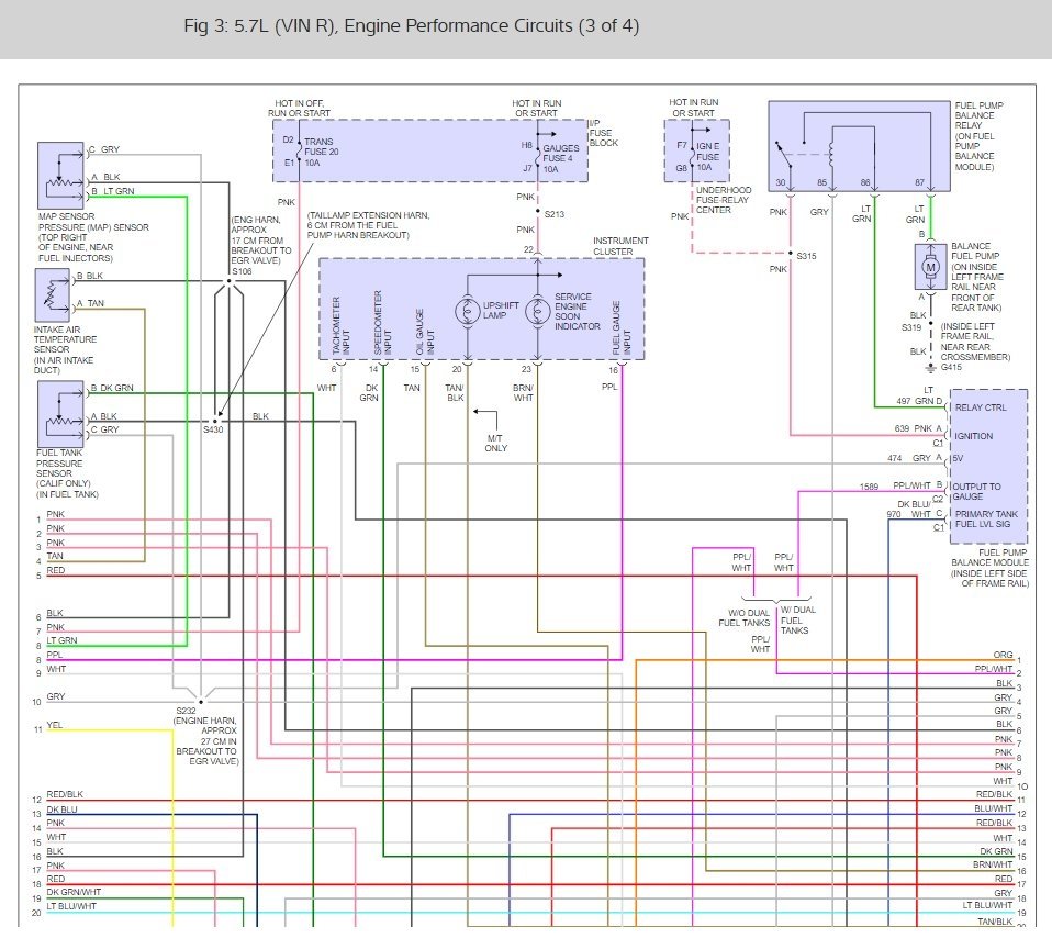

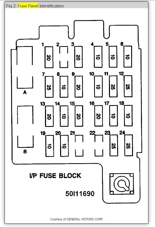

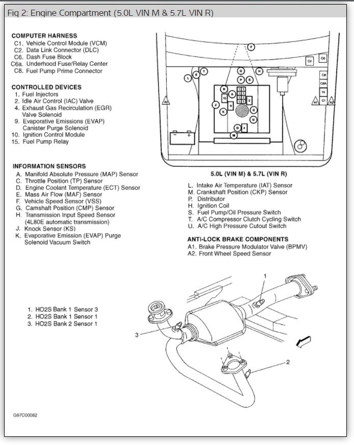

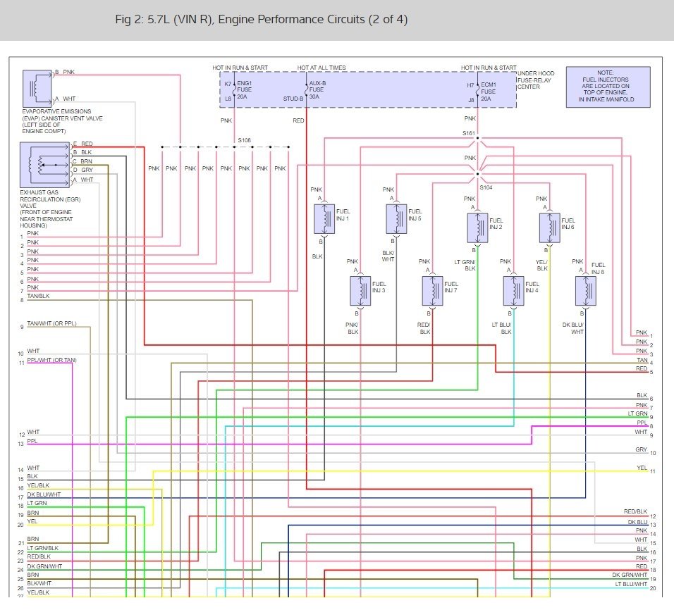

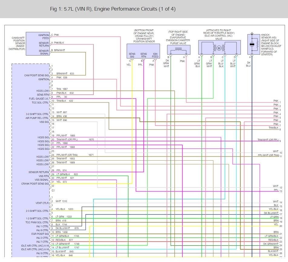

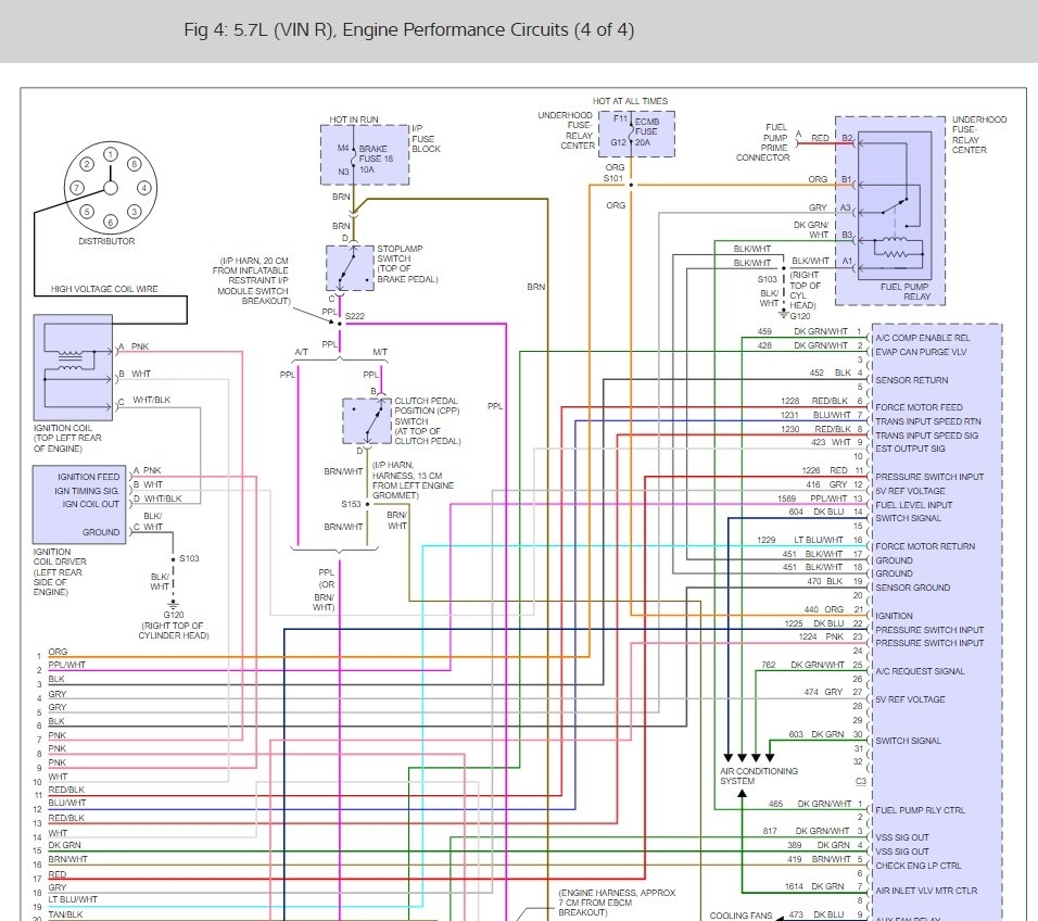

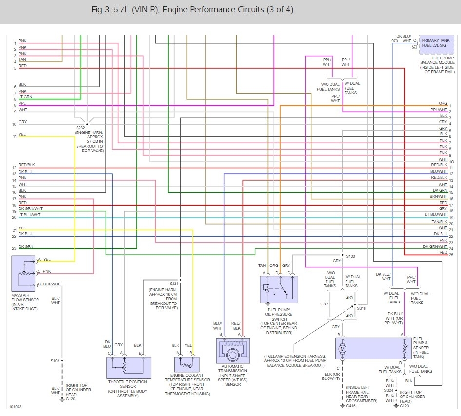

It sounds like the fuel pump relay is not working or there is a power supply issue. Here are some guides to help you test for the problem along with a fuel pump wiring diagram (below). Test to see where you are loosing the power from.
and
I gave you all of the engine wiring diagrams in case it could help.
Please run some tests and get back to us so we can continue helping you.
