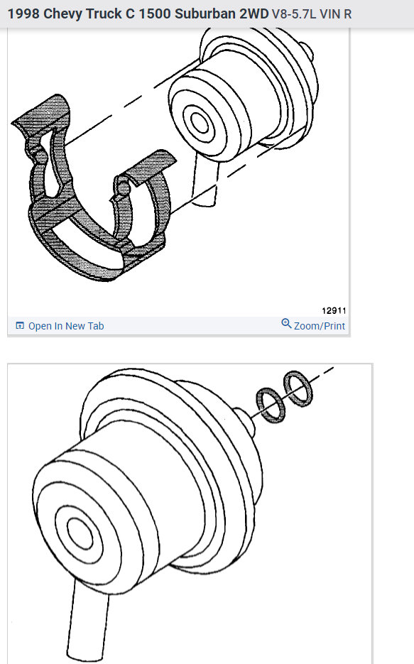

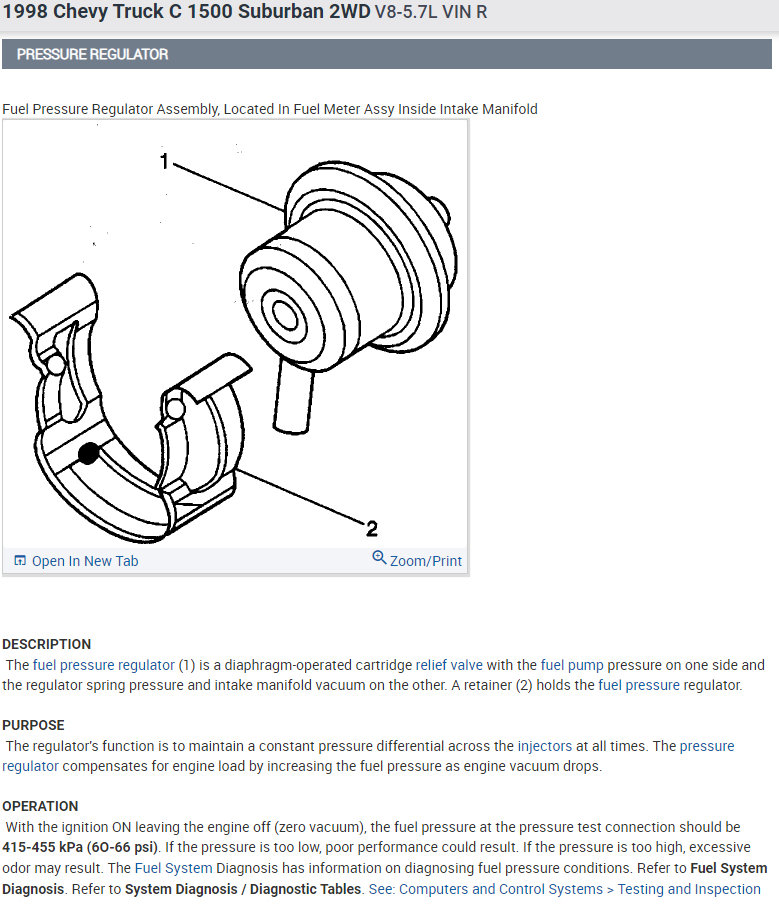

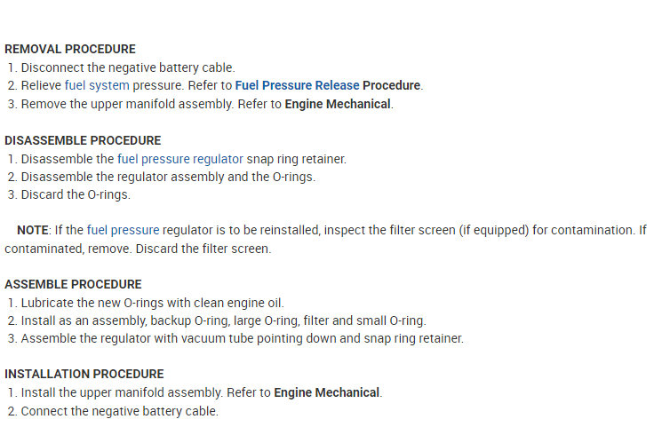

I have attached the diagrams for your reference.
