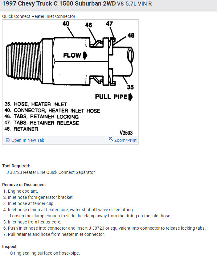

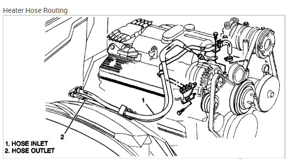

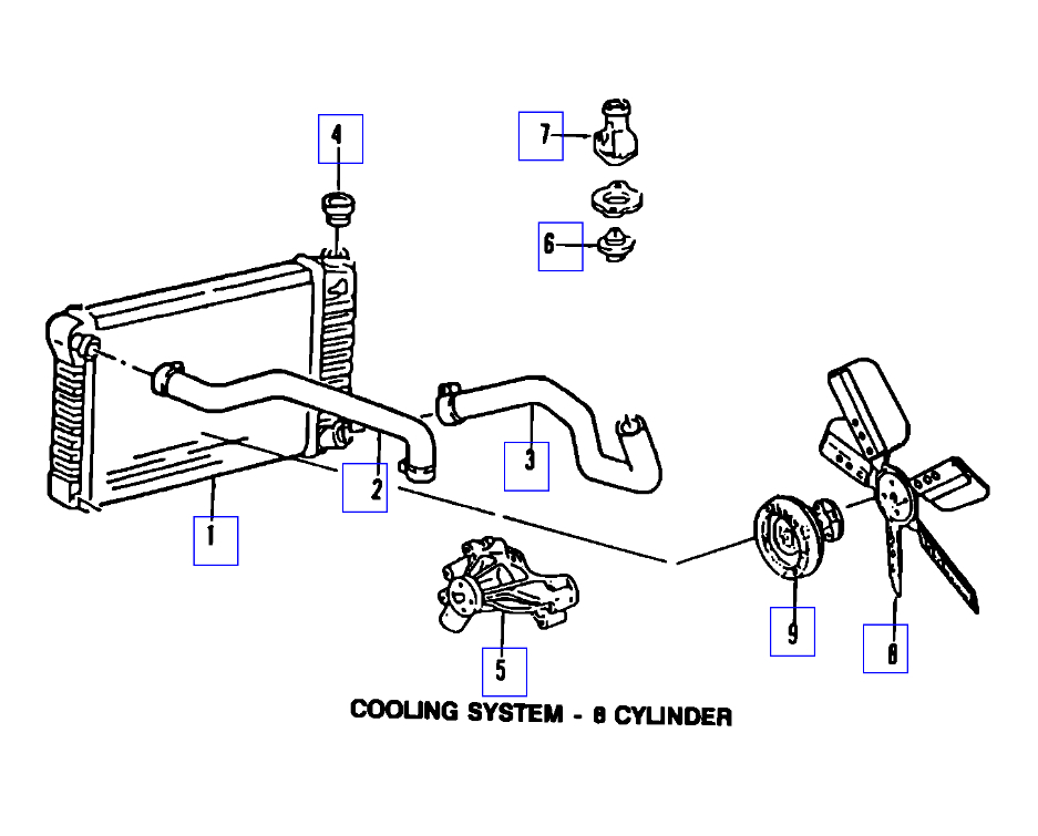

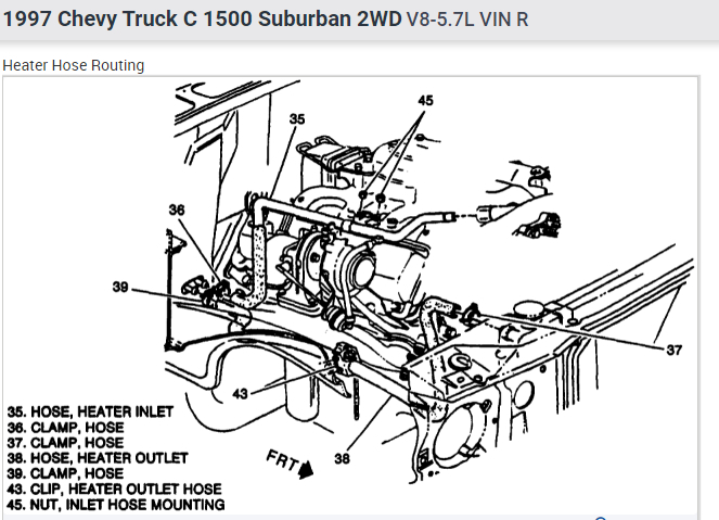

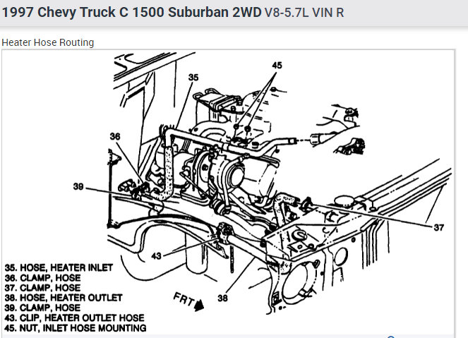

I need a diagram of the routing for the cooling lines. I have a leak and the plastic connections all broke when I attempted to remove them. I now need a diagram showing the routing around the heater valve.

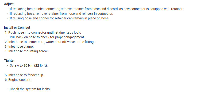

I have attached the diagrams for the heater hose and cooling system.
Those heater hose connectors are a very common issue with these vehicles.
Replacement can be found very easily at your local parts store.
