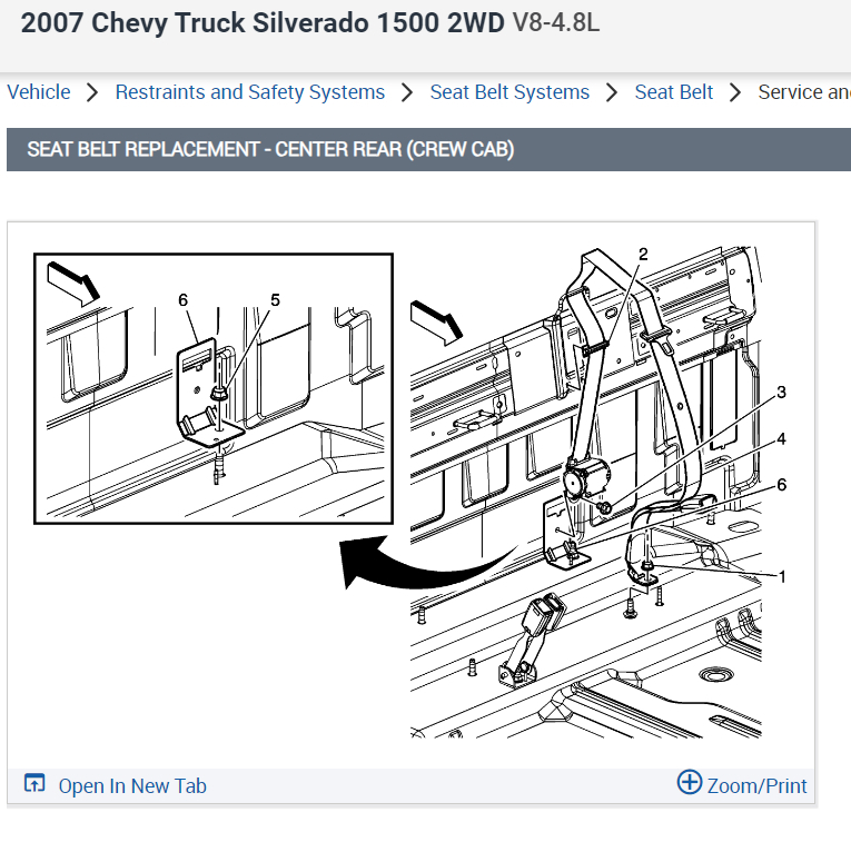

Try moving the seat, or the seat recline to back of tension on belt.
Mark (mhpautos)
Nov 29, 2007 at 10:45 PM

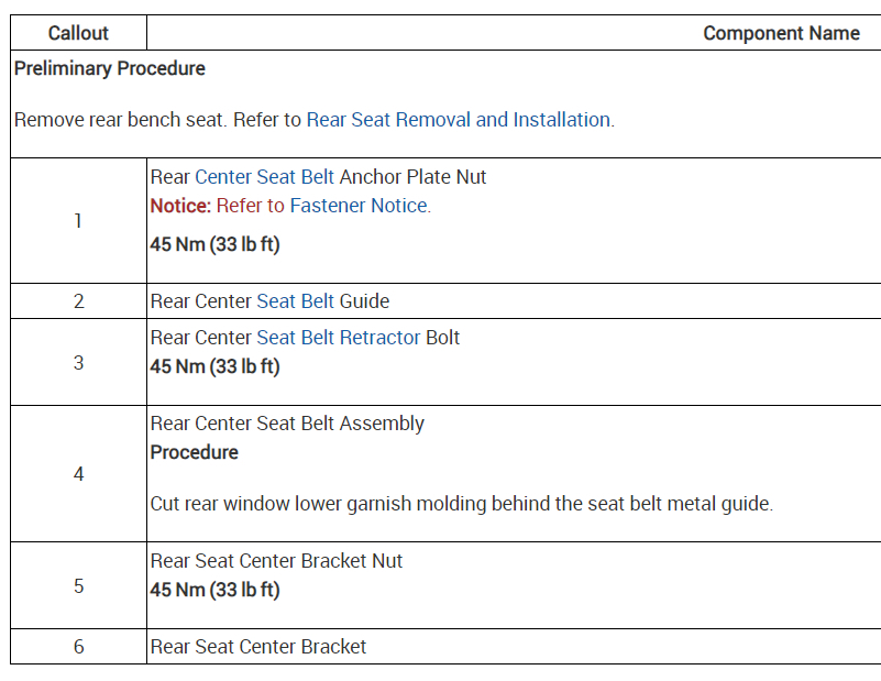

Sometimes the seat belt will just need to be replaced, there are non-tamper proof parts so they can not be repaired. Here is how to replace it. Check out the images (below). Please let us know what happens.
