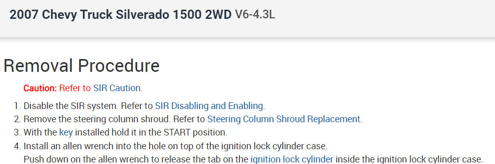

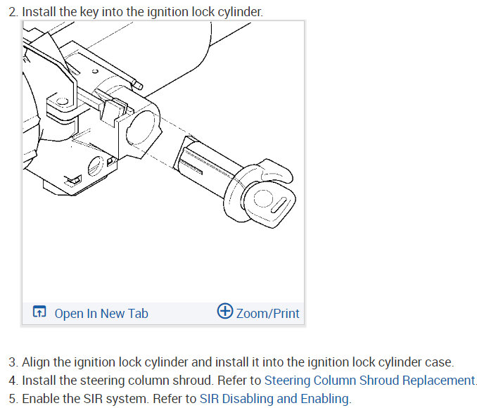

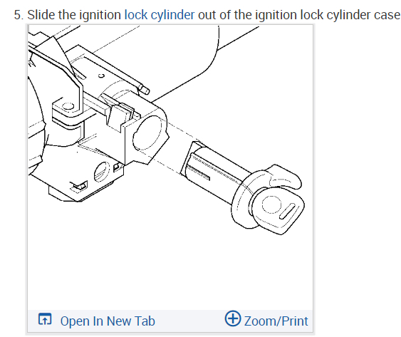

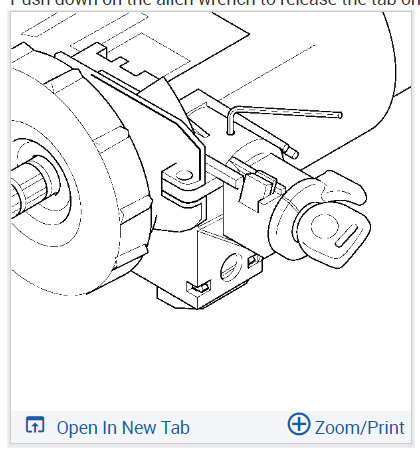

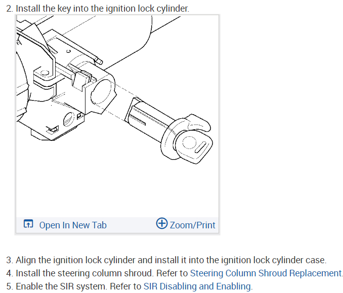

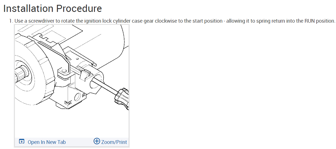

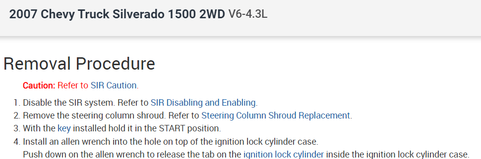

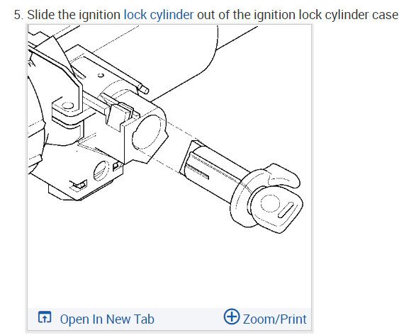

Yep, the ignition lock has fallen apart internally which is common, here is how th change the key lock out, I would get the replacement from the dealer so they can code the lock for you before installation. Here is how to change the lock for the key out. Check out the images (below). Please let us know what happens.
