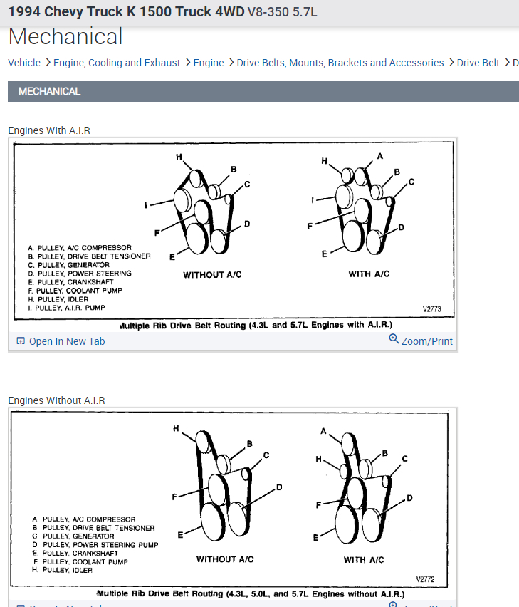

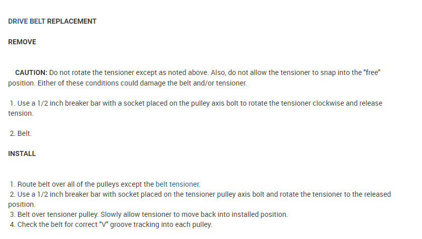

The replacement of the serpentine belt on this truck is straight forward and can be done in a short period of time.
Before removing the belt make sure to understand the belt routing, you can draw the routing or take a picture.
Use a breaker (ideally a 1/2 inch) bar with a socket placed on the pulley bolt and turn it clockwise this will release tension to remove the belt.
Here are couple of helpful articles:
https://www.2carpros.com/articles/how-a-serpentine-belt-works
https://www.2carpros.com/articles/replace-serpentine-belt
I have attached the belt diagram as well as the replacement procedure below.
