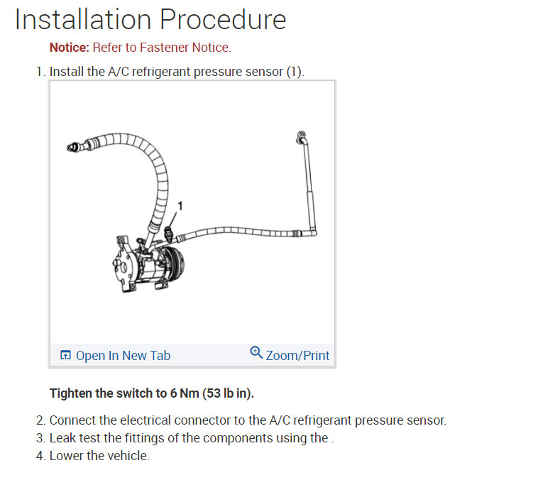

Received a Engine Hot A/C turned off DIC message. Engine did not appear to be hot. Temp guage was at 160 degrees and the A/C was not running. Possible theromastat issue? This seems to be a known issue 'cause I see several post on the message. However; I don' see a clear resolution. Do you have a solution? Thanks for your help!
Mar 2, 2010 at 8:49 AM
This can happen when the AC system is over charged which will trip the high pressure sensor for the system causing the AC engine hot warning. Here is a guide to help you with the problem.
Mar 3, 2010 at 8:08 AM

I am getting a message on my dash that say "Egine Hot, A/C Turned Off". My temperature guage does not seem to work, Both auxillary fans by the radiators run continuously. This message appears even after sitting 12 hrs in sub freezing temps.
Jun 1, 2021 at 6:27 PM (Merged)

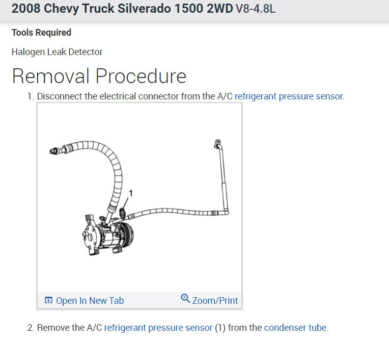

tis happens when the AC pressure sensor goes out, here is the location so you can replace it. Check out the diagrams (Below). Please let us know what happens.
ESTILL
yep this was the problem for my truck, thanks.

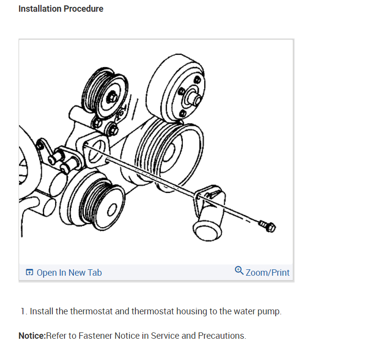

I was on my way to work this morning when i heard the warning bell in my pickup go off i looked down and saw the message engine hot / ac ( air conditioning) turned off. I pulled over open the hood and looked around the the engine at the belts, water reservoir, water pump & hoses and did not notice anything out of place so i got back in the truck and looked at the gauges i noticed that the temp gauge needle was laid over not showing any increase in temperature at all so i took one more look under the hood and still saw and heard anything strange so i my pickup back to my hove about 13 miles away and went on my way to work after work i took a look at my truck one more time under the hood and still did not see anything out of place so i turned my pickup on and notice the same warning message come up as soon as i turned it on i got a small hammer and banged on the thermostat housing a couple of times just to see if anything would happen but nothing did so i turned the truck back off and here i am hoping someone can give me useful information on the problem.
Thank you
Jun 1, 2021 at 6:28 PM (Merged)

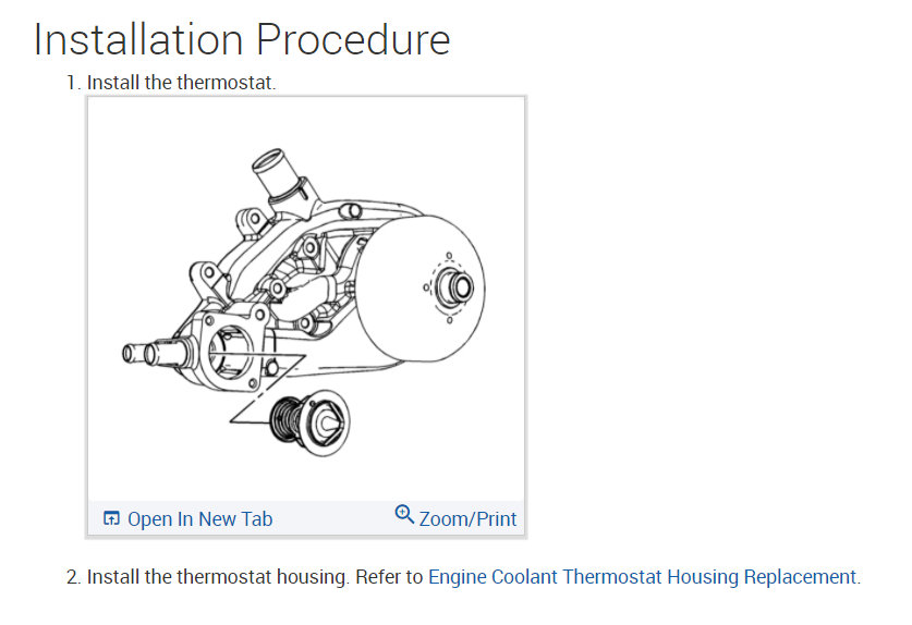

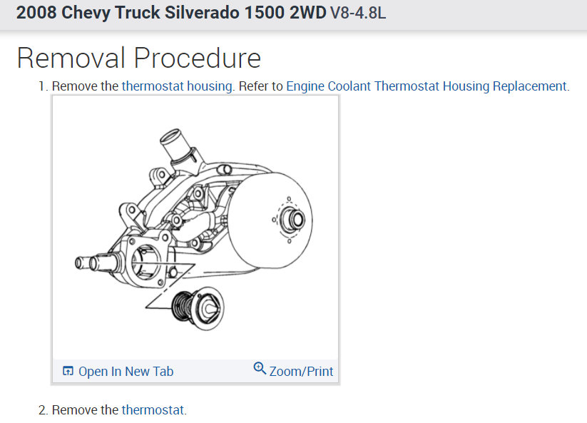

this will happen when the thermostat sticks closed. Here is a guide to help you step by step with instructions in the diagrams below to show you how on your car.
Check out the diagrams (Below). Please let us know what you find.

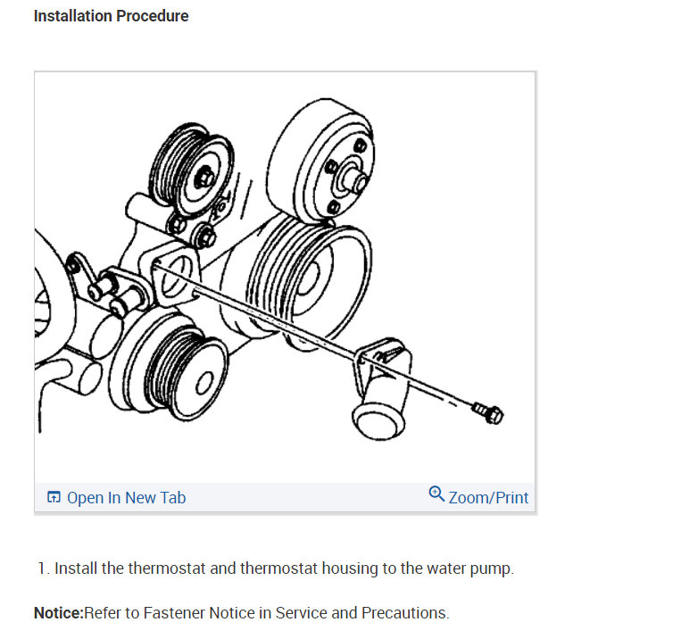

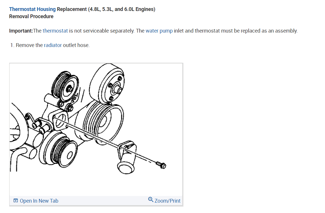

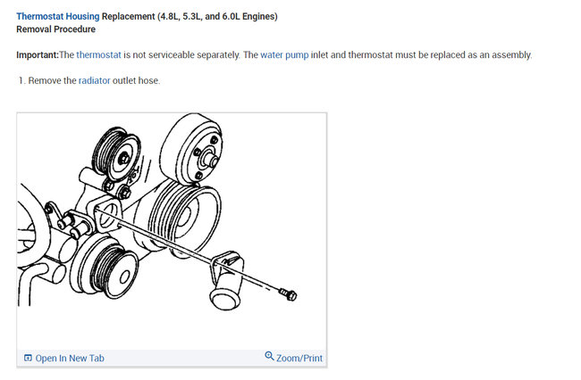

I would start by changing the thermostat. It may be stuck shut and not allowing ant coolant to circulate.
https://www.2carpros.com/articles/coolant-flush-and-refill-all-cars
I attached pictures and the procedure for you for the repair.
