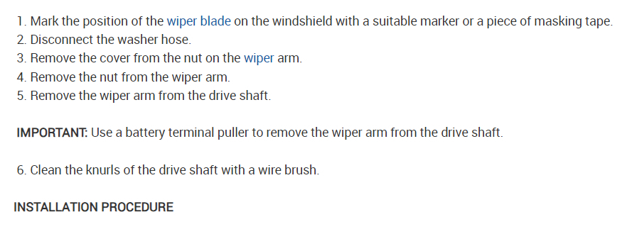

you can use a battery terminal puller to remove the arm.They can be purchased a your local parts store.

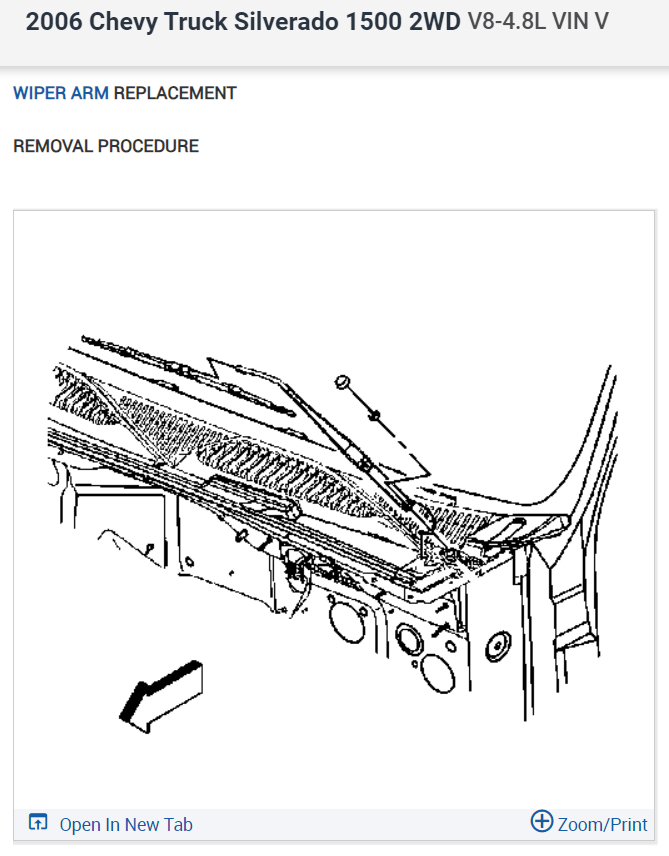

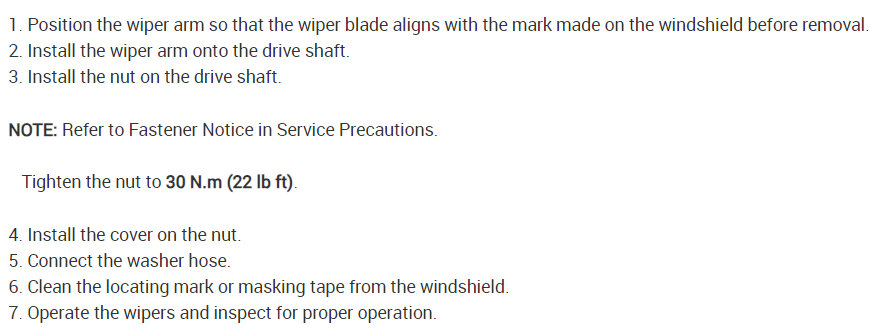

The arm pivot is a taper fit spline and must be lightened up correctly. Here are the instructions on how to do so. Check out the images (below). Please let us know what happens.
