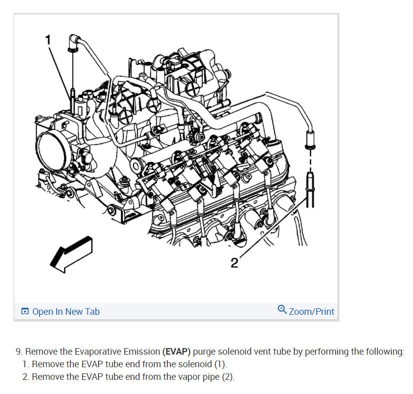

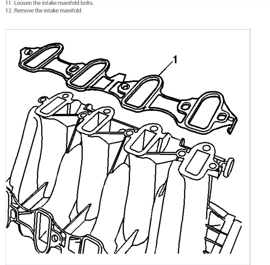

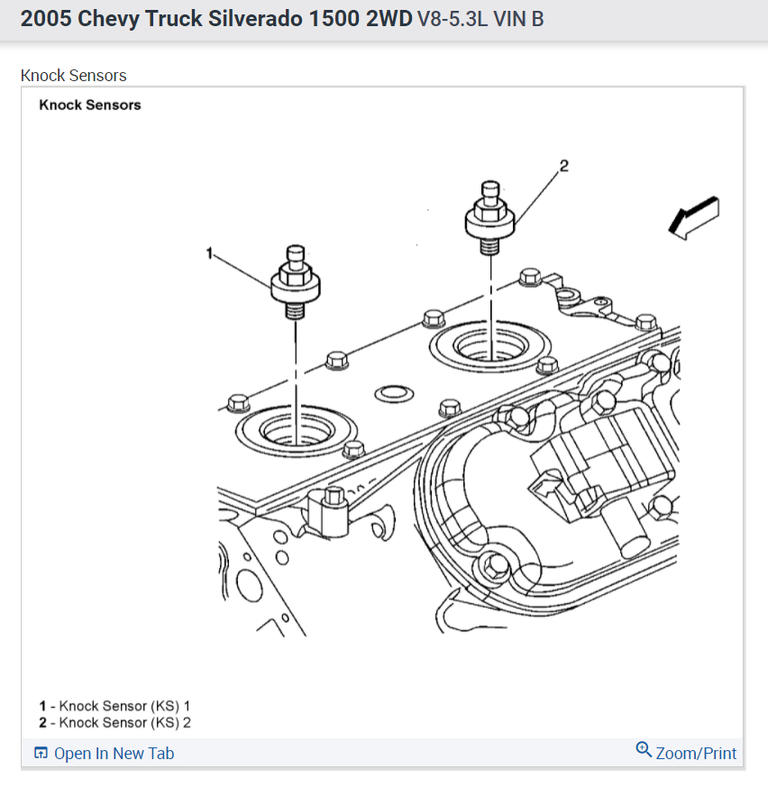

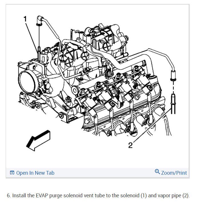

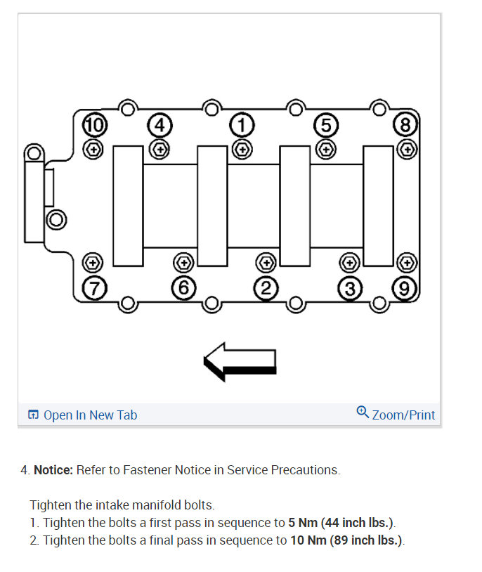

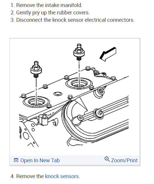

A troubleshooting engine light code indicates that the nox sensors are shorted. Where are these nox sensors located, how many sensors are required and what is the procedure for replacing these nox sensors? Thanks
