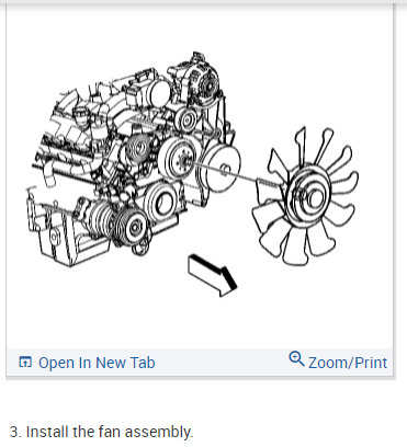

Temperature gauge fluctuates back and forth between normal 200 degrees for 5 to 10 minutes and 235 degrees for 5 to 10 minutes. I am suspecting thermostat is between sticking and unsticking and should be replaced or fan clutch is failing and should be replaced. I want to do the fan clutch first.

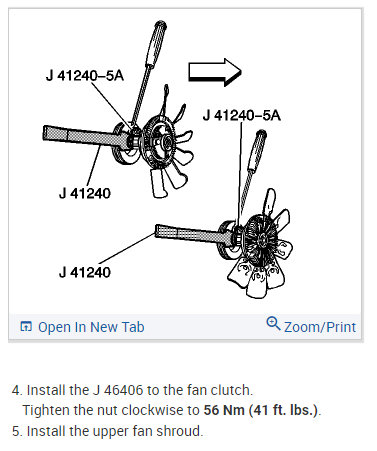

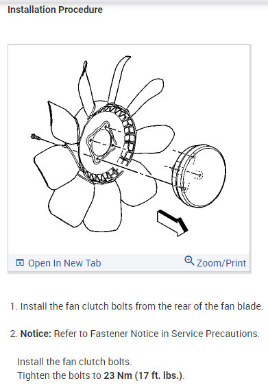

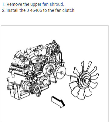

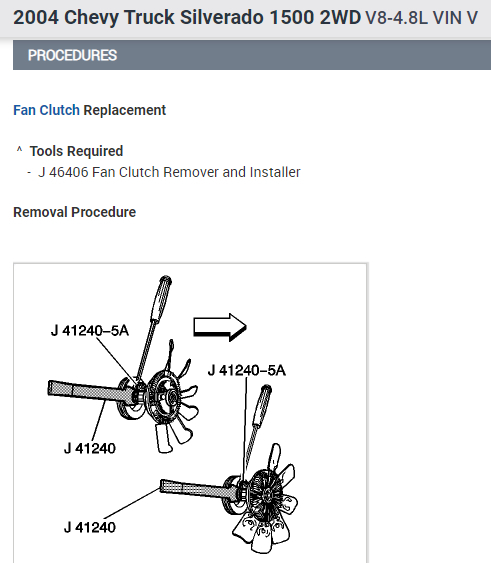

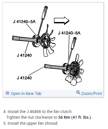

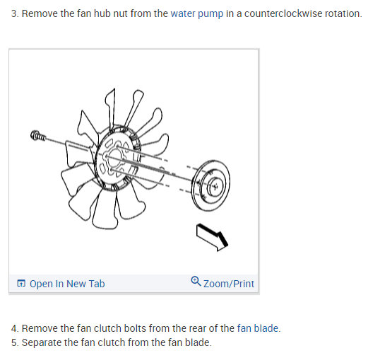

Here is the information you requested. Here are a few tutorials for you to view on fan clutches:
https://www.2carpros.com/articles/how-a-clutch-fan-works
https://www.2carpros.com/articles/fan-clutch-symptoms
https://www.2carpros.com/articles/fan-clutch-removal

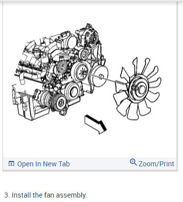

I've attached picture steps below on fan clutch replacement on your truck. Hope this helps and thanks for using 2CarPros.
