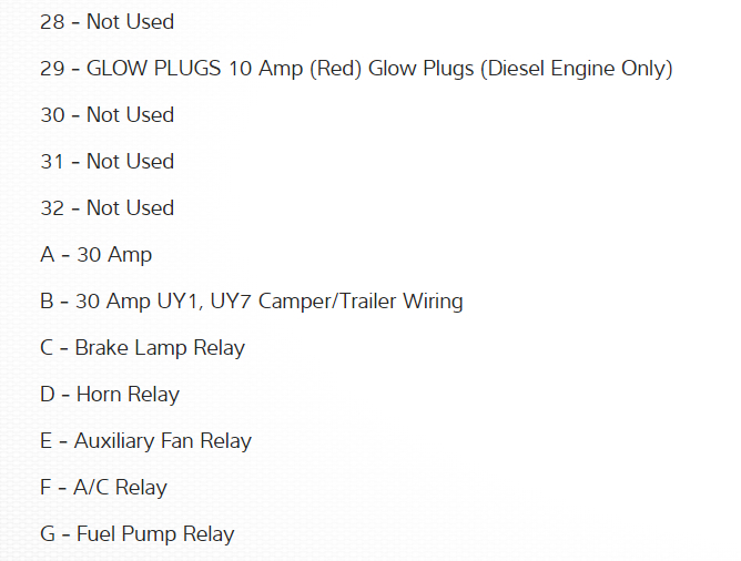

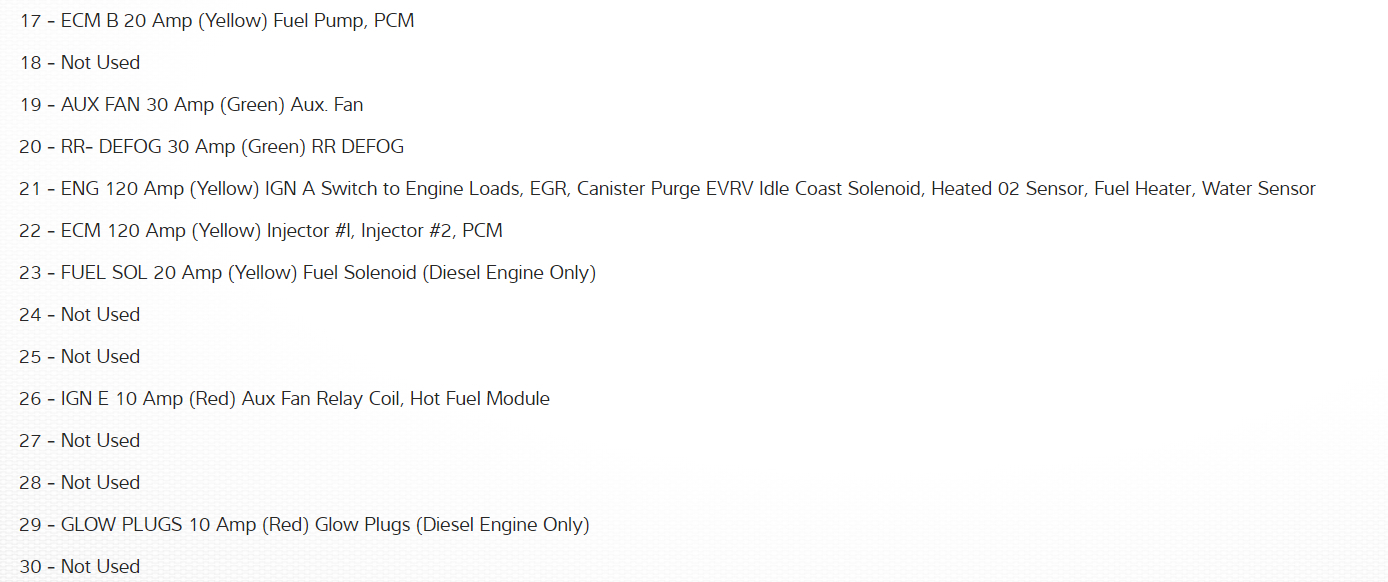

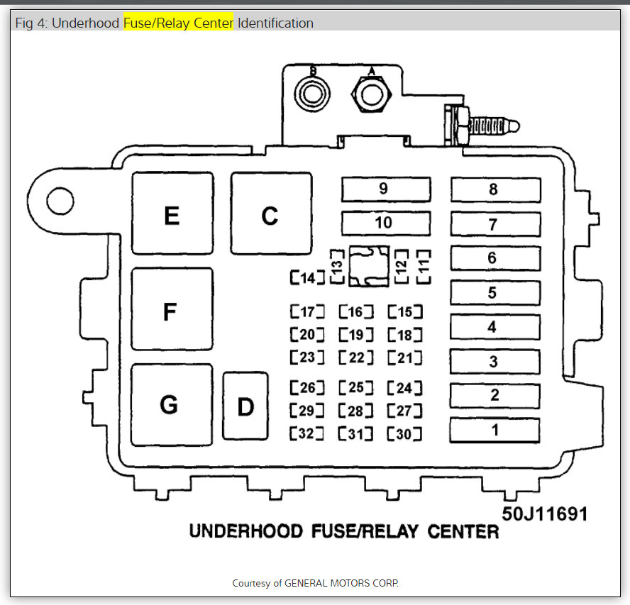

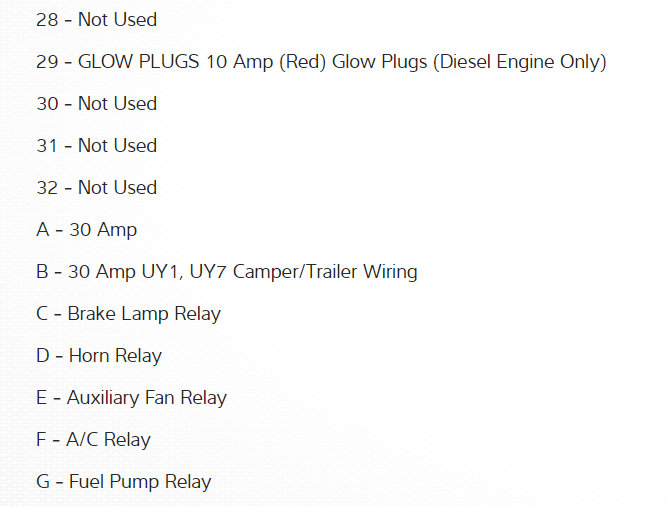

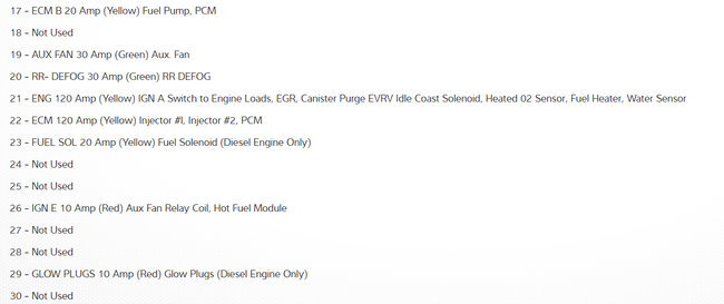

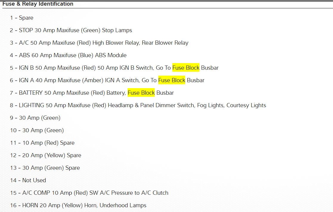

It sounds like the fuel pump relay (G) is not working here is the location so you can swap it out for a new one. Check out the diagrams (Below). Please let us know what happens.
