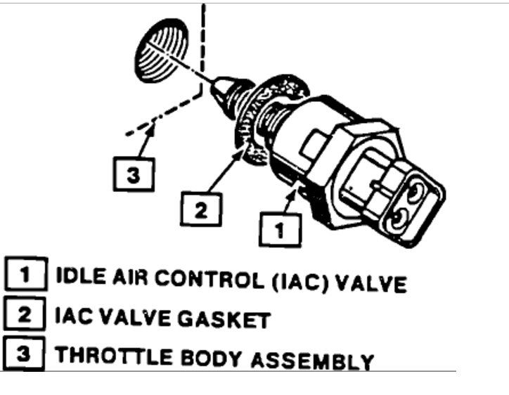

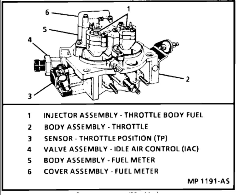

It sounds like you have a vacuum leak or the IAC motor needs to be replaced , here are some guides to help us get the problem fixed. These engine where famous for blowing the throttle body gasket out.
and
https://www.2carpros.com/articles/how-to-replace-an-idle-speed-control-motor-iac
Please let us know what you find.
