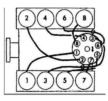

DANNY L
CERTIFIED EXPERT
5,648 POSTS
Hello, I'm Danny.
Here is the information you requested. I've attached a picture below of the firing and cylinder order. Hope this helps and thanks for using 2CarPros.
Image (Click to enlarge)

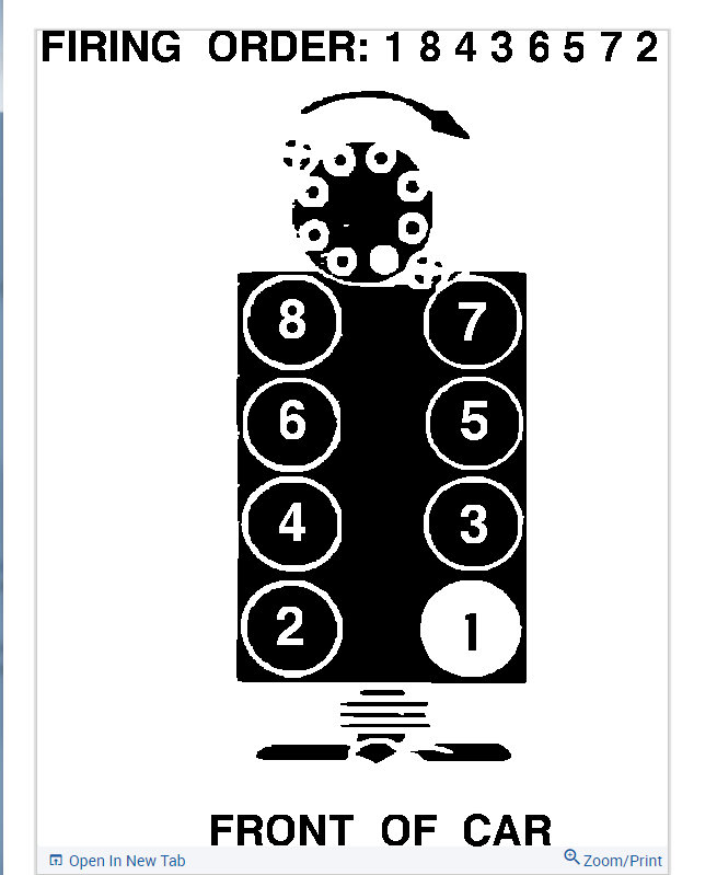

Mar 6, 2021 at 4:52 PM
CERTIFIED EXPERT
18,907 POSTS
Take a look at the attachment below for the detail on the firing order and positioning of the cylinders and distributor.
Let me know if you have questions. Thanks
