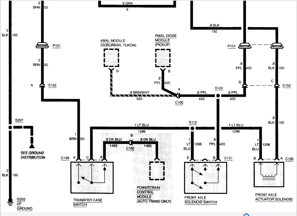

I engaged it to 4 wheel drive, and I felt it engage. But when I was on ice, the front wheels didn't spin. The light does not come on even when it is engaged. This is my first 4x4 and I don't know much about it. Any ideas what i need to make it work? Thanks.
Jan 26, 2010 at 7:44 AM
SCOTTY DEE
  • 592 POSTS

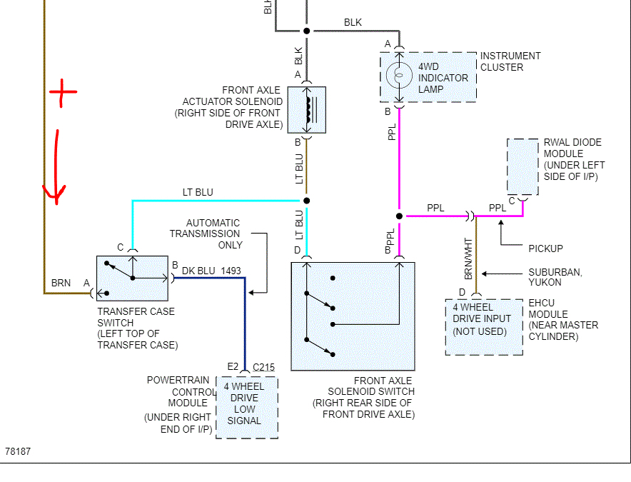

Check AC/HTR fuse first. Check for feed wire problem at transfer case switch, possible open. Also inspect wires to actuator, and inspect actuator for damage.
See the guide below on testing wiring
Wiring diagram for your 4wd system is attached below

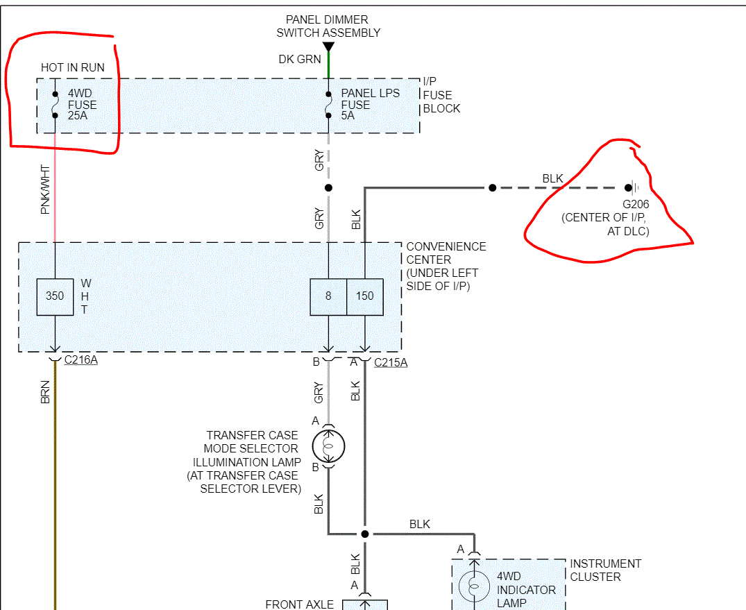

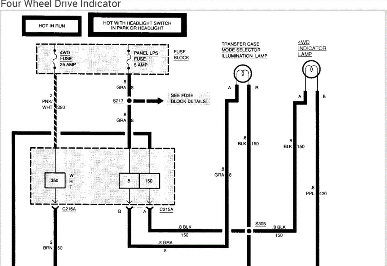

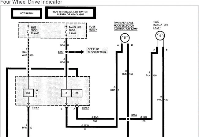

First, check the 4wd fuse to make sure it is good. In addition to just checking the fuse, make sure there is power to it. If that is good, there is a black wire coming from the actuator on the axle. Make sure it has continuity to ground.
I attached a pic below of the fuse and a portion of the wiring schematic. Here is a link you may find helpful when testing for power at the fuse:
Let me know. Also, if the fuse is good, I need to know if the 4wd light is turning on and if there is power to the actuator.

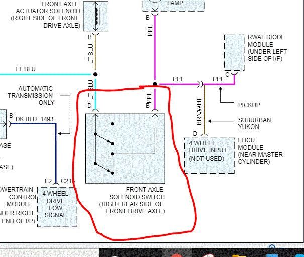

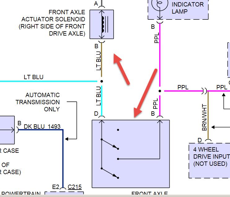

Check to see if there is power to the front axle solenoid switch. I attached a pic for you. You should have 12v to blue wire.

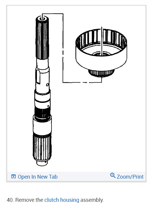

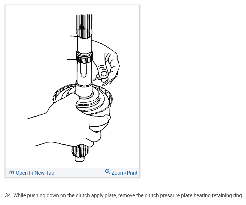

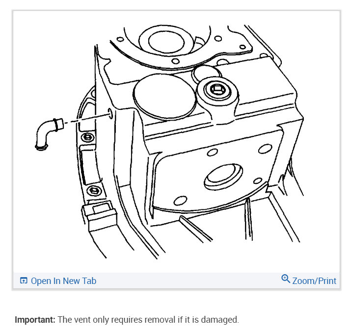

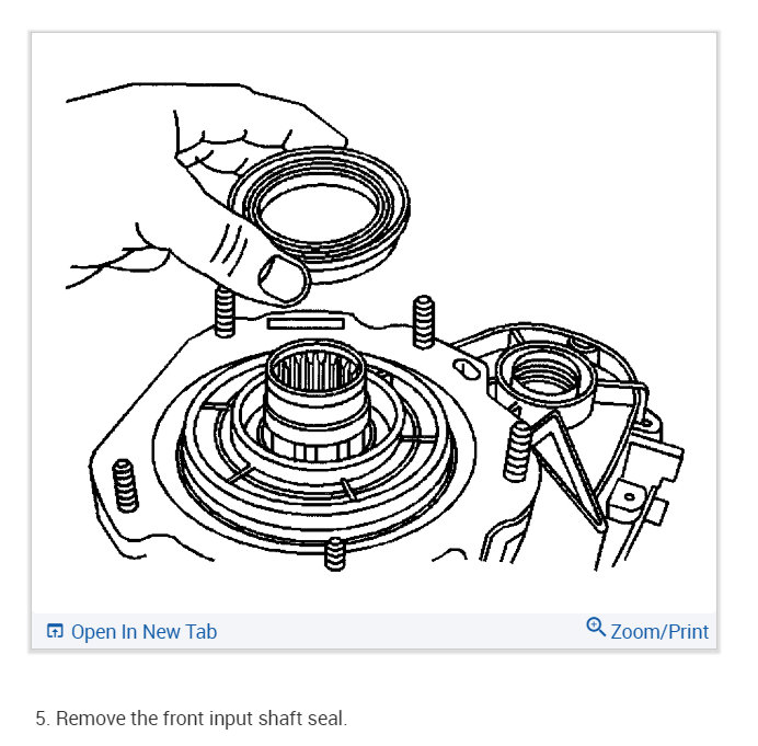

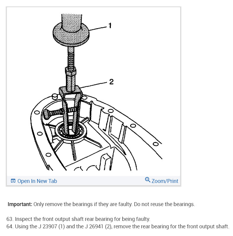

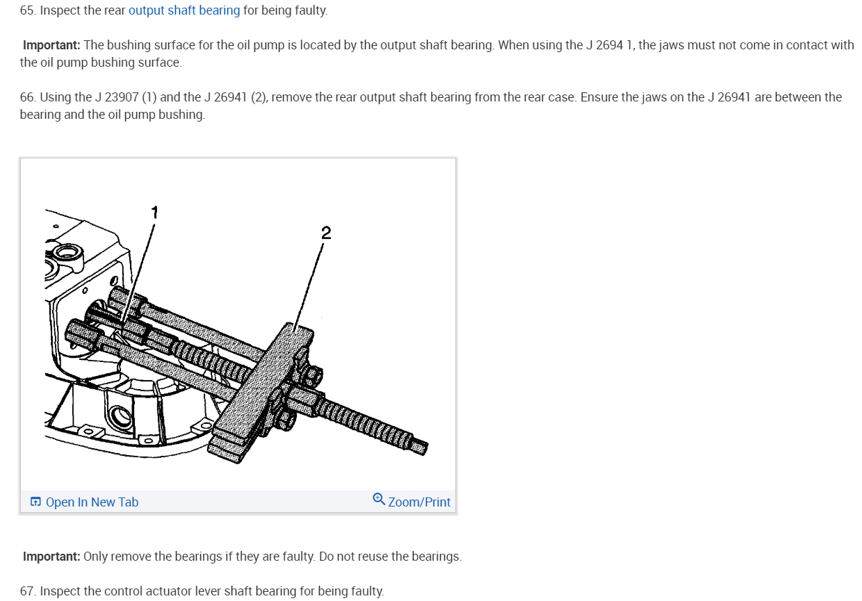

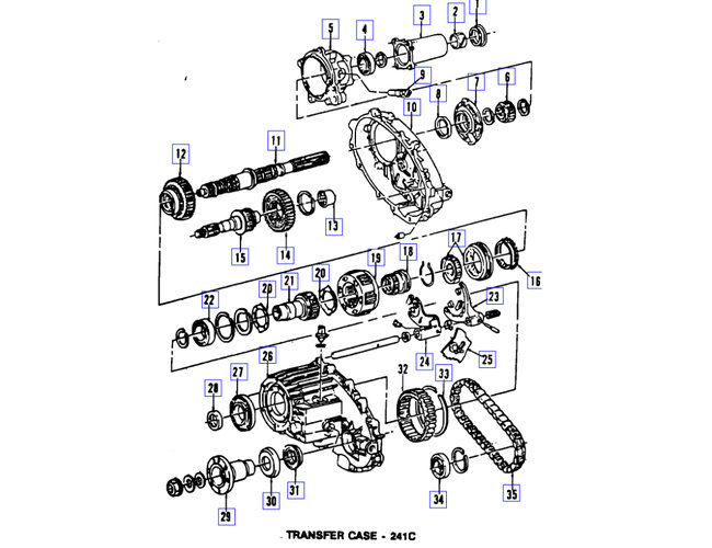

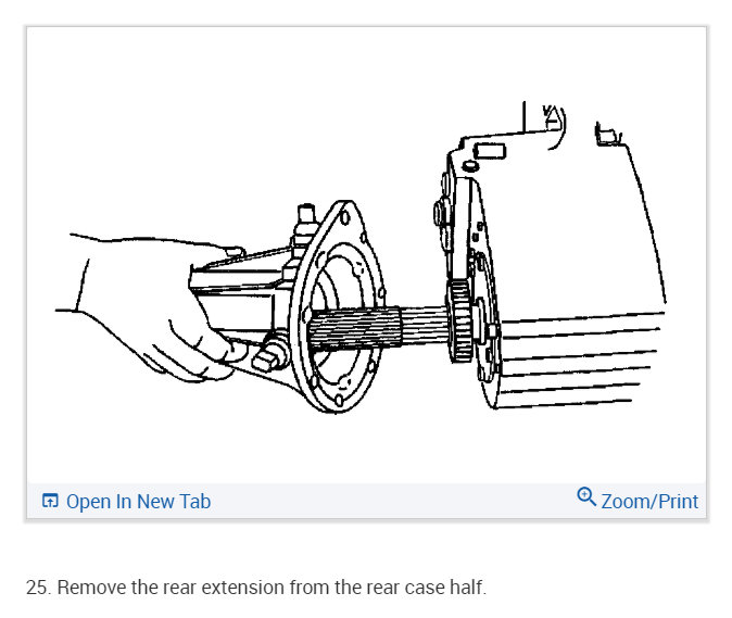

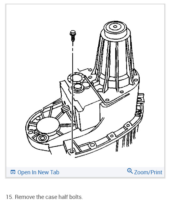

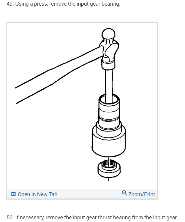

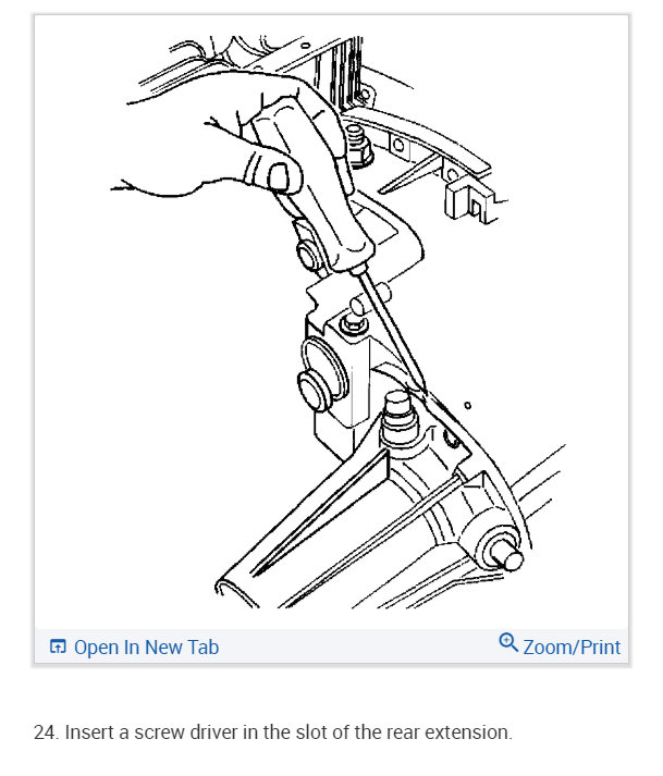

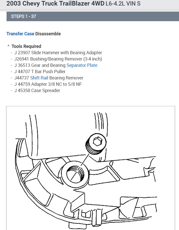

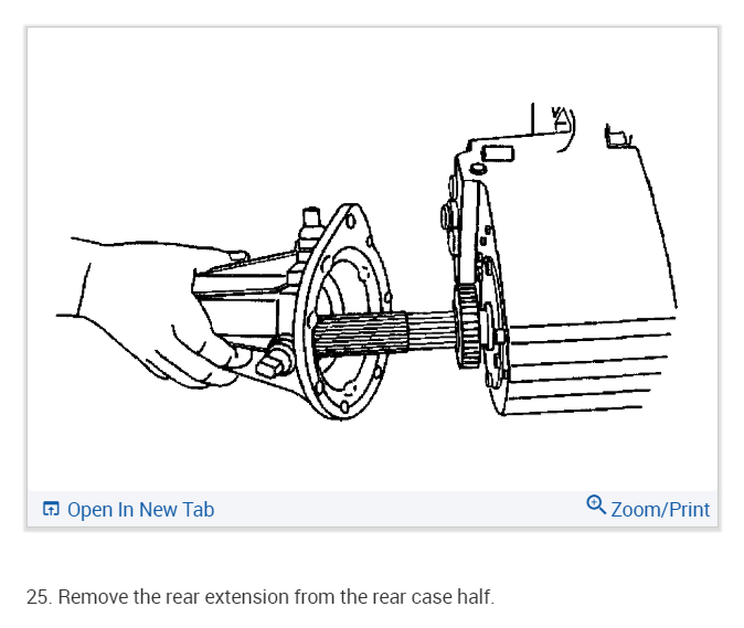

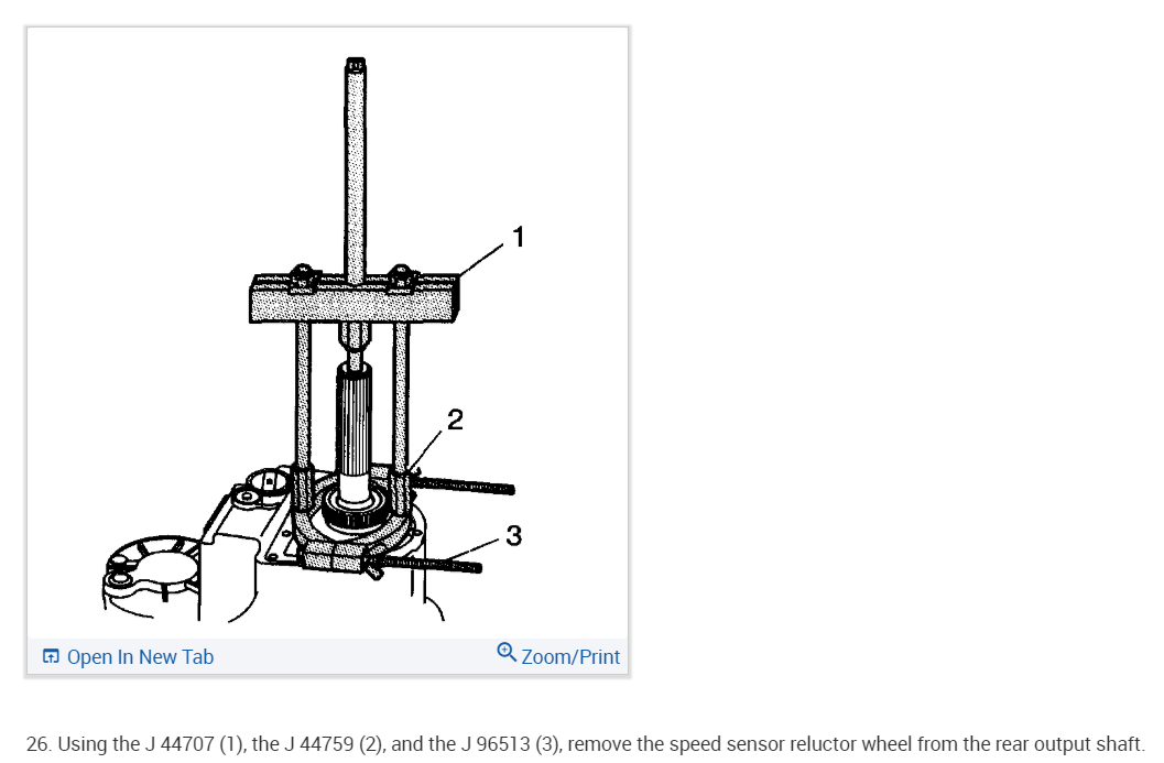

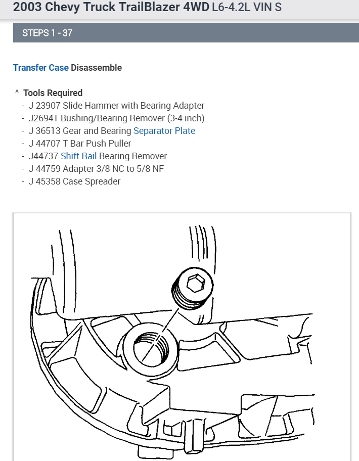

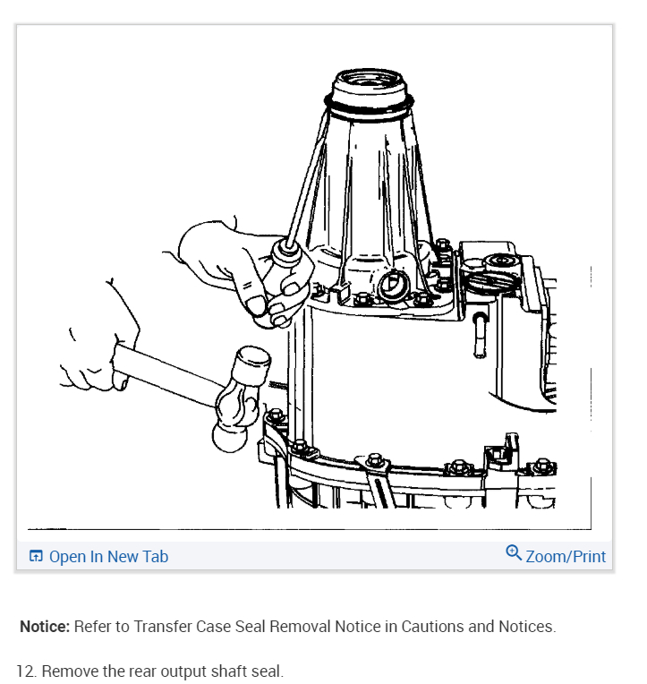

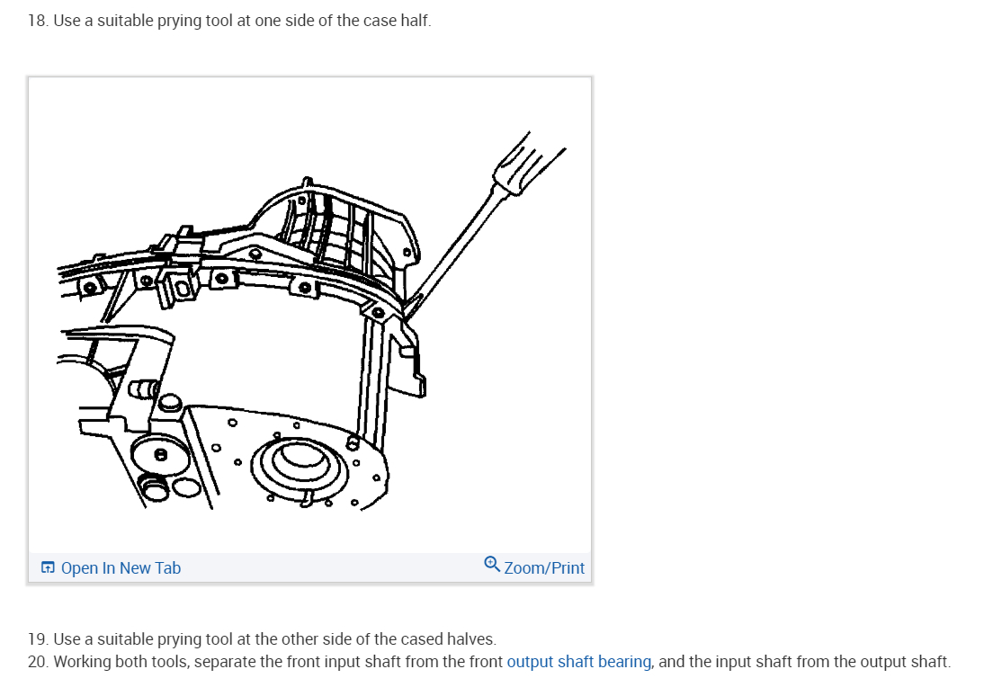

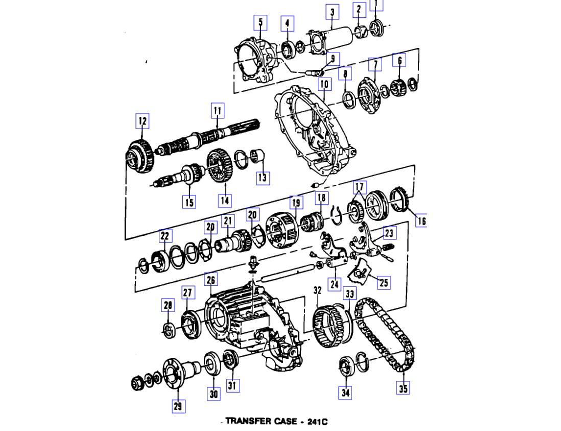

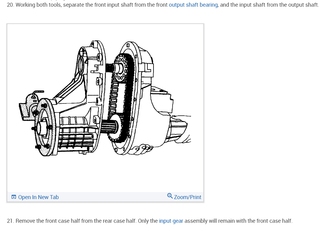

Truck had sat all summer and the front wheels had frozen in the dirt, tried breaking it free in four wheel drive, heard a bang and rear wheels spun but not the front. I got it pulled out with a tractor, and now four wheel drive does not work in 4H or 4L, works and drives fine in 2H. also the 4x4 indicator light on the floor comes on when I shift into 4x4, but only have rear wheel drive.
Sep 2, 2020 at 10:54 AM (Merged)

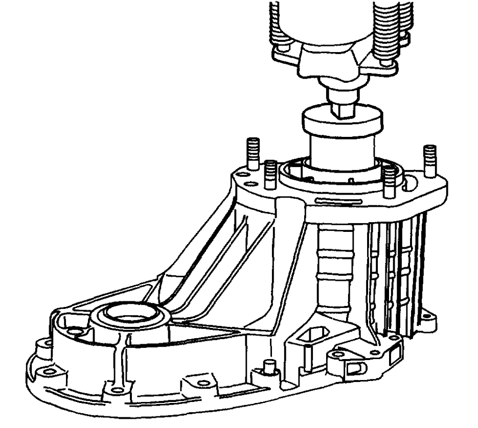

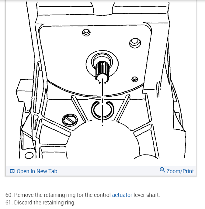

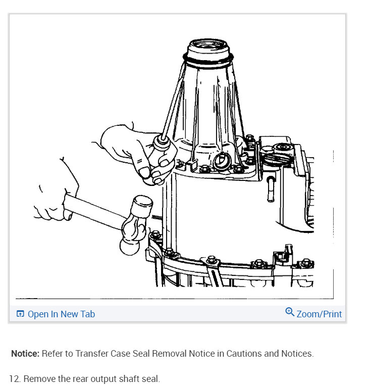

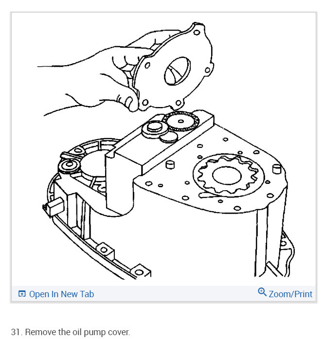

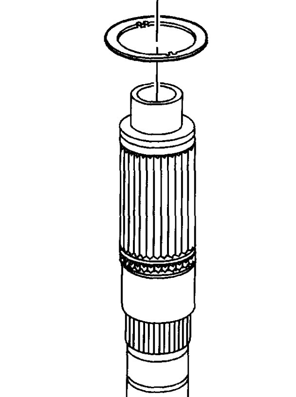

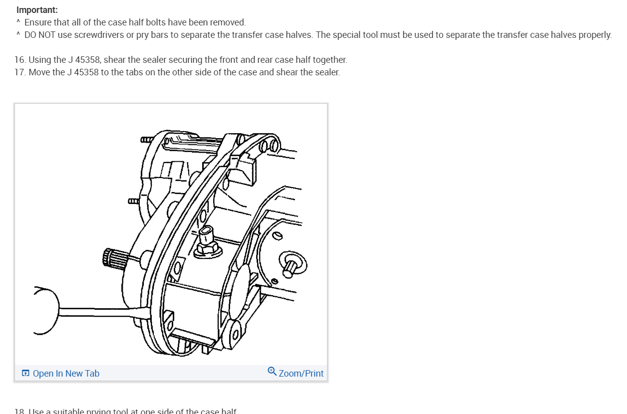

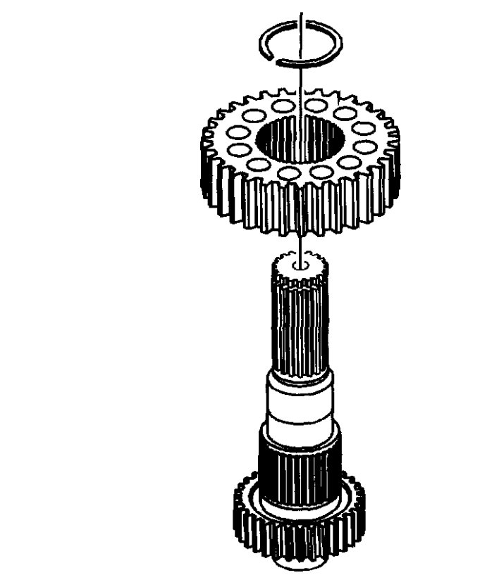

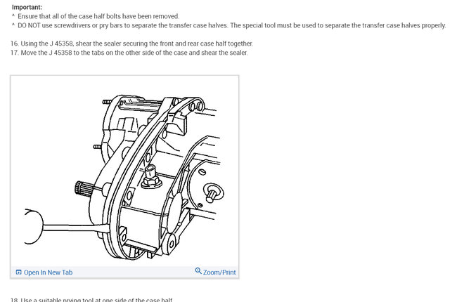

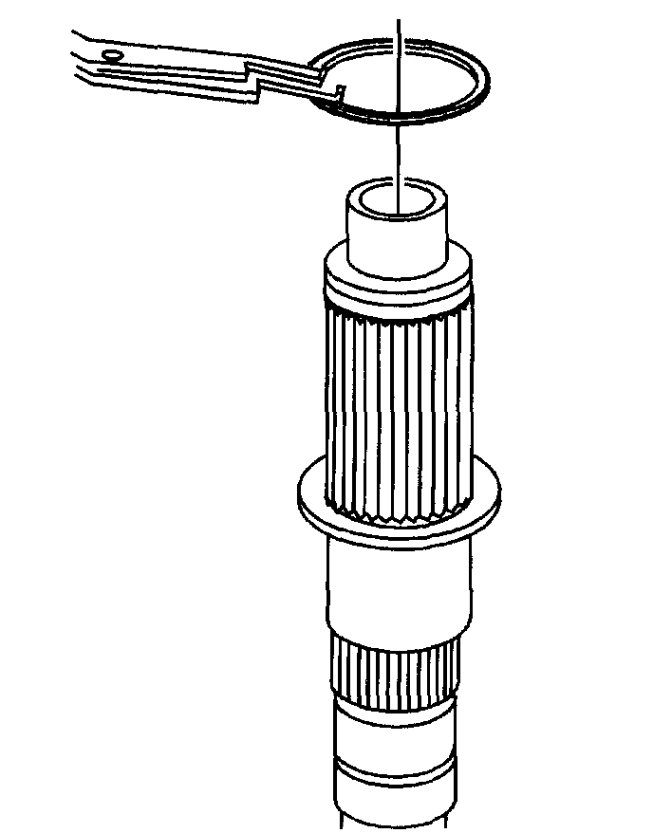

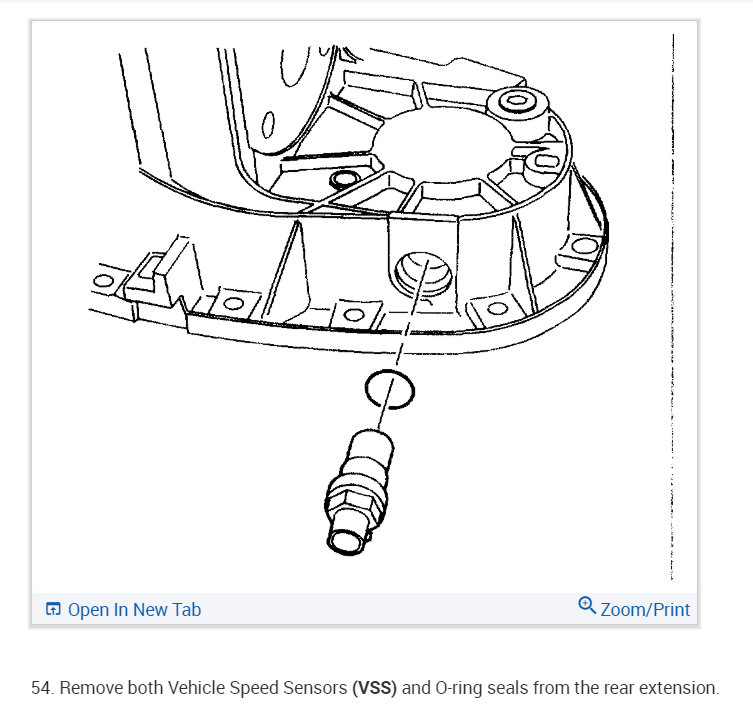

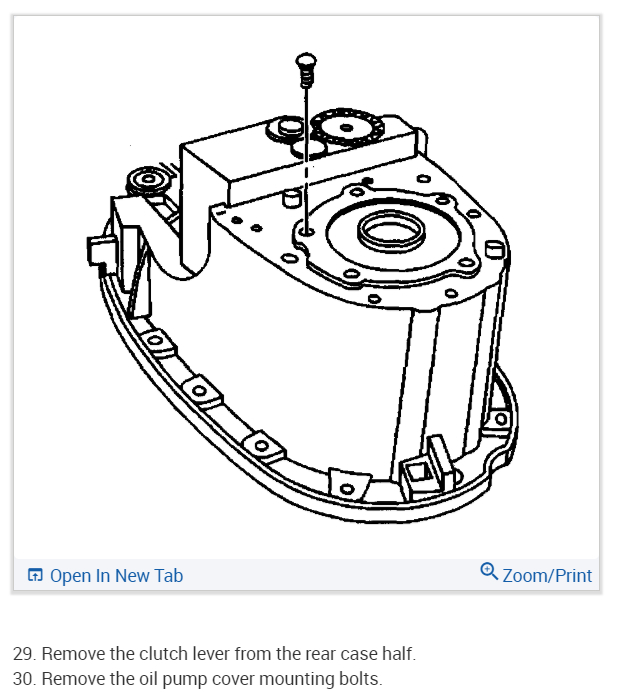

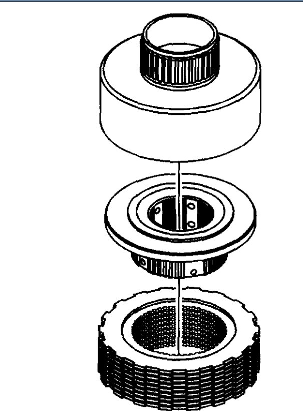

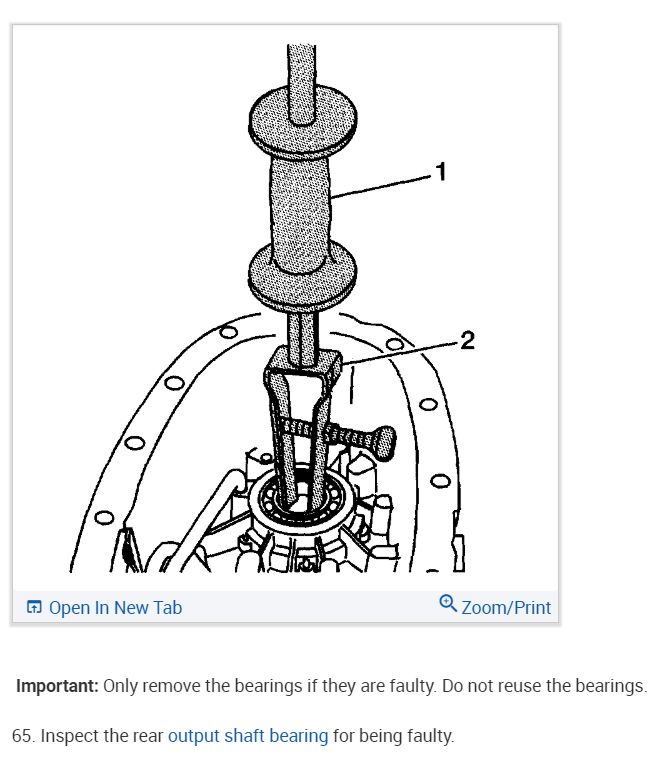

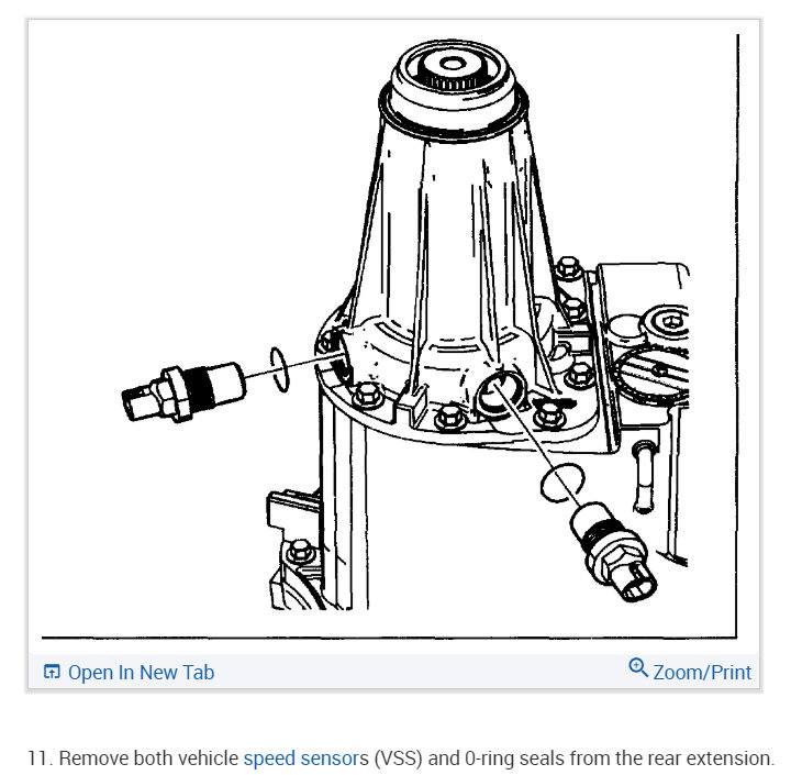

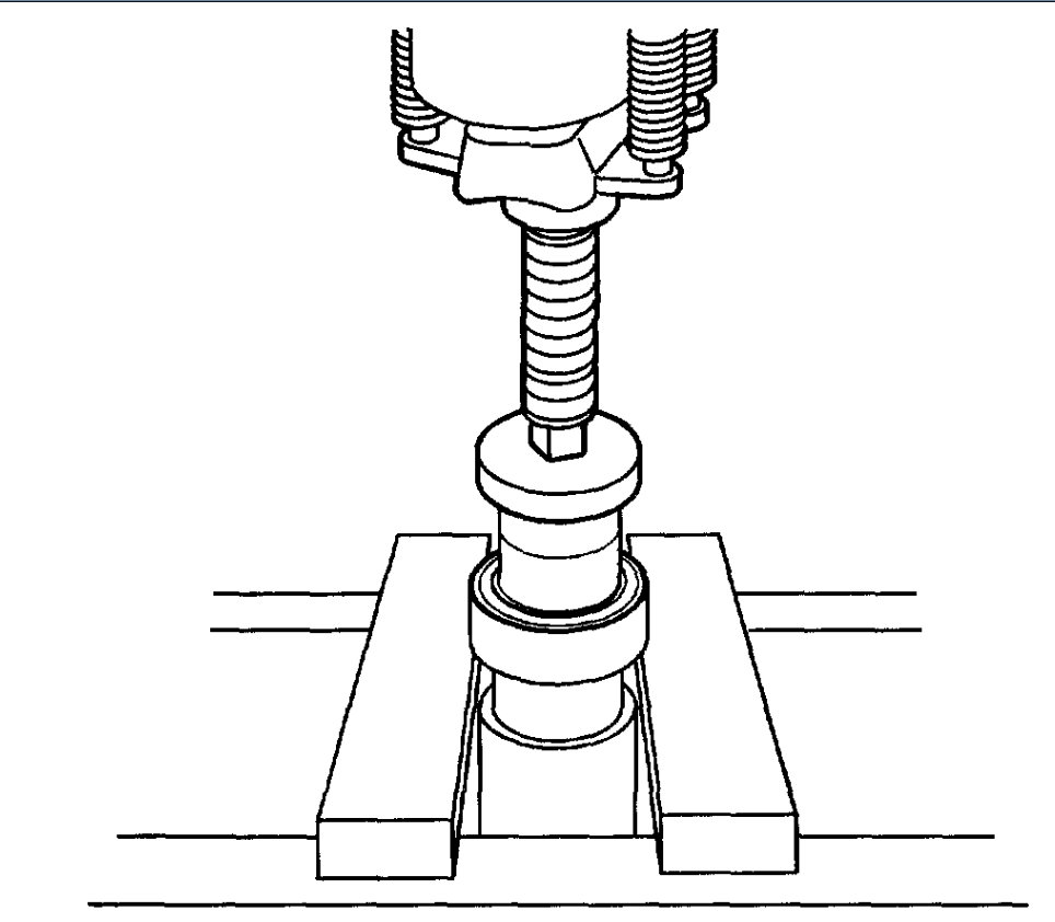

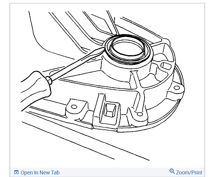

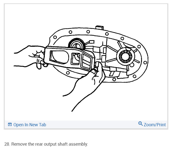

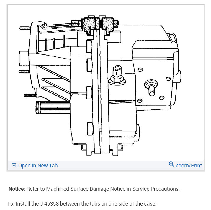

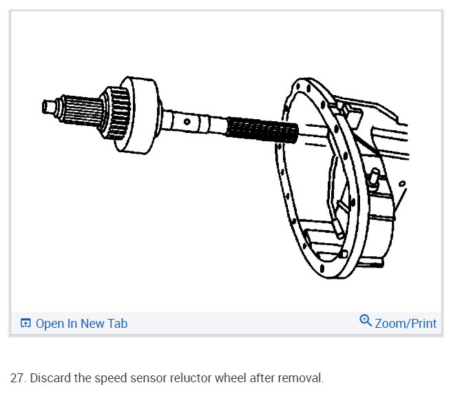

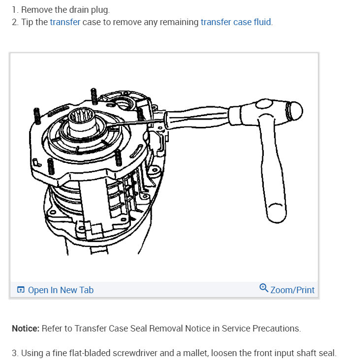

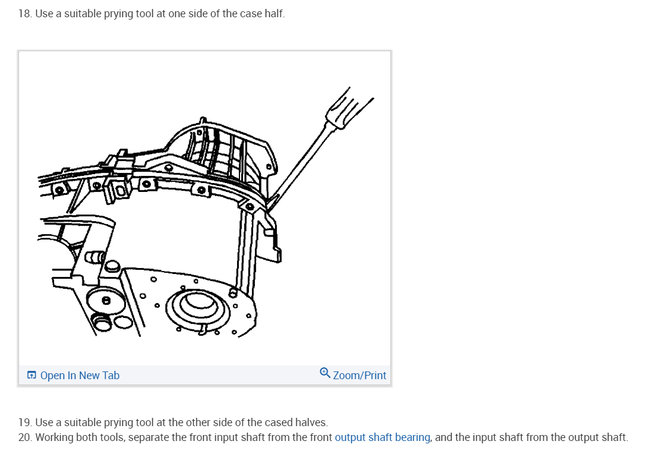

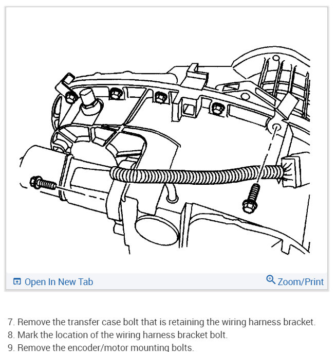

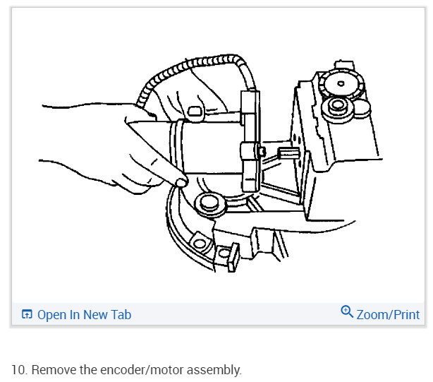

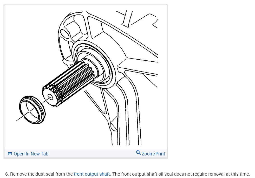

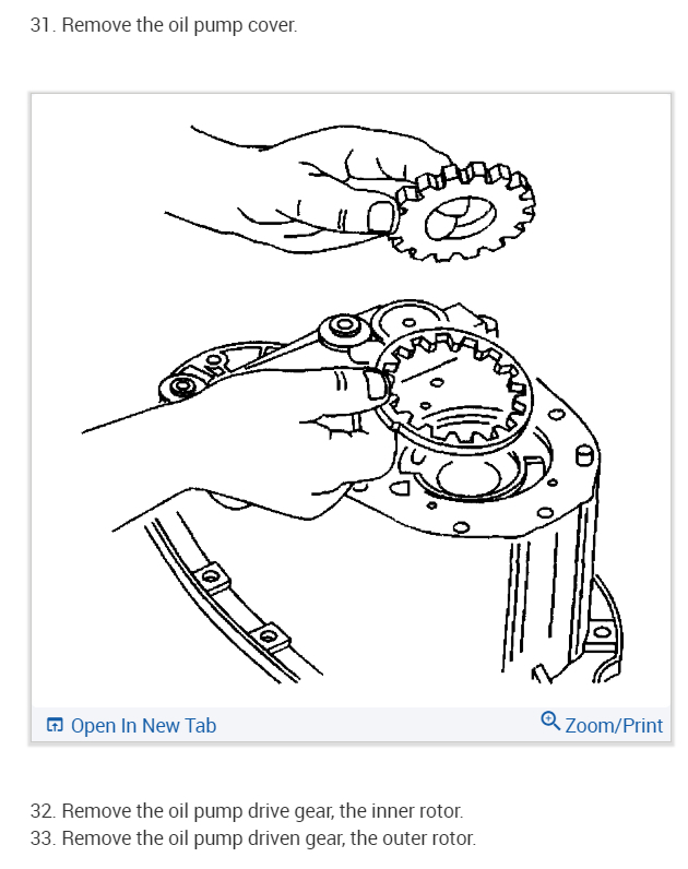

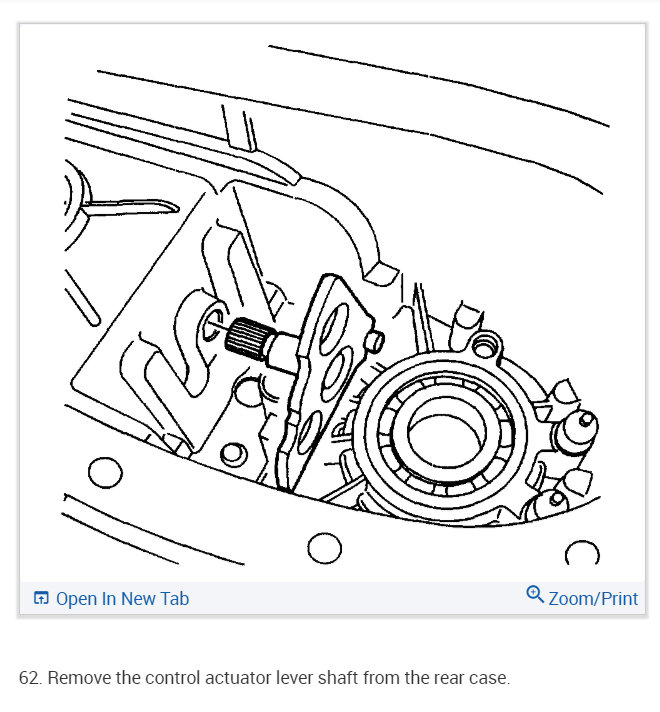

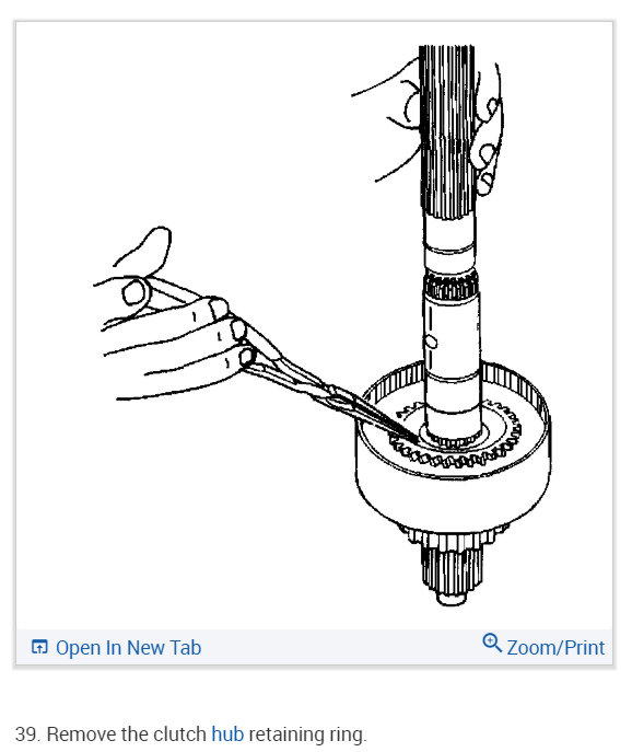

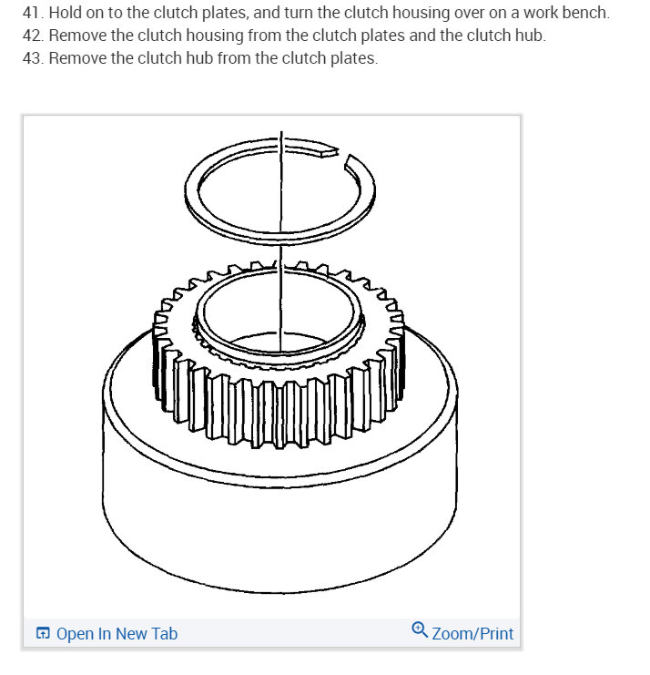

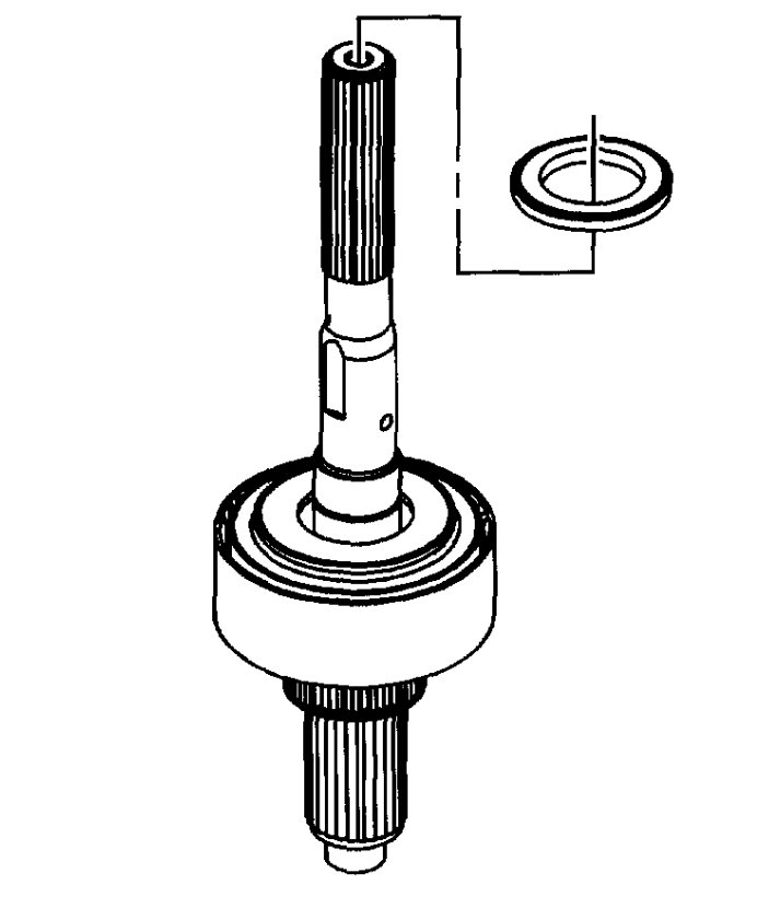

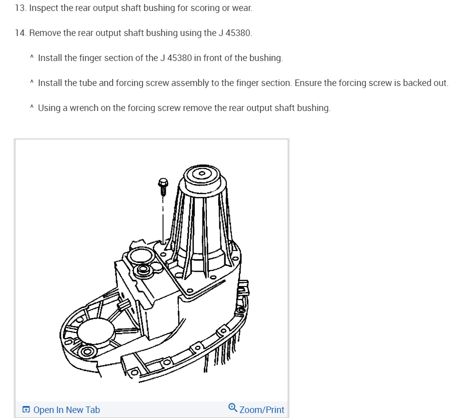

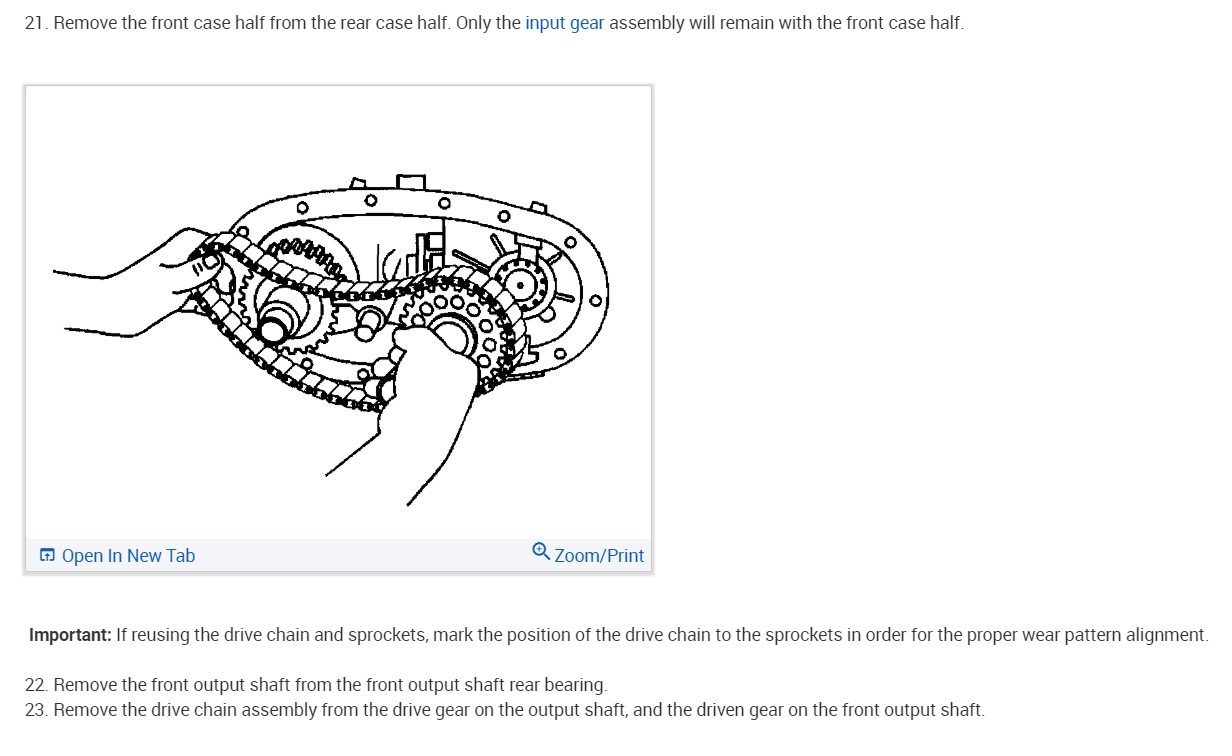

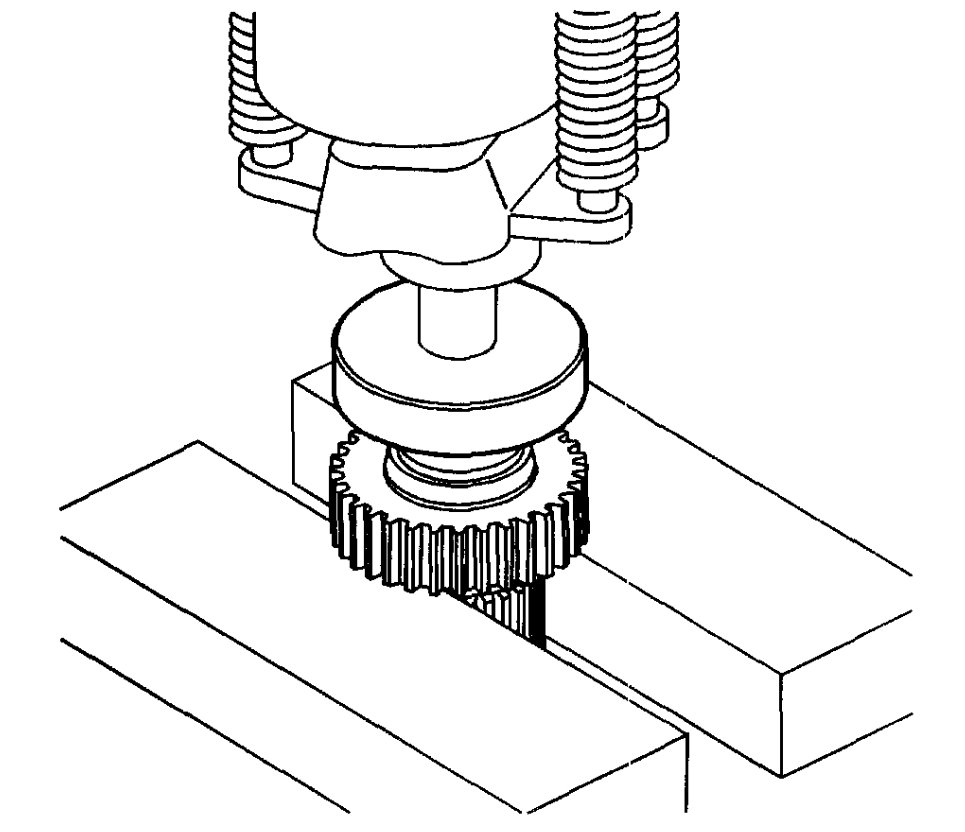

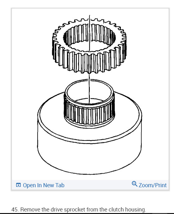

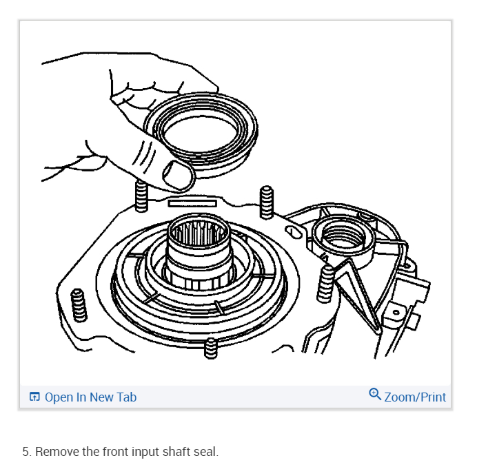

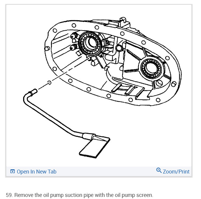

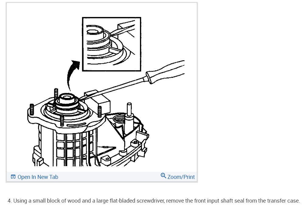

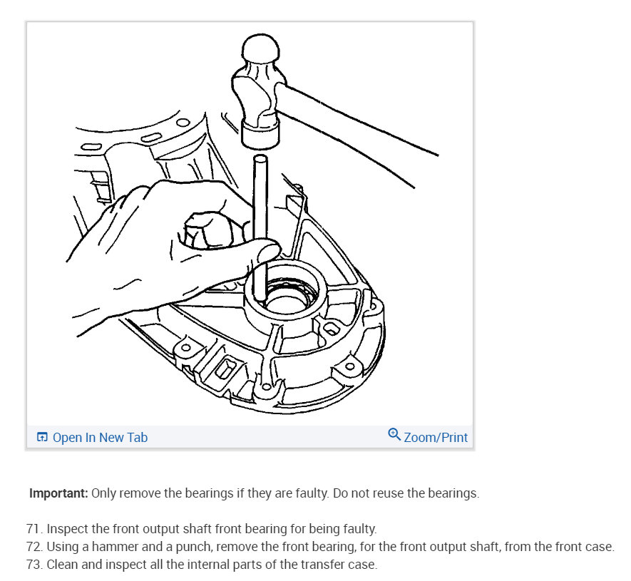

It sounds like something broke. can you confirm the front driveshaft turns? Here is an exploded view of the transfer case. Check the encoder it might not be working right. If everything looks okay here is how you rebuild the transfer case the instruction and diagrams are below. Check out the diagrams (below). Please let us know what you find. We are interested to see what it is.
MAINTENANCE
Front drive shaft does turn, so thinking something in the front differential let go.

The truck drives okay. I can shift transfer case into 4 lo and all other ranges just fine, but only have two wheel drive. When I shift to 4 lo the truck drives in low gear just fine.
Yep, it sounds like something let go inside the transfer case, it will need to be removed and disassembled. Use the diagrams above to help take it apart to see what happened. Please upload pictures of the damaged parts once you get it apart. We are interested to see what it is.

BARNEY SMITH

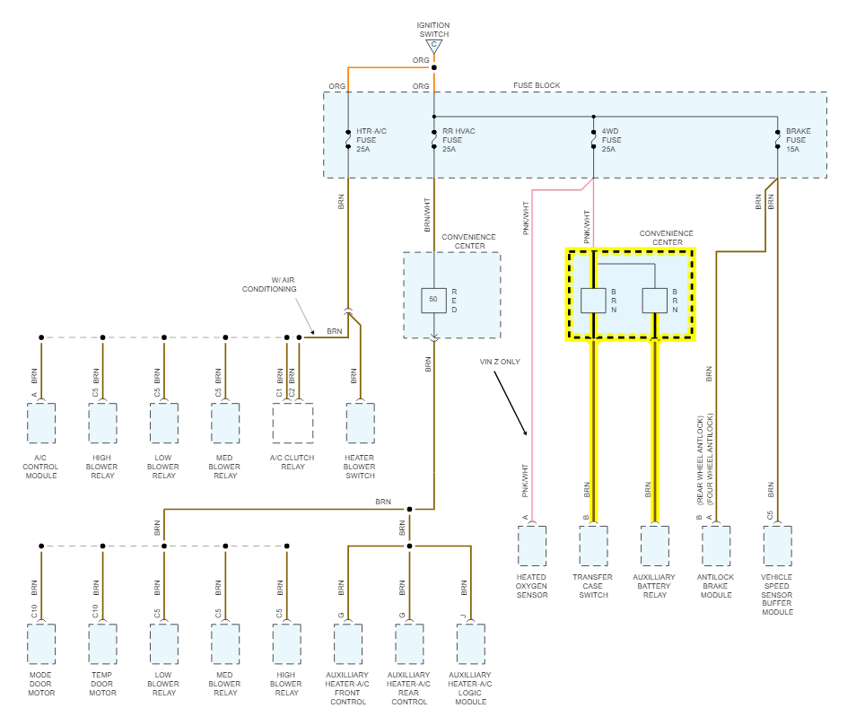

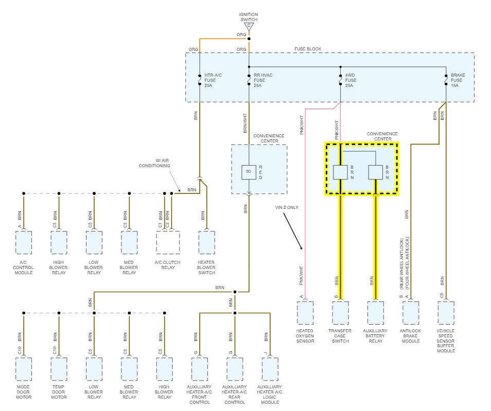

Replaced actuator and shifter switch will now go in 4 low but not 4 high. have power on 4 low wire but not on four high at the shifter switch.
Sep 2, 2020 at 10:55 AM (Merged)
I attached a portion of the wiring schematic. Are you getting power to the dark blue wire and not the light blue?
Have you checked the switch itself? If you look at pics 2 and 3, I provided the schematic for the system. If you look, power is provided via a brown wire to the transfer case switch. From there, low or high 4wd is determined. If low works, then we know power is available to the switch. If it isn't changing out of 4 low, confirm the fuse is good (indicated in pic) and power is to the switch. If you have power and 4low works properly when in 4wd, the I suspect the switch is bad.

Check to see if there is power to the 4wd actuator on the transfer case (if it is the electric shift). If it has the lever on the floor, check the linkage to the transfer case. If it is good, tight, and properly adjusted, check to make sure the actuator on the front axle is working. There is an updated actuator for these, the originals had issues
See diagram below

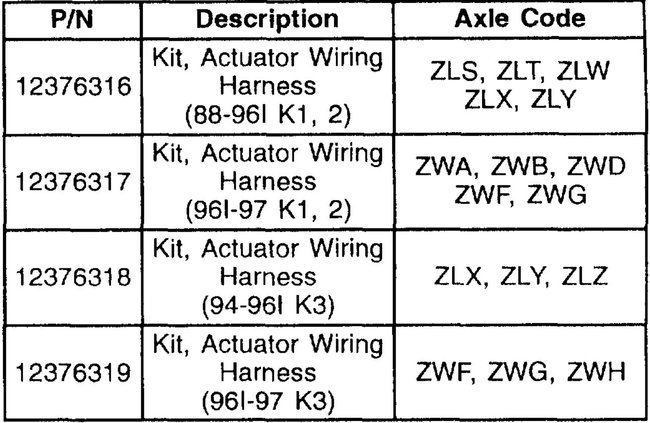

i have got a 1994 chevrolet 1500 four wheel drive pickup and have been having some problems with the four wheel drive it will not go into four wheel drive i replaced the acuator switch in it but it did not do any good it still won't go into four wheel drive checked the fuses all good and my cousin tested the wires and he is saying i am not getting any electrical current he is saying that it is a bad wire somewhere between the fuse box and the front axle the transmission is going in and my four wheel drive shaft is locking in but the four wheel drive will not go in i was wondering if you could tell me what is wrong with it
Sep 2, 2020 at 10:57 AM (Merged)
Chances are one of the wires are damaged or broken. The only thing you can do is follow the wiring to identify where the problem is located.
