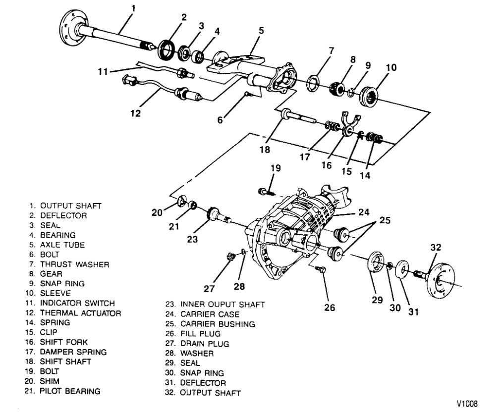

I have the same problem, but the problem is in the front differential. The actuator is working but whatever it pushes against is broken.
Jan 14, 2023 at 5:17 PM
The shift fork sounds like it is broken, check out the images below. Check out the images (below). Please let us know what happens.
