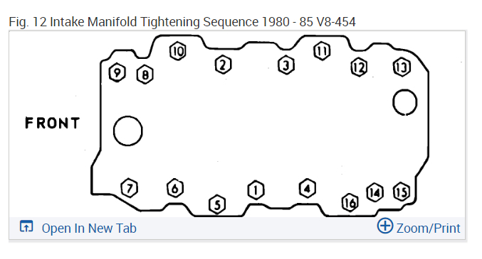

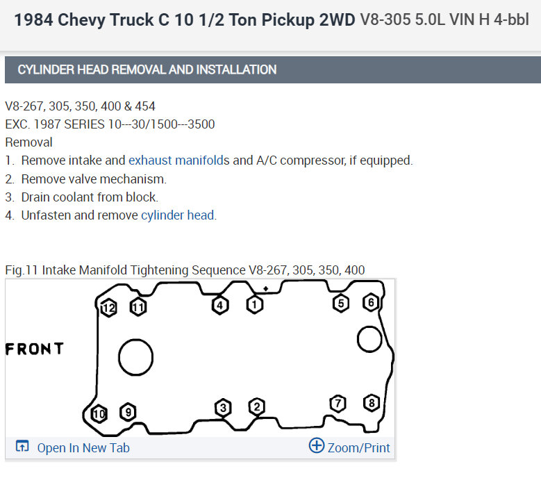

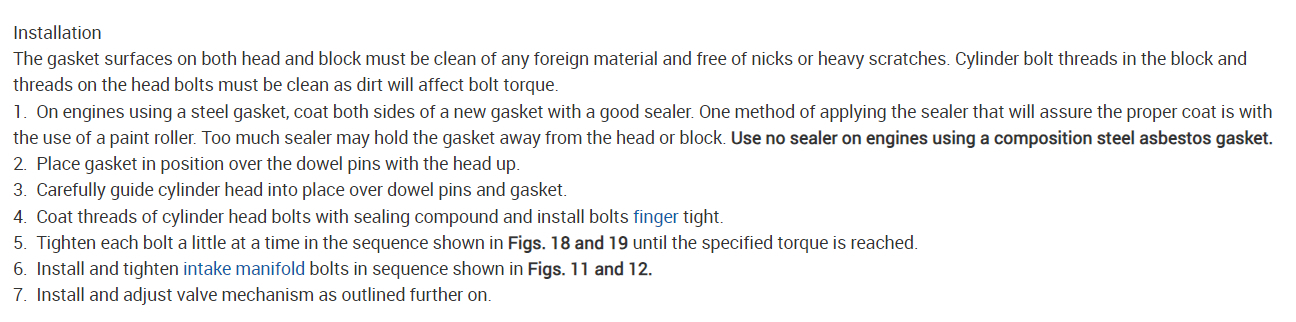

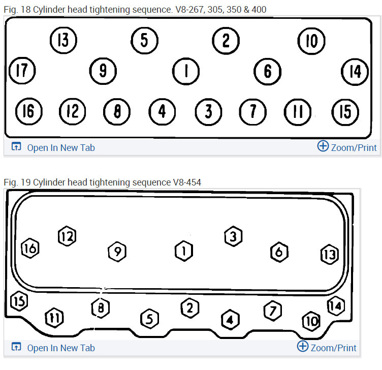

Here are the instructions and bolt tighten sequence to do the job. Check out the images (below). Let us know if you need anything else.
