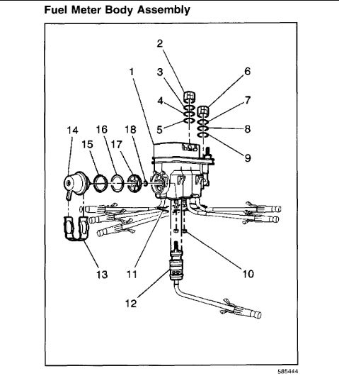

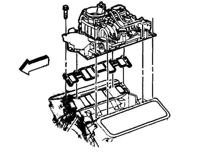

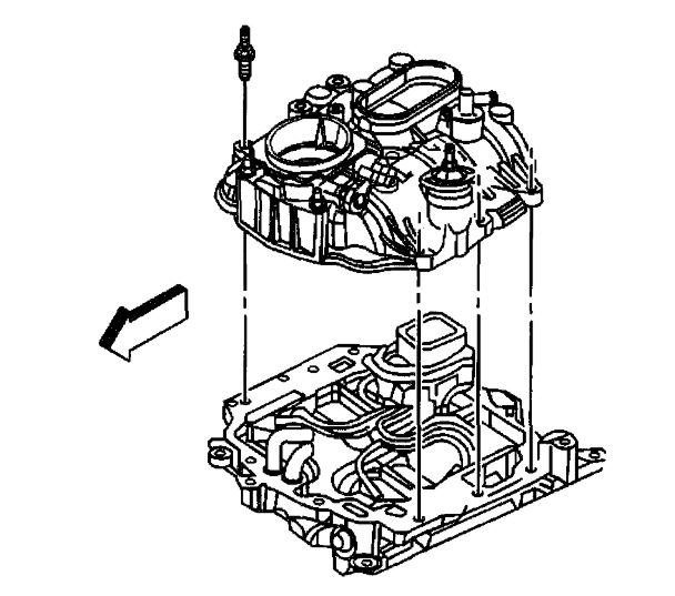

I would try this first. with the engine running, remove the oil fill cap and see if you can feel vacuum. It could be a leaking intake manifold gasket on the driver side that is leaking into the center valley.
https://www.2carpros.com/articles/replace-intake-manifold-gasket
I would verify the actual fuel pressure as well. Even though they replaced it, it still needs to be checked. It is a shame they did not replace the spider when they replaced the regulator. That is a common issue for this as well.
