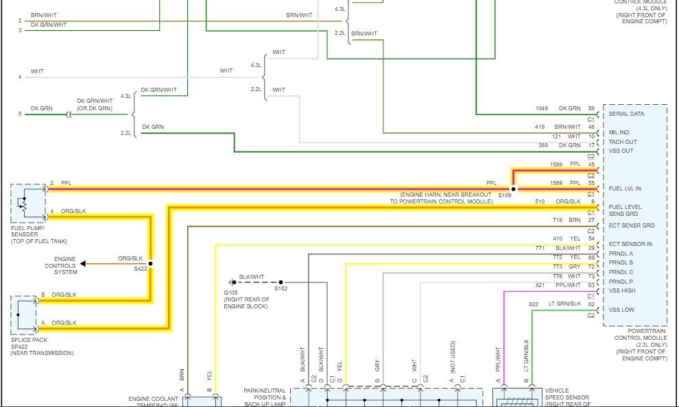

I have a 2000 s-10 4.3 with 11,500 miles on it. The fuel gauge reads inaccurate, always reading full, when it's not. It moves a little bit off full, but not accurate. Also, when i am at a stop light for more than a few seconds it buries the needle to E, once i tap the gas it goes back to full. thanks for the help.
