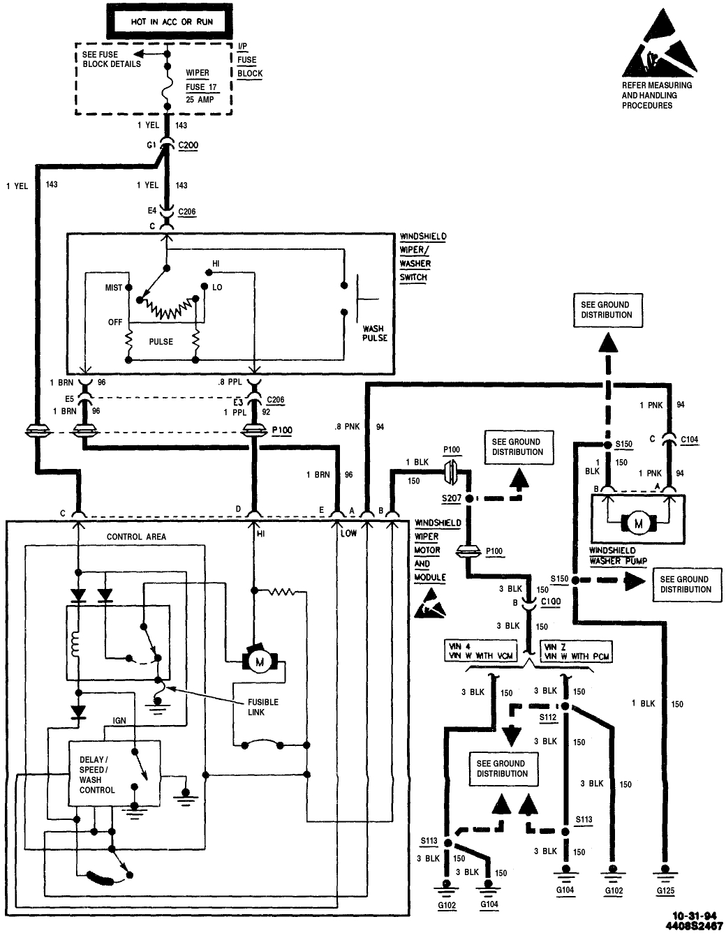

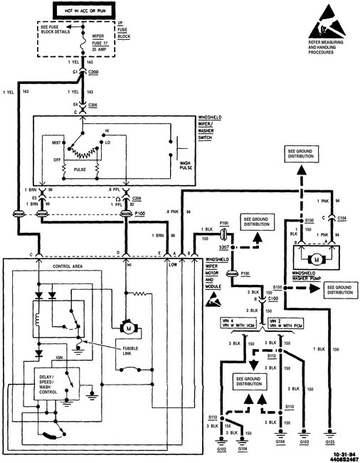

I need to know the schematic or connector wires configuration for the wiper motor connector. I want to hot wire the motor because there is a problem in the wiring from the lever switch, thanks.
Lance
Mar 29, 2019 at 2:21 PM (Merged)
JIS001
  • 3,412 POSTS
There you go. The wiper motor module seems to fail on this vehicle often. Check out the diagrams (Below). Please let us know if you need anything else to get the problem fixed.
