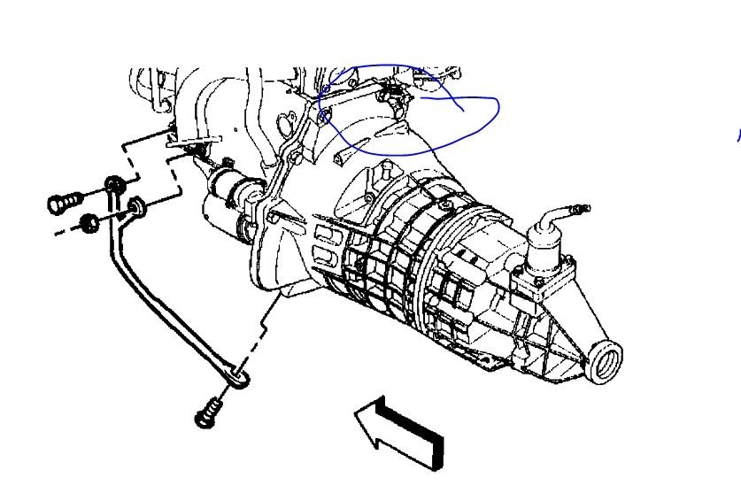

Good evening,
You need to check the ground wires at the bell housing. There are 6 bolts that attach the bell housing to the engine. The top bolts usually have a ground wire attached to one of the bolts. That is for the power train system and will shut off spark and fuel.
