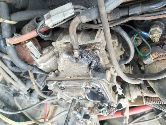

BKM97423
  • 49 POSTS
I let a friend look at my engine and he said a vacuum line was disconnected. It fixed the choke problem as it was a cold start in the mornings and the choke would never idle down. But when I get on the hwy and try to accelerate it's like I am letting off the gas and it will not over 30-40 mph and it surges causing it to jerk back and forth real bad. Sometimes when I let it cool down and drive it again it does not do it, but it seems to have gotten worse. I think this guy sabotaged my vehicle. I have had it for about 9 months and never had any problems until he messed with it. Please help me. Can you send me a diagram of vacuum lines in a 83 S10 Blazer 4wd 2.8 LTR engine 5 speed manual transmission? thanks
Dec 14, 2020 at 9:36 AM (Merged)

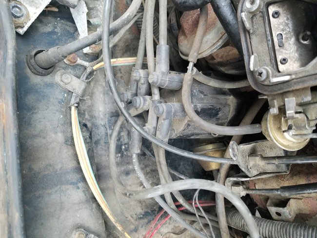

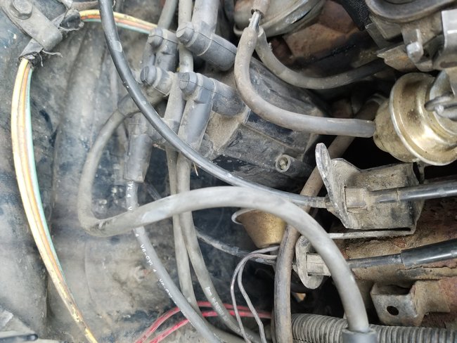

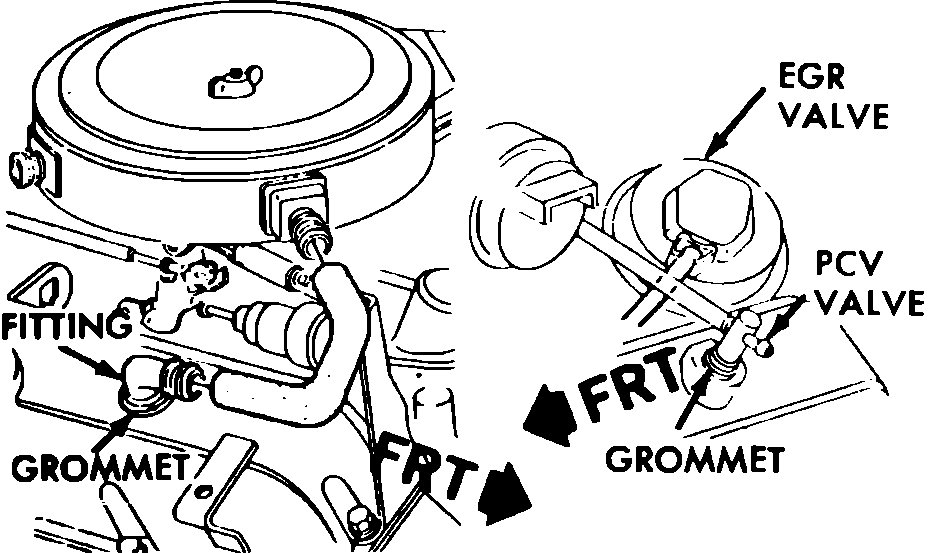

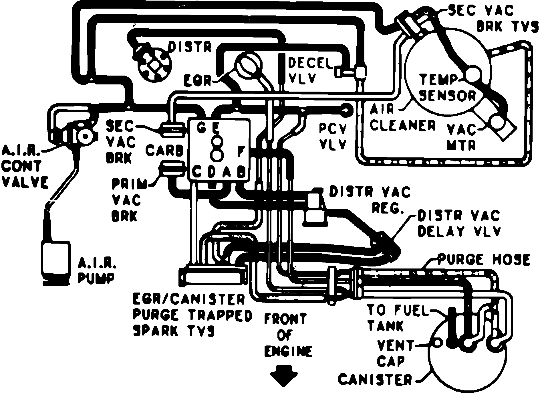

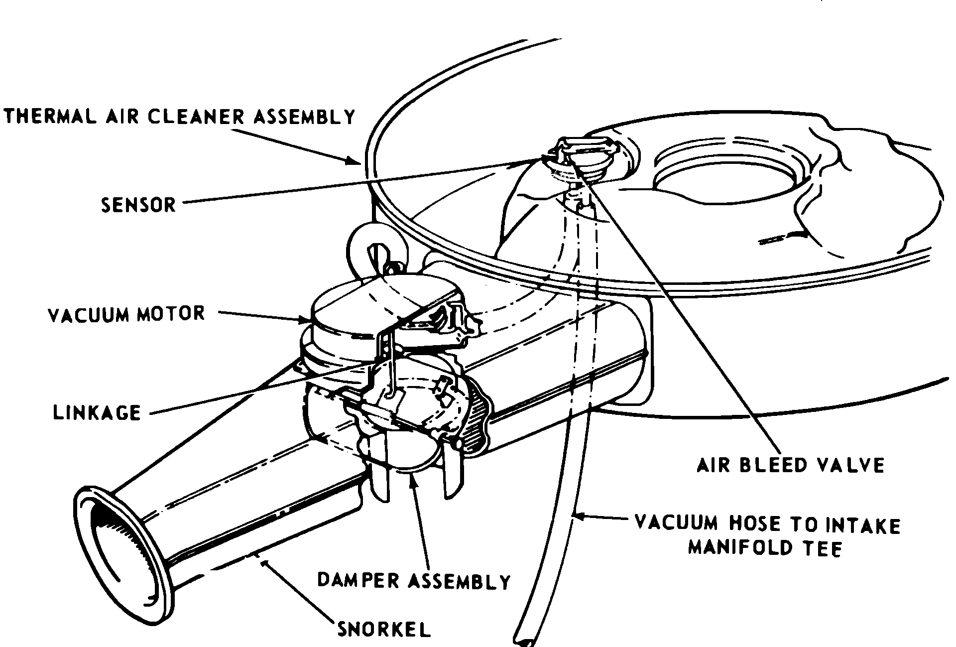

Welcome to 2CarPros.
I attached 3 pictures below of the vacuum system. They are for federal emissions. California is different, so if that is where you are located, let me know.
Now, when the engine is warm, remove the top of the air filter housing. Is the choke open or closed? Also, some of these had a vacuum pull off for the choke, I need to see yours to know if it does. If you can upload a pic of it, that would help me.
Last, confirm that the vacuum advance on the distributor isn't disconnected.
Let me know if any of this helps and what you find.
BKM97423
  • 49 POSTS
I don't know where any of that stuff your asking me about is, but I took some pictures fr you. I push on the gas and it just wont go. No power at all.
There are several of the vacuum hoses there. However, have you checked to see if there is a blockage in the exhaust? If it is plugged or partially plugged, you will lose power.
Take a look through these links:
https://www.2carpros.com/articles/bad-catalytic-converter-symptoms
BKM97423
  • 49 POSTS

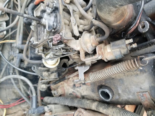

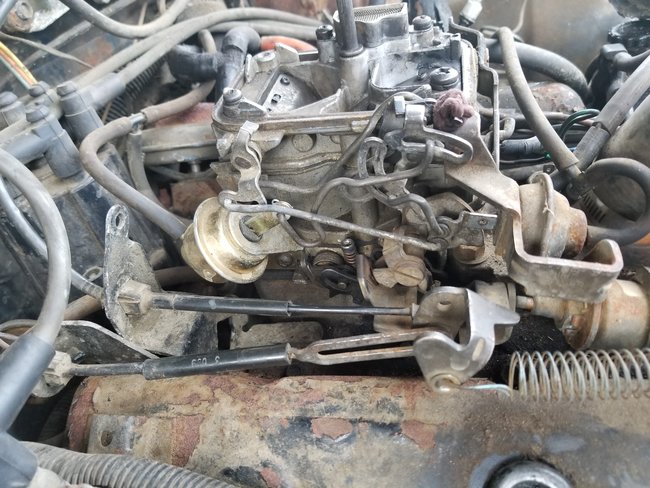

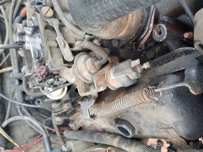

I found out it is the automatic choke. Worn parts are causing the choke plate to stay closed if I am not mistaken. A friend did some adjustments and for 2 days I thought my troubles were resolved but the first time I drove it on the hwy at a faster speed it started bucking and surging again exactly like before. I am am sending a photo of the things that aren't working right. First photo is so you can see carburetor and second one is what isn't working properly.

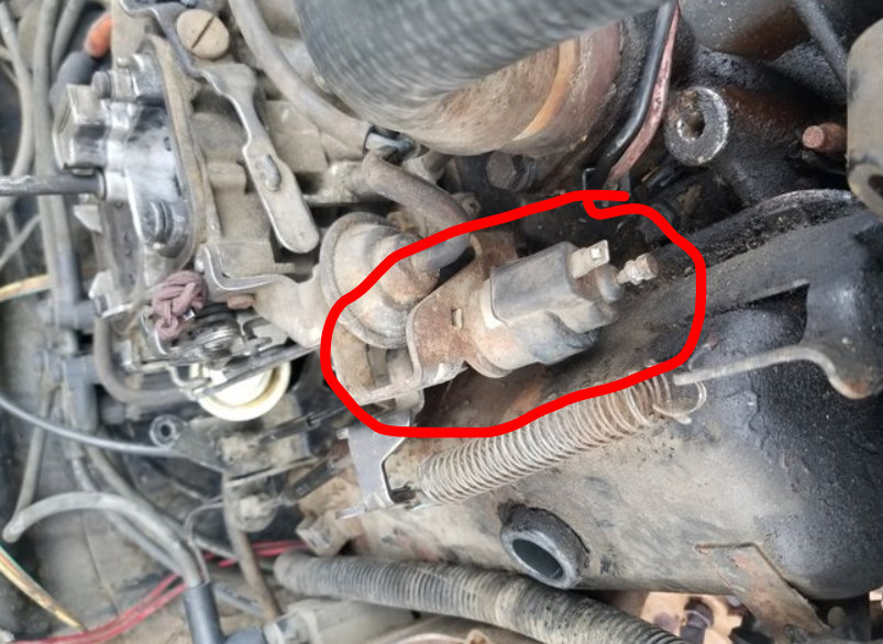

BKM97423
  • 49 POSTS
When I went to the parts store and as for an automatic choke the lady handed me a choke thermostat. I don't think that's the problem. the items that I circled in the photo are the items that are not moving when the accelerator is pushed. those parts allow though choke plate to open and close and when I accelerate. those parts don't move at all. When I move then manually they just flop around rather loosely and barley open and close the choke plate.
I looked again at the pictures you sent. The item appears to be the vacuum pull off for the choke. Do me a favor. First confirm there is a vacuum supply to them. If there is, see if the pull off holds vacuum.

BKM97423
  • 49 POSTS
Can you please tell me where the idle control screw would be located in my 1983 Chev S10 Blazer...thanks guys! Brenda Merritt
I need you to take a picture of the main throttle lever for me to see. There are different designs. Curb idle is usually controlled by the vacuum stepper. If I recall (and it's been awhile), the vacuum controller screws in and out to adjust the idle speed.

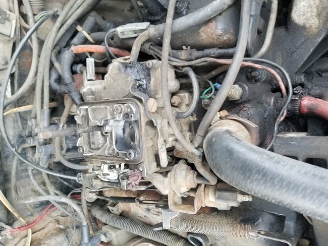

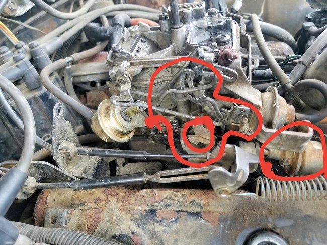

BKM97423
  • 49 POSTS
I know that there is a screw missing on a metal plate that's right by the idle adjustment screw, but i don't know what it is for. Here are the photos I have of the carburetor. Let me know if this is what you needed. The small item circled near the idle adjustment screw is where I am pretty sure a small bolt/screw is missing because there is a clip on the metal plate where the hole is to keep the screw from coming out. hope this helps Thanks, Brenda M
Hi Brenda,
I copied one of your pictures and circled what I believe to be the idle control motor. There should be a threaded bolt coming from the opposite side that pushes against the throttle lever. You should be able to extend that bolt to increase idle speed. I also noticed that there is no electrical connector attached to it. Did you just have it disconnected while working on it?
Let me know
