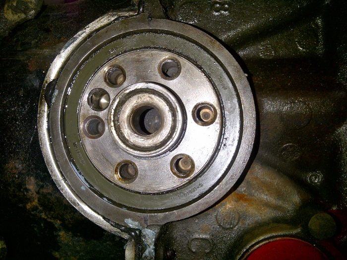

I am changing a 2.5L engine. The torque converter stub shaft inerts into a guide bushing in the crankshaft. The replacement engine bushing is smaller than the orginal and I need to remove and swap them. How do I remove them?
Aug 21, 2011 at 8:24 PM
RASMATAZ
  • 75,992 POSTS
Pack it with grease and select the correct shaft to pound it out or get a puller
Aug 21, 2011 at 8:37 PM
HMAC300
  • 48,601 POSTS
they also may have a a pilot bushing puller at an auto parts store that uses a slide hammer and puller jaws
