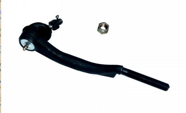

These tie rod ends have zerk fittings so that you can add grease at each oil change. Basically if you do it at each oil change then you only need to give it about 2 pumps of grease and it will be just fine.
Just make sure you don't give it so much that it comes out of the boot. This will cause dirt and water to get into the boot and damage the tie rod.
Here is a guide that will help with replacing the tie rod replacements if this is required:
https://www.2carpros.com/articles/tie-rod-end-replacement
Please see the picture below of the tie rod replacements for more info on the fitting.
Please let us know what questions you have and we can go from there. Thanks
