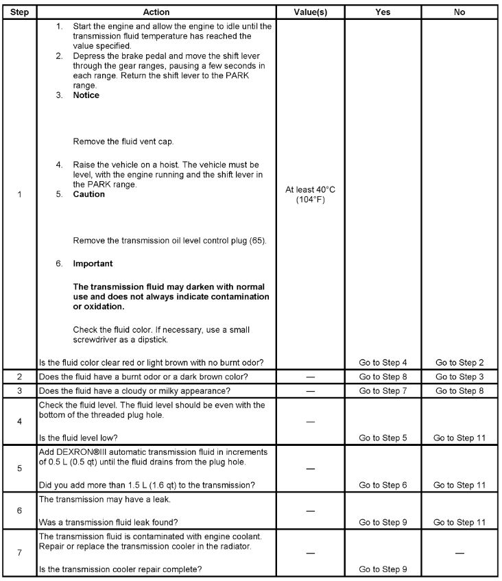

I have chevrolet Epica 2005; I want to change gearbox oil with filter. The man problem there is no transmission fluid level checker on the top so how i can add the new oil and what is recommended oil type for this car.
Oct 31, 2008 at 12:11 PM

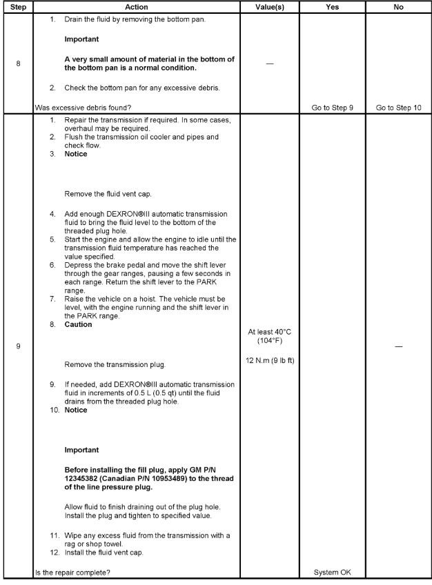

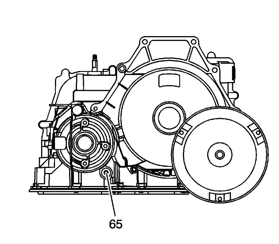

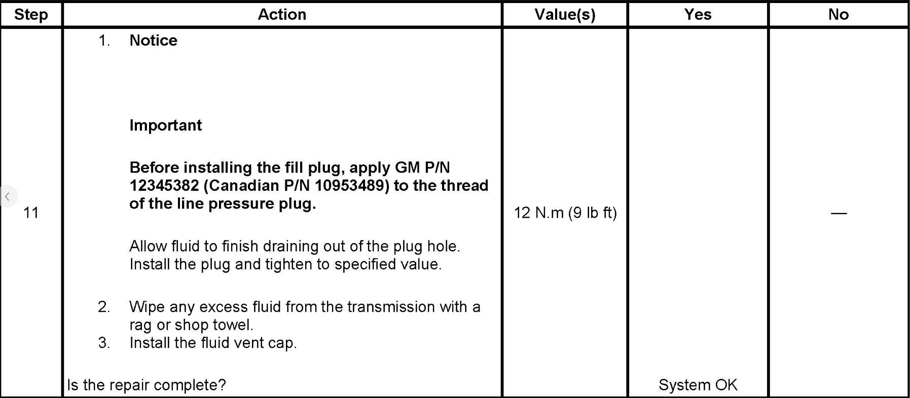

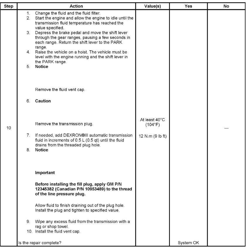

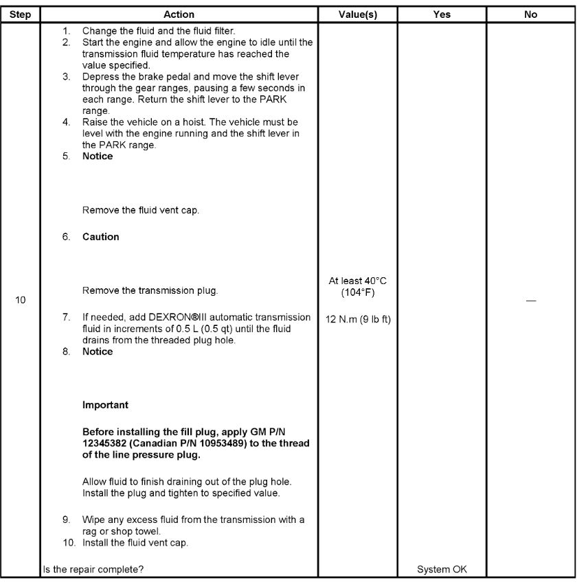

Hi: As far as the fill, there should be a rubber plug where the filler tube once was. Remove it and fill through there. As far as oil type, Most 05 GM products use Dexron III
See attachments below
