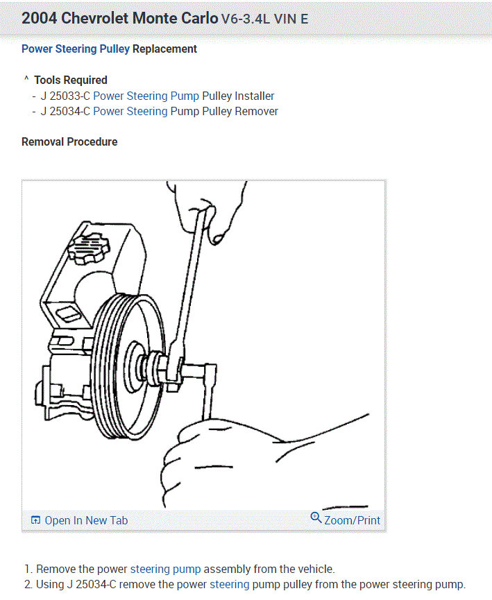

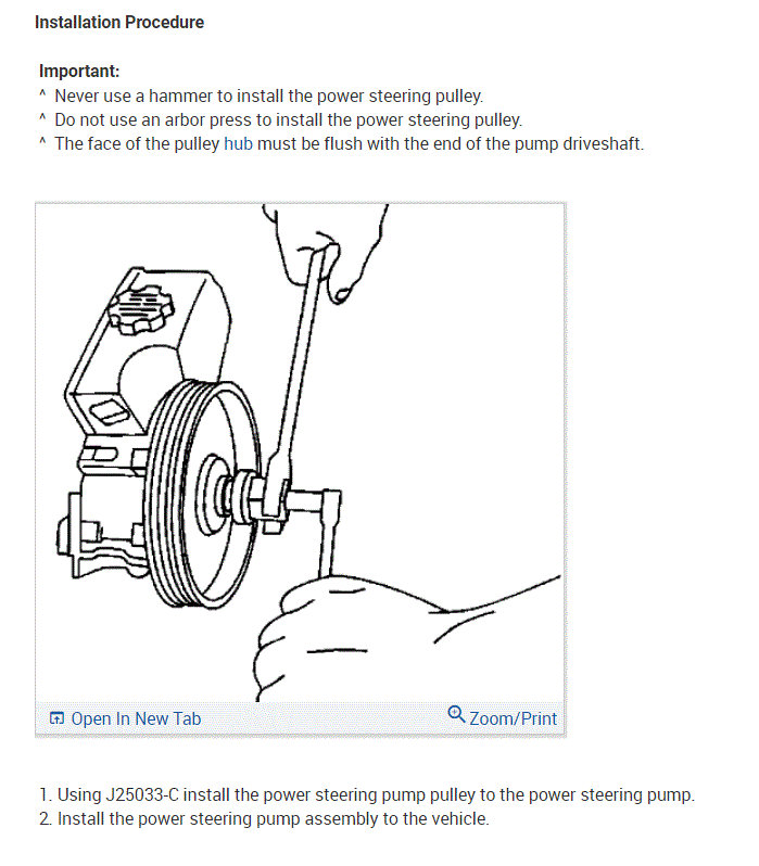

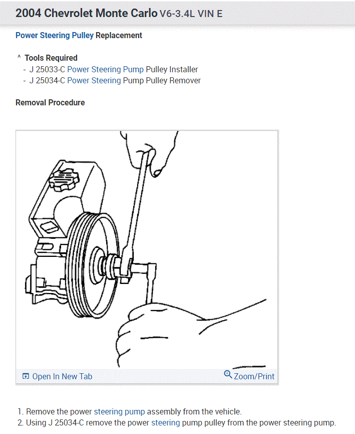

One other issue is you will need to remove the power steering pump pulley and then reinstall it on the new pump. Here is a link that shows how that is done. You will need a special tool, but most parts stores will lend one to you.
https://www.2carpros.com/articles/remove-reinstall-power-steering-pulley

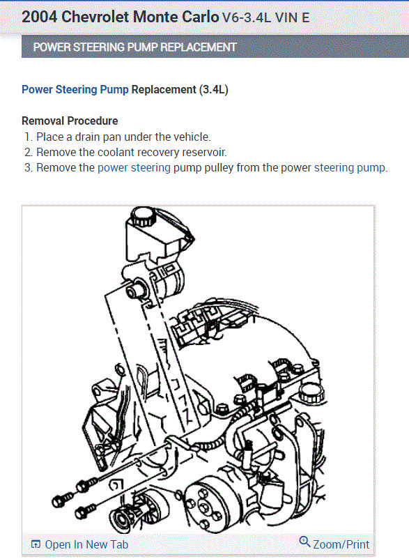

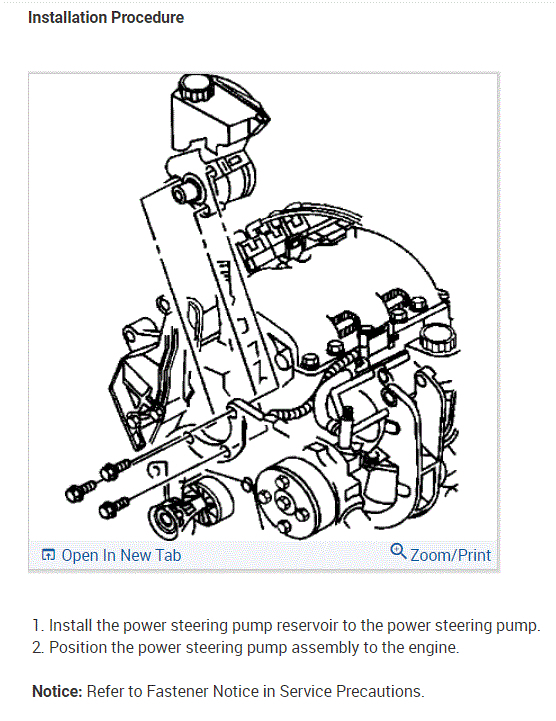

To get you started, here is a link that shows in general how to replace the pump. Review this before starting and then you can use it as a general guide.
https://www.2carpros.com/articles/how-to-replace-a-power-steering-pump

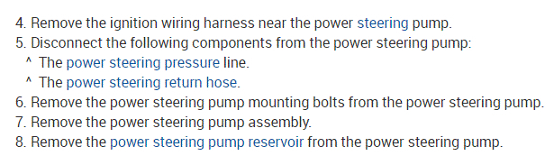

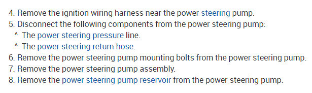

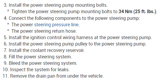

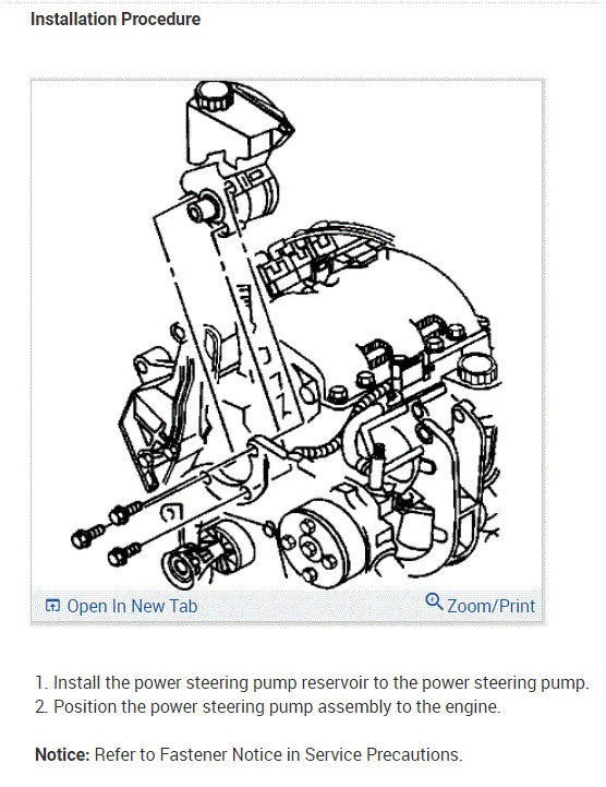

If you look at the attachments below, they provide the directions specific to your vehicle for the removal and replacement of the pump.
I hope this helps. Let me know if you have other questions.
See pics below.
