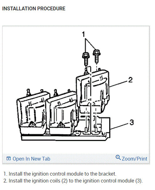

The check engine light is on in my car. It is usually on steady but when I accelerate it will usually start flashing. The car idles rough, and hesitates and stumbles when I accelerate. I checked it with a timing light and it showed the #3 and #6 cylinders are misfiring. I replaced the coil pack that those two cylinders link to but it did not help. Please let me know if you have any advice.

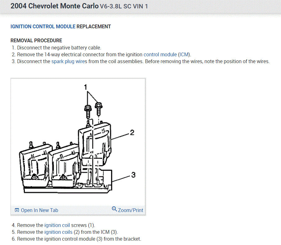

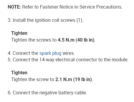

If that doesn't resolve the issue, there is a chance it is related to the ignition control module (ICM). The ICM is what you attach the coils to. Remove the ICM and have it tested at a parts store. Most are able to do it and will, free of charge.
I attached the directions for the removal and replacement of the ICM below.
I hope this helps. Let me know if you have other questions.
See pics below.
