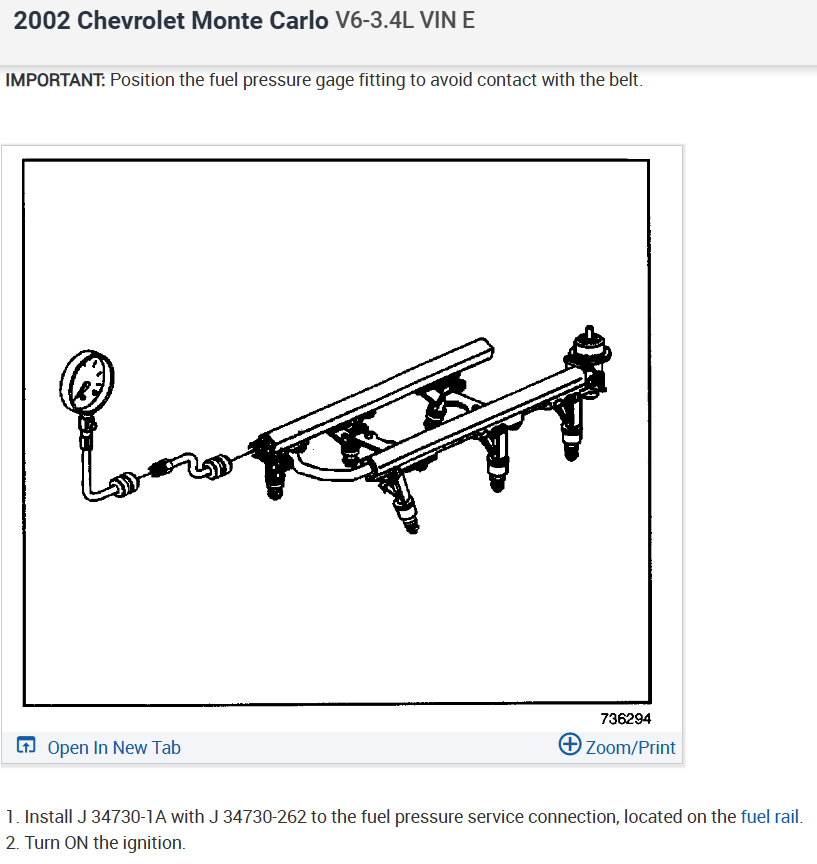

I agree with DENNYP, this sounds like a weak fuel pump issue, here is a guide to help you test the fuel pressure which you can rent the kit from the auto parts store for cheap or free.
Key On Engine Off 52-59 psi

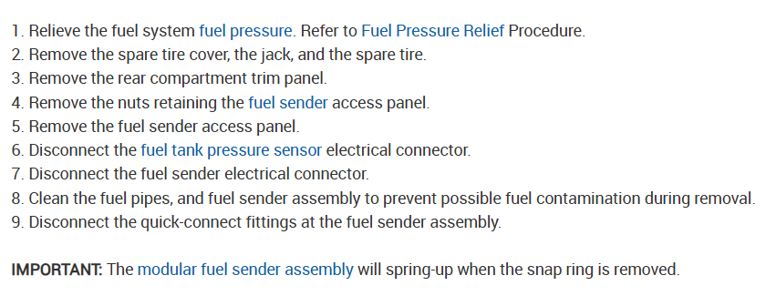

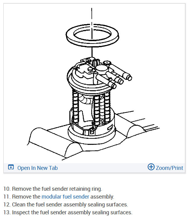

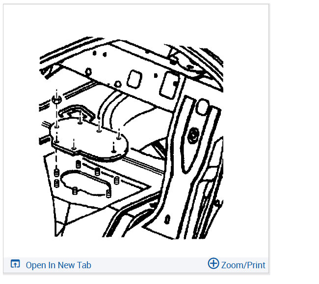

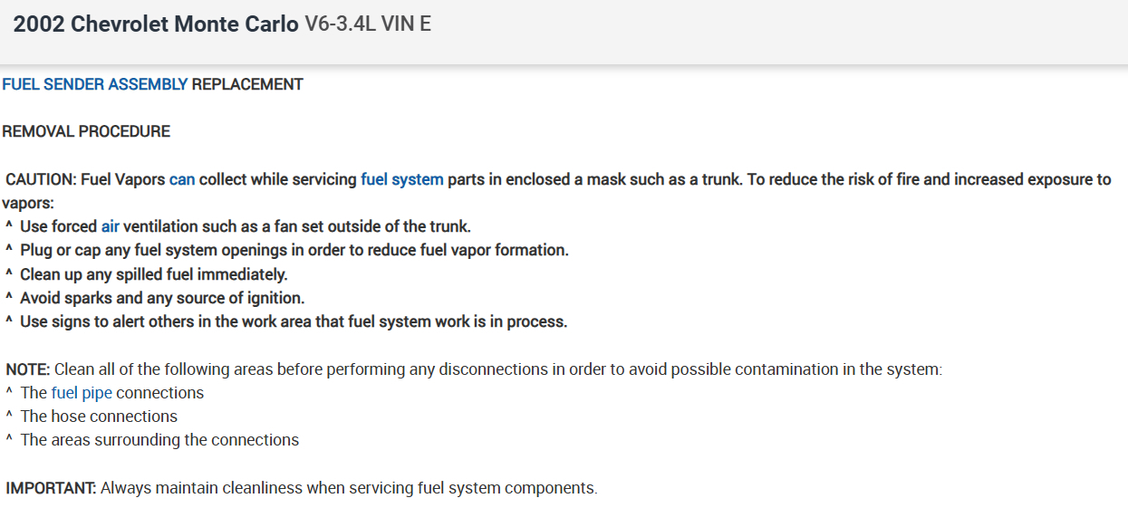

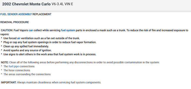

Here is how to do the test and change the fuel pump out in case it fails the test. You are lucky because the fuel pump has a trap door. Check out the images (below). Please let us know what happens.
